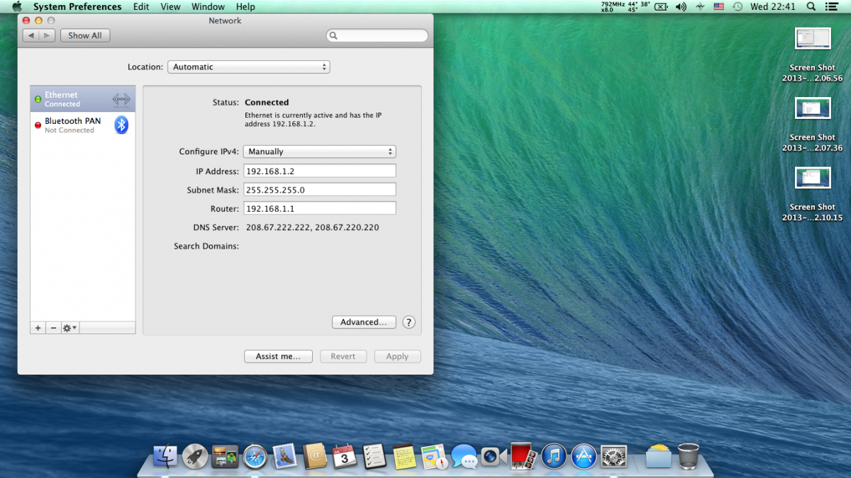

I've found a little bug in last version 2.3.4.
If Ethernet cable is unplugged before swithcing on.
I see this image
If cable  stick into and take out. I see red light as it should be.
Share this post
Link to post

Thank you the bug with yellow light was solved. If you have extra ideas how to improve the driver else we will be glad to try it.
Now driver works good! :)

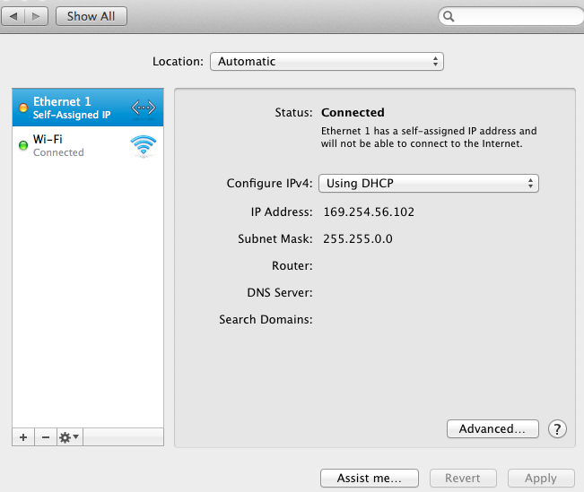

I see. I've tried my working patched AppleBCM5701Ethernet.kext from 10.8.4 with no success in DP 10.9. Any suggestions?
You'll have to patch AppleBCM5701Ethernet.kext from 10.9. Of course this will result in that ugly signature verification failure error message (what a word!).

it doesn't work. Ethernet shows connected locally (yellow), and by manually setting (even if it shows connected - green) doesn't work either.
How can I do that?
Try to take out and stick into Ethernet cable and recreate Ethernet service(press on minus after plus).
By the way. AppleBCM5701 can stop offen  and not to work after sleep. I bumped into it some time.

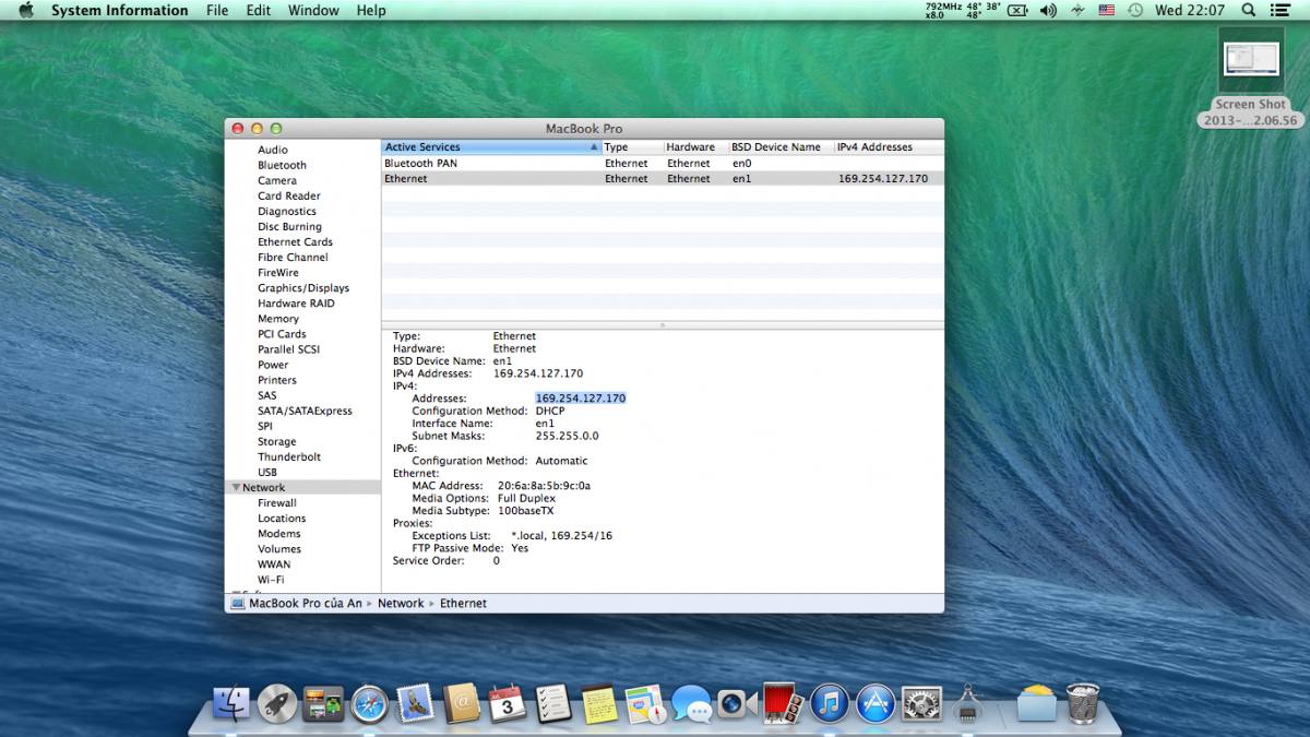

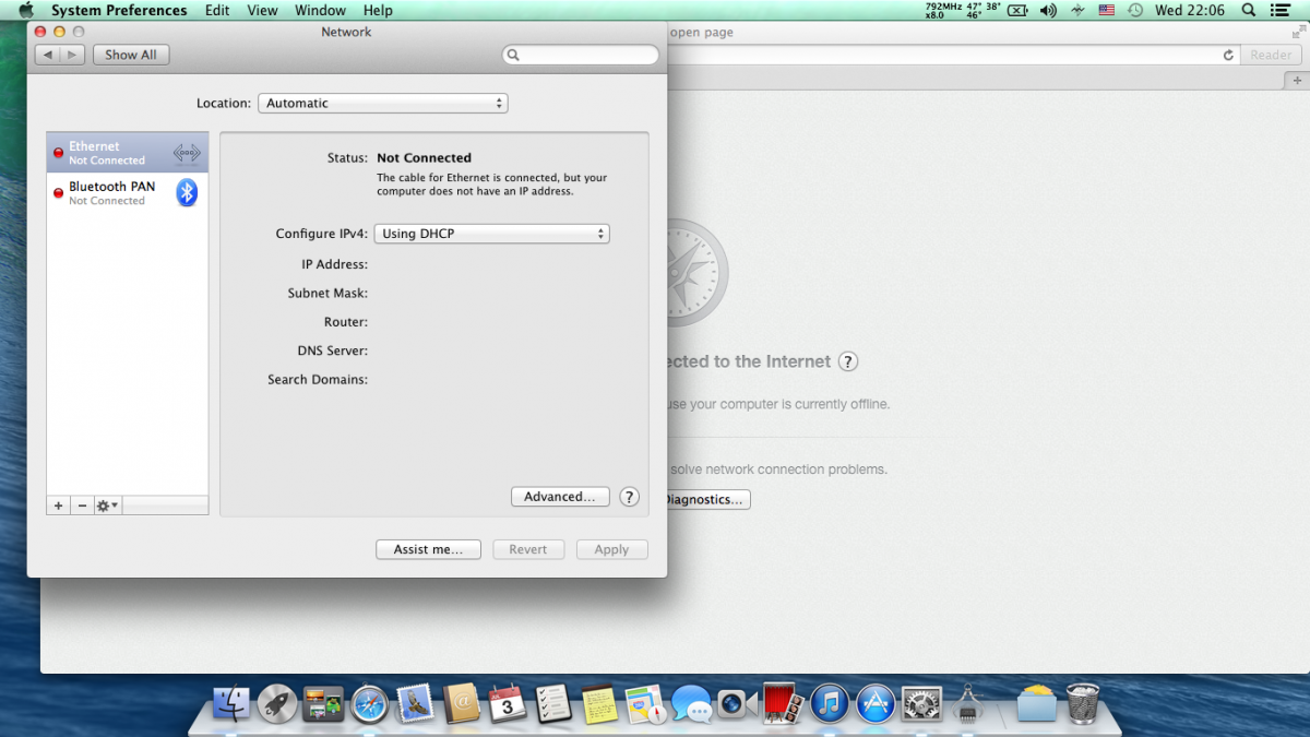

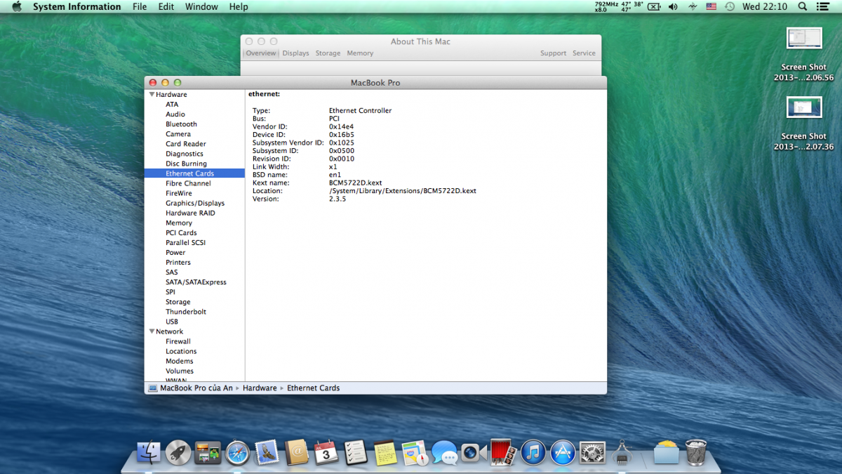

Hi. Thanks for writing a kext for my BCM 57785 ethernet card. I'm using 10.9 DP1 and I've just tested your kext BCM57722D 2.3.5 for Mavericks. The system released my card but it doesn't work. I try to use my settings on 10.8 but there's still no luck. My problem shows in these pictures. Could you fix that? I really appreciate it :)

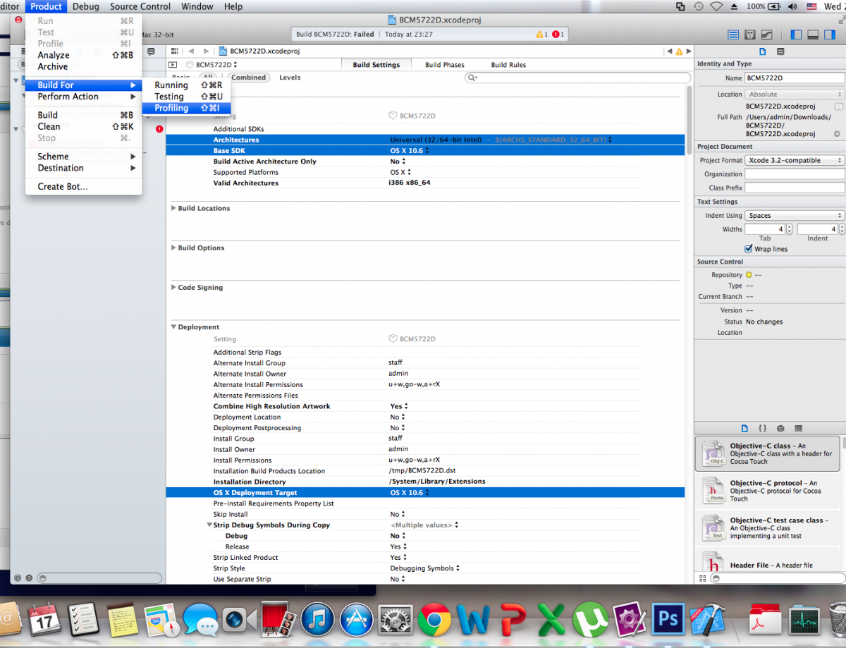

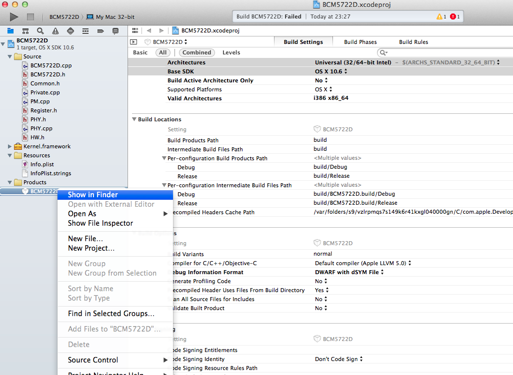

I afraid I cannot compile any 32-bit drivers at Mavericks. And I have not so much time to set up Virtual Mac and Xcode. But I think you can make it on your own.
1) Download the Xcode
2) Download the project
http://www.insanelymac.com/forum/files/file/79-bcm5722d/
3) Open it. Perhaps Xcode will suggest you to update the settings. Agree with that.
4) Change  Archictures, Base SDK and OSX Development target as it is shown at the screenshot.
5) Product-> Build For->Archiving
6) Find your version here. At the folder named Release, (not Debug)
7) Attached your version here if it works
Good Huck!
Hello.
1) Does 2.3.5 work at the ML?
2) Does the old driver work at the Mavericks?
http://www.osx86.net/view/3074-bcm5722d.kext.html
