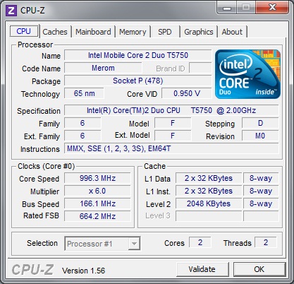

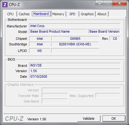

I am using a toshiba satellite laptop, and have attached screen pics of cpu-id
