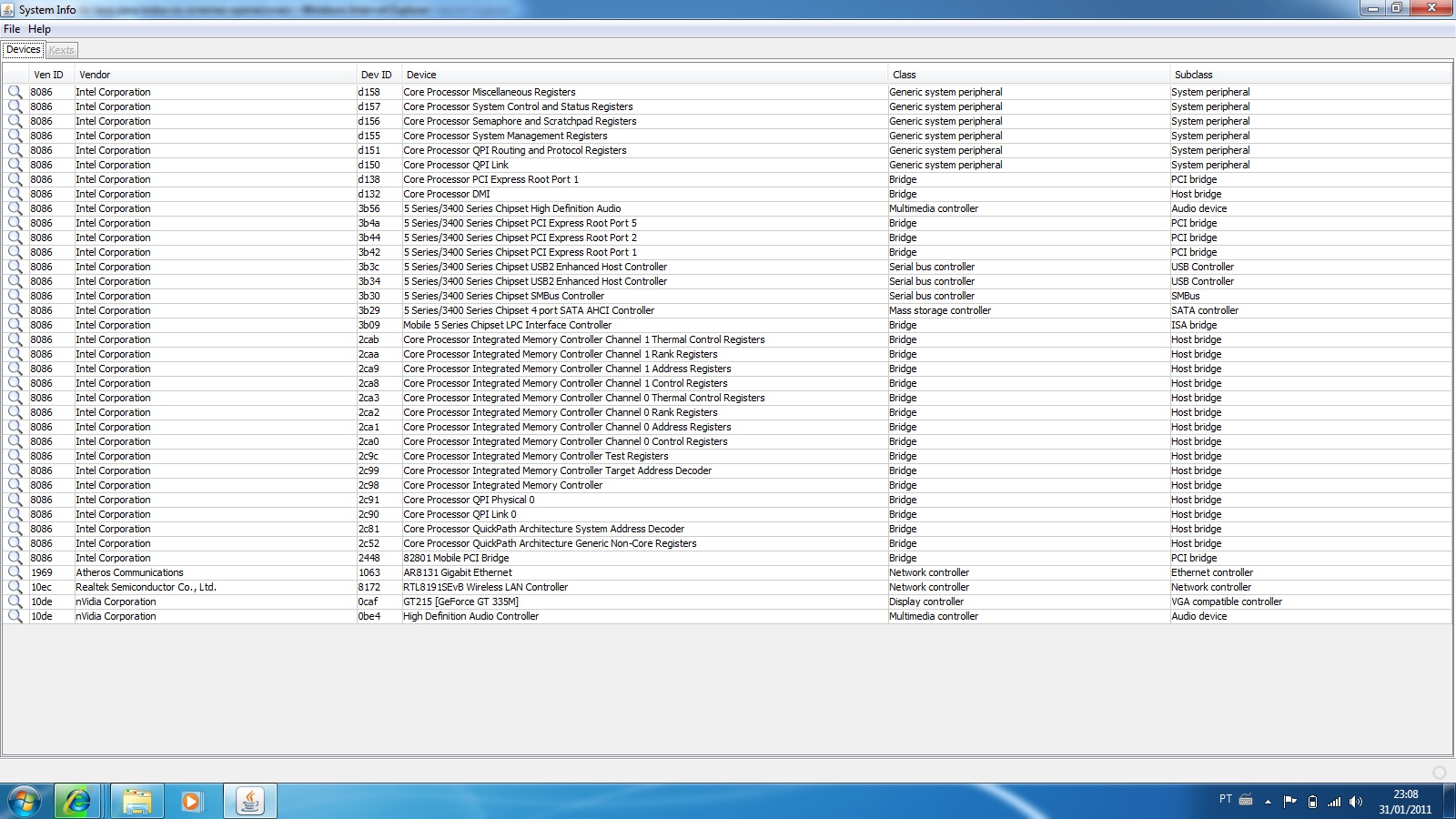

cableone Posted January 28, 2011 Share Posted January 28, 2011 Como consigo os drivers pro notebook da LG ?? Alguem pode me ajudar ? Grato Link to comment Share on other sites More sharing options...
oldnapalm Posted January 28, 2011 Share Posted January 28, 2011 Poste as especificações http://www.insanelymac.com/forum/index.php?showtopic=219582 Link to comment Share on other sites More sharing options...
cableone Posted February 1, 2011 Author Share Posted February 1, 2011 Segue especificações... 8086;Intel Corporation;d158;Core Processor Miscellaneous Registers;Generic system peripheral;System peripheral 8086;Intel Corporation;d157;Core Processor System Control and Status Registers;Generic system peripheral;System peripheral 8086;Intel Corporation;d156;Core Processor Semaphore and Scratchpad Registers;Generic system peripheral;System peripheral 8086;Intel Corporation;d155;Core Processor System Management Registers;Generic system peripheral;System peripheral 8086;Intel Corporation;d151;Core Processor QPI Routing and Protocol Registers;Generic system peripheral;System peripheral 8086;Intel Corporation;d150;Core Processor QPI Link;Generic system peripheral;System peripheral 8086;Intel Corporation;d138;Core Processor PCI Express Root Port 1;Bridge;PCI bridge 8086;Intel Corporation;d132;Core Processor DMI;Bridge;Host bridge 8086;Intel Corporation;3b56;5 Series/3400 Series Chipset High Definition Audio;Multimedia controller;Audio device 8086;Intel Corporation;3b4a;5 Series/3400 Series Chipset PCI Express Root Port 5;Bridge;PCI bridge 8086;Intel Corporation;3b44;5 Series/3400 Series Chipset PCI Express Root Port 2;Bridge;PCI bridge 8086;Intel Corporation;3b42;5 Series/3400 Series Chipset PCI Express Root Port 1;Bridge;PCI bridge 8086;Intel Corporation;3b3c;5 Series/3400 Series Chipset USB2 Enhanced Host Controller;Serial bus controller;USB Controller 8086;Intel Corporation;3b34;5 Series/3400 Series Chipset USB2 Enhanced Host Controller;Serial bus controller;USB Controller 8086;Intel Corporation;3b30;5 Series/3400 Series Chipset SMBus Controller;Serial bus controller;SMBus 8086;Intel Corporation;3b29;5 Series/3400 Series Chipset 4 port SATA AHCI Controller;Mass storage controller;SATA controller 8086;Intel Corporation;3b09;Mobile 5 Series Chipset LPC Interface Controller;Bridge;ISA bridge 8086;Intel Corporation;2cab;Core Processor Integrated Memory Controller Channel 1 Thermal Control Registers;Bridge;Host bridge 8086;Intel Corporation;2caa;Core Processor Integrated Memory Controller Channel 1 Rank Registers;Bridge;Host bridge 8086;Intel Corporation;2ca9;Core Processor Integrated Memory Controller Channel 1 Address Registers;Bridge;Host bridge 8086;Intel Corporation;2ca8;Core Processor Integrated Memory Controller Channel 1 Control Registers;Bridge;Host bridge 8086;Intel Corporation;2ca3;Core Processor Integrated Memory Controller Channel 0 Thermal Control Registers;Bridge;Host bridge 8086;Intel Corporation;2ca2;Core Processor Integrated Memory Controller Channel 0 Rank Registers;Bridge;Host bridge 8086;Intel Corporation;2ca1;Core Processor Integrated Memory Controller Channel 0 Address Registers;Bridge;Host bridge 8086;Intel Corporation;2ca0;Core Processor Integrated Memory Controller Channel 0 Control Registers;Bridge;Host bridge 8086;Intel Corporation;2c9c;Core Processor Integrated Memory Controller Test Registers;Bridge;Host bridge 8086;Intel Corporation;2c99;Core Processor Integrated Memory Controller Target Address Decoder;Bridge;Host bridge 8086;Intel Corporation;2c98;Core Processor Integrated Memory Controller;Bridge;Host bridge 8086;Intel Corporation;2c91;Core Processor QPI Physical 0;Bridge;Host bridge 8086;Intel Corporation;2c90;Core Processor QPI Link 0;Bridge;Host bridge 8086;Intel Corporation;2c81;Core Processor QuickPath Architecture System Address Decoder;Bridge;Host bridge 8086;Intel Corporation;2c52;Core Processor QuickPath Architecture Generic Non-Core Registers;Bridge;Host bridge 8086;Intel Corporation;2448;82801 Mobile PCI Bridge;Bridge;PCI bridge 1969;Atheros Communications;1063;AR8131 Gigabit Ethernet;Network controller;Ethernet controller 10ec;Realtek Semiconductor Co., Ltd.;8172;RTL8191SEvB Wireless LAN Controller;Network controller;Network controller 10de;nVidia Corporation;0caf;GT215 [GeForce GT 335M];Display controller;VGA compatible controller 10de;nVidia Corporation;0be4;High Definition Audio Controller;Multimedia controller;Audio device Link to comment Share on other sites More sharing options...
oldnapalm Posted February 1, 2011 Share Posted February 1, 2011 Áudio, vídeo, teclado e trackpad (PS/2) veja no FAQ. Ethernet: http://code.google.com/p/iats/ A wireless que eu saiba não é compatível. Link to comment Share on other sites More sharing options...
