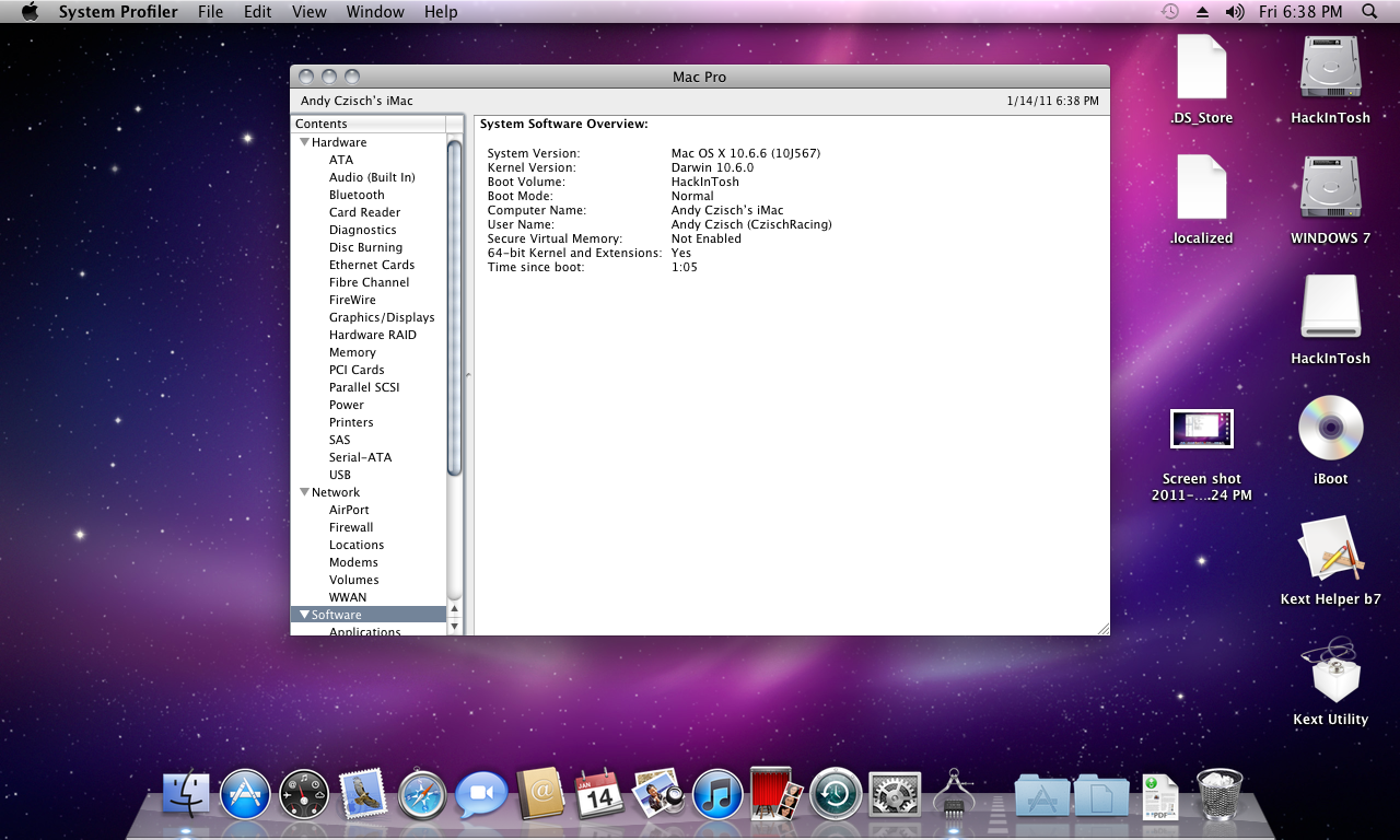

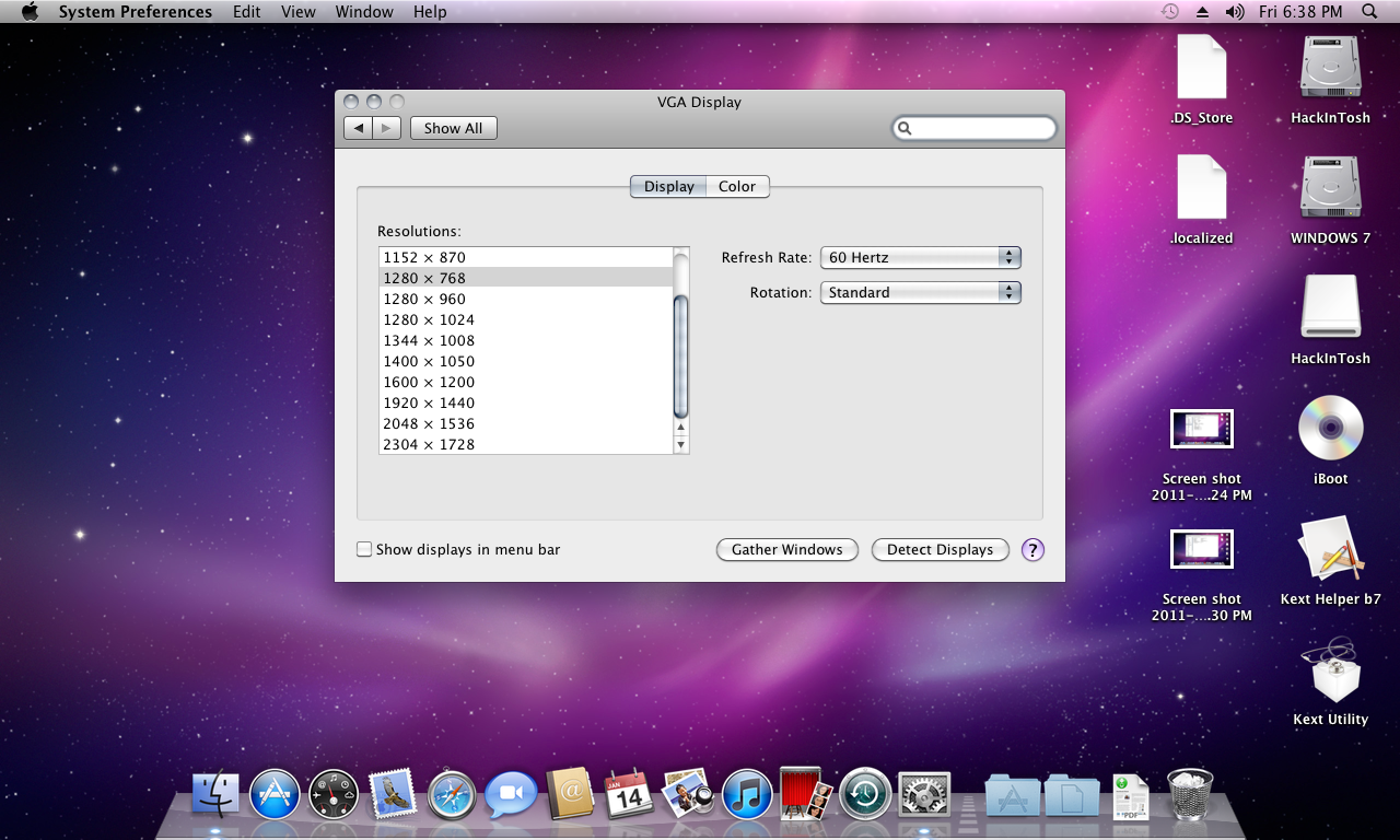

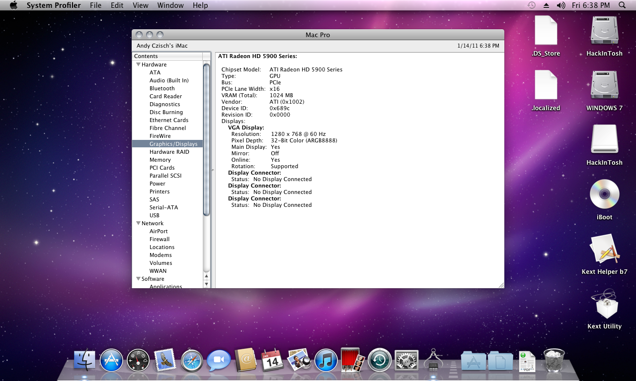

So just finished a new snow leopard install with my Asus Rampage Extreme II, i7 920, 16gb ram, ATi 5970. And everything is working! Used two threads to kind of guide me thru. I used [url="http://www.insanelymac.com/forum/topic/279450-why-insanelymac-does-not-support-tonymacx86/"]#####[/url] to install and boot up snow leopard the first time.
http://www.insanelymac.com/forum/index.php?showtopic=183361
second to last post is what I used but I cut out acouple steps
Didn't restart after update I installed all kexts and bootloader and then replaced boot file with one I will include.
And then I used
http://www.insanelymac.com/forum/index.php?showtopic=230874
To input the device ID and disable second GPU (Can't use the 10.6.4 graphics update because 10.6.6 comes with updated graphics kexts so use the kexts in your S/L/E folder AFTER 10.6.6 update)
Run kext utility reboot and BAM it worked for me :(.
