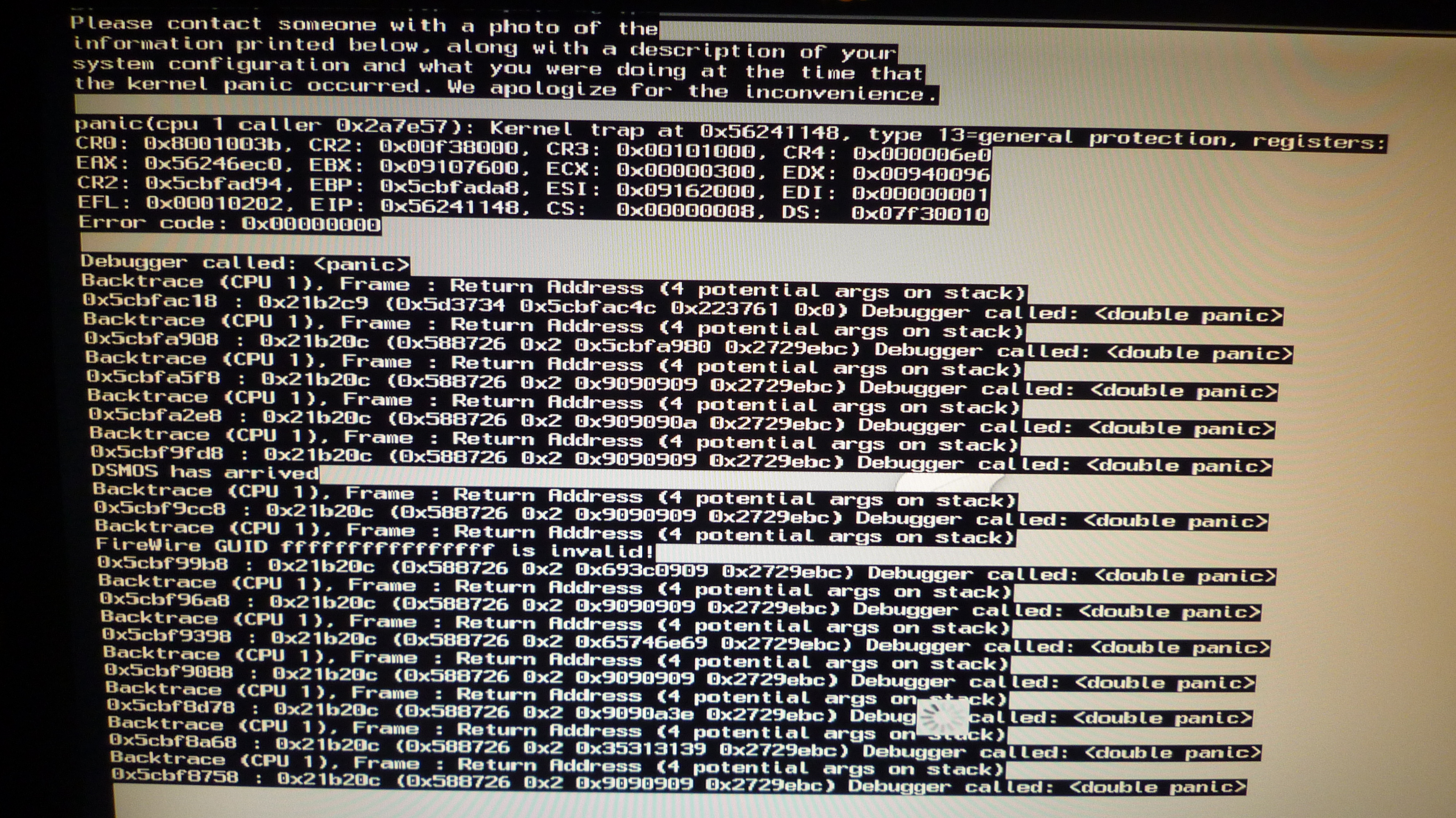

aquadog Posted October 18, 2010 Share Posted October 18, 2010 hello I want to install mac os x on my PC as a little project. My spec is: Intel core 2 duo e7200 occ to 3.0 4gb ram kingston hyperX 800mhz xfx nforce 680i lt sli palit gtx 260 216core edition 2 x SATA disks one for win7 and other for mac to keep thins simple. I have patched version of mac os x sl by HAZARD 10.6 with sse2 sse3. This is my absolutely first contact with mac but i managed to install it. When boot I get the apple logo but then kernal panic apperas. panic(cpu 0 caller 0x2a7e57): Kernel trap at... can provide with more information. Now I think the reason why this happens is that during the installation I choose wrong drivers... Could some one gide me which drivers should I chose during installatin Thanks a lot Quote Link to comment Share on other sites More sharing options...
oldnapalm Posted October 18, 2010 Share Posted October 18, 2010 If you post a picture of the panic screen it may be easier to find the problem. Select only the drivers you are sure you need. The only one really needed to the first boot is the SATA/ATA (chipset) driver, if you are not using AHCI. Quote Link to comment Share on other sites More sharing options...
aquadog Posted October 18, 2010 Author Share Posted October 18, 2010 thanks for quick rely I have uploaded a picture now. one more time Quote Link to comment Share on other sites More sharing options...
oldnapalm Posted October 18, 2010 Share Posted October 18, 2010 You don't need a legacy kernel with a Core 2 Duo CPU, use the vanilla kernel. Quote Link to comment Share on other sites More sharing options...

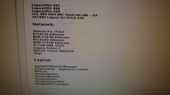

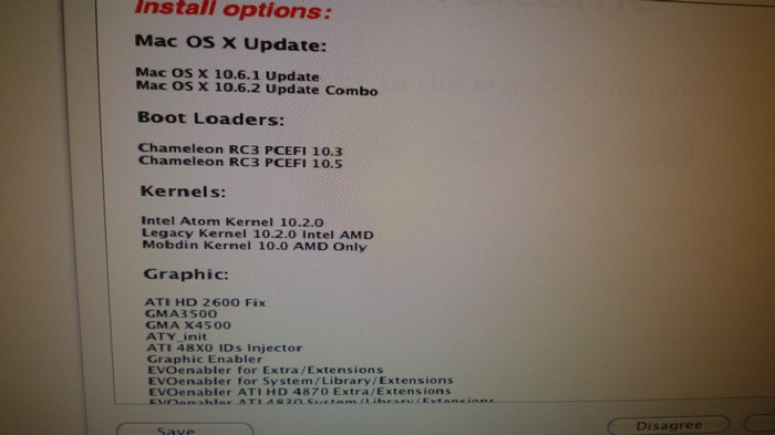

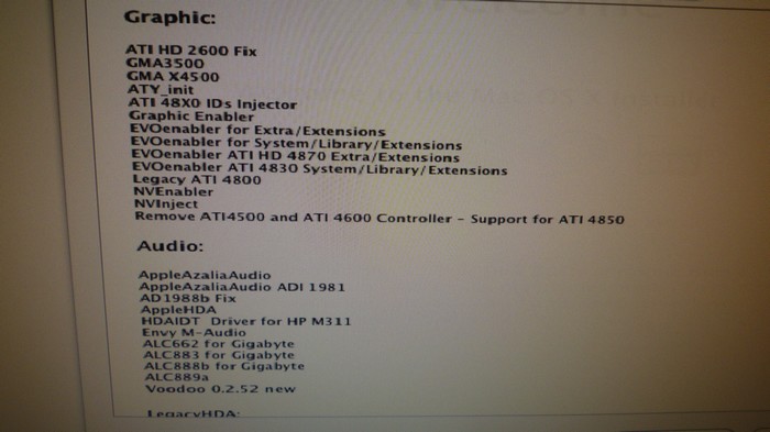

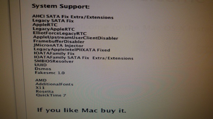

aquadog Posted October 20, 2010 Author Share Posted October 20, 2010 hi Thanks for the guide I tried it three times with no success... I get the same message during booting. I will post the pictures of choices that I have to make during installation. Could you guide me what do i have to choose for each section during installation. BIG THX Quote Link to comment Share on other sites More sharing options...
verdant Posted October 20, 2010 Share Posted October 20, 2010 hi Thanks for the guide I tried it three times with no success... I get the same message during booting. I will post the pictures of choices that I have to make during installation. Could you guide me what do i have to choose for each section during installation. BIG THX What distro version are you using as the options do not match what I have for iATKOS S3 v2 or Hazard.....? Quote Link to comment Share on other sites More sharing options...

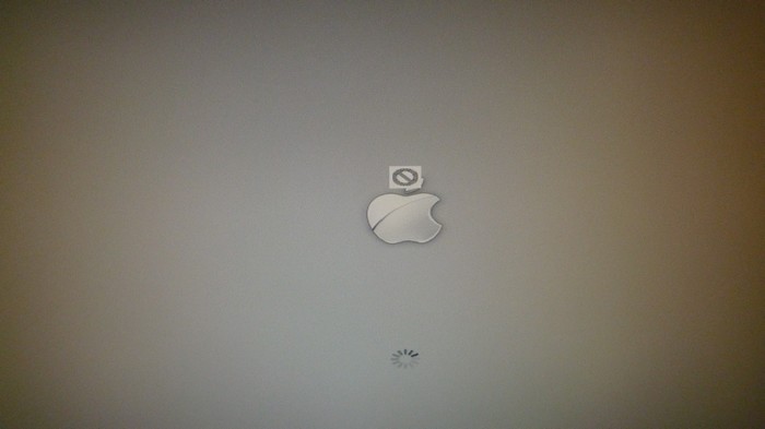

aquadog Posted October 26, 2010 Author Share Posted October 26, 2010 Hopefully it will go Ok for you......... Hi unfortunately nothing happened... I got iAKTOS S3 v2 installation CD and tried to install it but no success as I didnt get past the first APPLE logo..... I think I will never be able to install it on my PC When the logo appears in the beginning the wheel on the bottom spins then the SIGN appears (the bottom wheel still spinning) and it will sit there for infinite time and never go to install menu.... I have put all my BIOS setting on default. Quote Link to comment Share on other sites More sharing options...
geiman Posted October 26, 2010 Share Posted October 26, 2010 right after you start to boot the dvd there should be a short count down where you can interrupt it (this is before gray/white screen with the apple and spinning circle at the bottom). Press any key to interrupt the count down, and type "-v" without the quotes and then press enter to boot in verbose mode. When it stops making progress and it is hanging as you experienced before, post another picture of what the screen says so that we can see what it is hanging on. Quote Link to comment Share on other sites More sharing options...

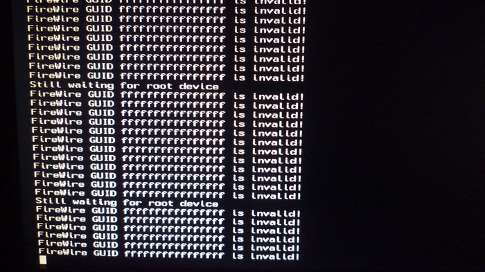

aquadog Posted October 26, 2010 Author Share Posted October 26, 2010 right after you start to boot the dvd there should be a short count down where you can interrupt it (this is before gray/white screen with the apple and spinning circle at the bottom). Press any key to interrupt the count down, and type "-v" without the quotes and then press enter to boot in verbose mode. When it stops making progress and it is hanging as you experienced before, post another picture of what the screen says so that we can see what it is hanging on. Thanks for ur super quick reply! I did what you asked me to do here is a picture of the problem. Basically it goes through different checks and then does whats on the picture all the time. Hope you can read what that MAC wants:) Quote Link to comment Share on other sites More sharing options...
verdant Posted October 27, 2010 Share Posted October 27, 2010 Thanks for ur super quick reply! I did what you asked me to do here is a picture of the problem. Basically it goes through different checks and then does whats on the picture all the time. Hope you can read what that MAC wants:) Disable Firewire (IEEE 1394) in BIOS and try again.......... Quote Link to comment Share on other sites More sharing options...

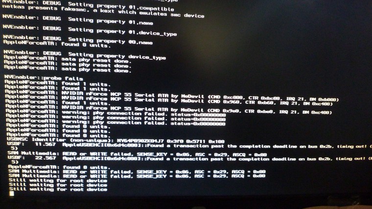

aquadog Posted October 29, 2010 Author Share Posted October 29, 2010 hi guys yet another problem.. I diabled the firewire but now there is something new... i have uploaded a picture. Quote Link to comment Share on other sites More sharing options...
verdant Posted October 29, 2010 Share Posted October 29, 2010 hi guys yet another problem.. I diabled the firewire but now there is something new... i have uploaded a picture. Switch to using a PATA (IDE) DVDRW jumper-set and connected as Master to you MOBO using a 80-wire IDE cable.........and boot with EHCIacquire=Yes Quote Link to comment Share on other sites More sharing options...
