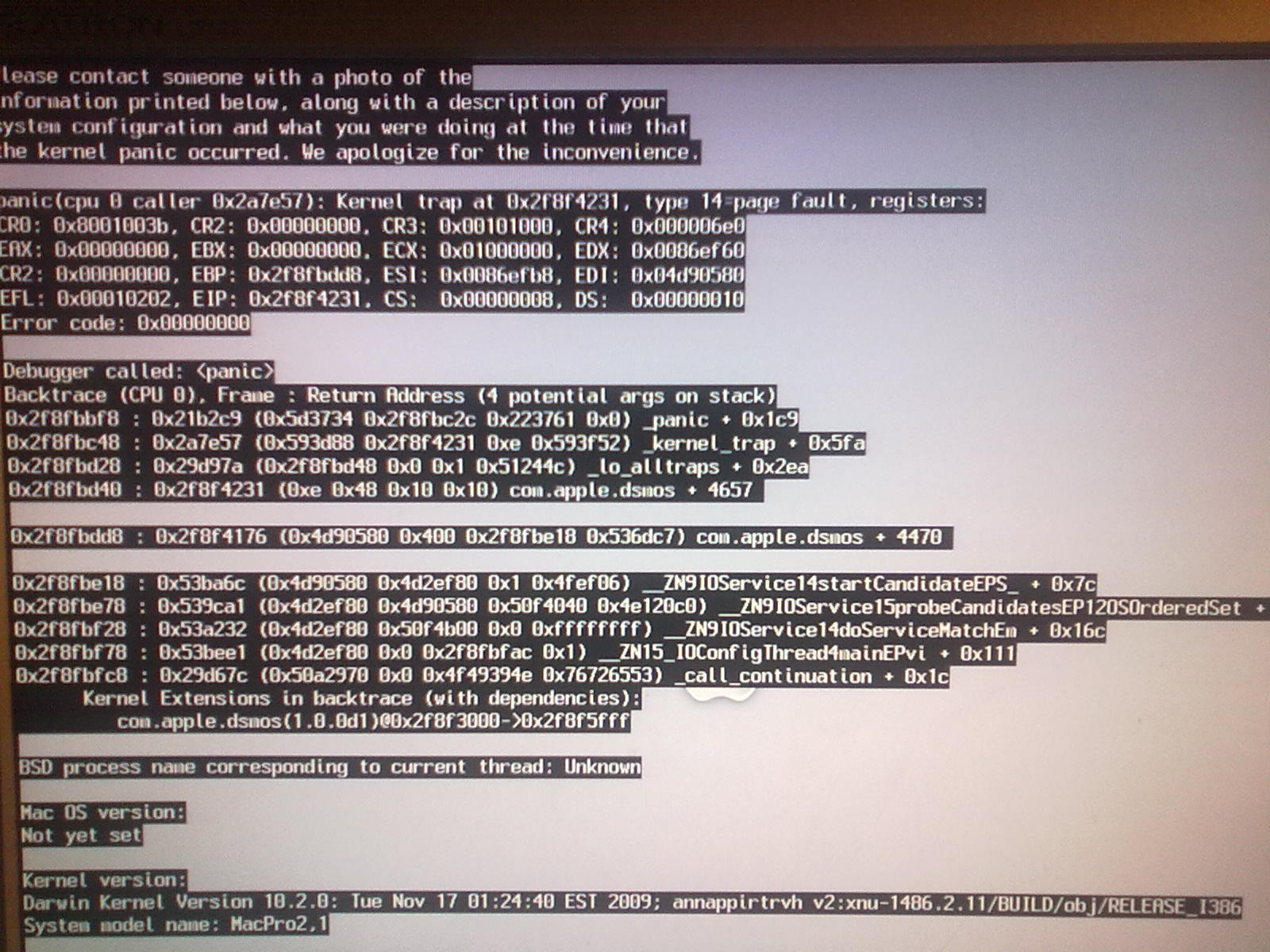

Dariuz Posted October 10, 2010 Share Posted October 10, 2010 I have just installed Hazard OS X 10.6.2. The installation went fine but it wouldn't boot up afterwards. I only managed to boot OS X after setting up dual boot with easybcd on Windows7. When I get to the white apple logo screen it freezes and i get a kernel panic. There is a photo of it. I have no idea what is causing this and i hoped someone could help me solve this. My system specs are: Motherboard: Asus a8ne-fm Cpu: AMD Athlon 64, 2200 MHz (11 x 200) 3500+ 2GB of RAM Video: Nvidia GeForce 8400GS Audio: Realtec ALC655 (probably) OS X is on a 20GB partition and the same HDD as Winows7 Quote Link to comment Share on other sites More sharing options...

Giorgio_multi Posted October 11, 2010 Share Posted October 11, 2010 The kernel panic is given by Dsmos.kext. Use Fakesmc.kext, not Dsmos.kext You don't need NVenabler.kext With snow leopard and Nvidia series 8, 9, gtsxxx, you need chameleon 2.0 => RC3 and this two strings in com.apple.Boot.plist: <key>GraphicsEnabler</key> <string>Yes</string> Here there is the last chameleon pkg. Quote Link to comment Share on other sites More sharing options...
