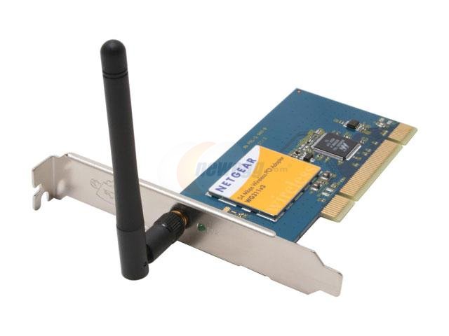

1. PCI, These cards are found in most to all Desktop PC's that have Wifi Capability.

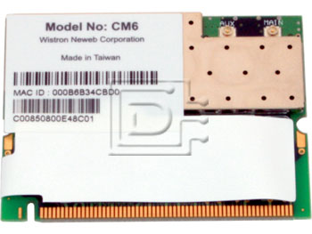

2. Mini PCI, These cards are found in older Laptops

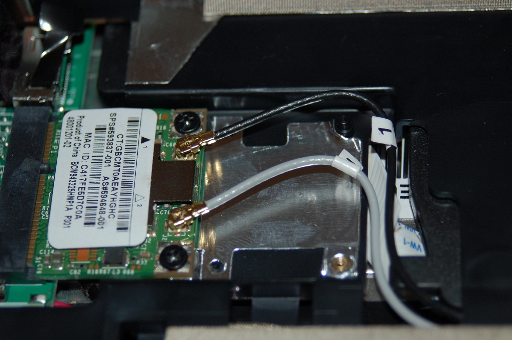

3. Mini PCIe (Mini PCI Express), These cards are found in Newer Laptops.
Also there is a shorter type of Mini PCIe card, They are about half the length of the standard Mini PCIe card but with the same interface and in most cases the laptop has space and mounts for the longer type. The example is a Broadcom 4324a and is NOT supported in OSX.
