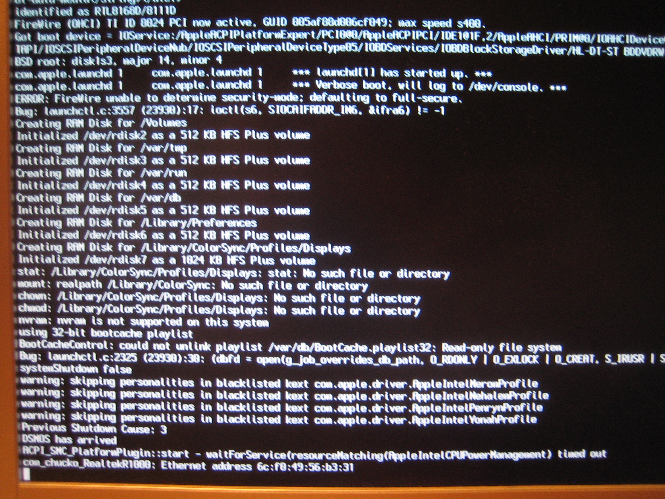

cgXR Posted May 19, 2010 Author Share Posted May 19, 2010 Sooooo... the packages came today. Everything was fine and building the computer was really fun. BUT now that I'm trying to install Snow Leopard I' running into problems. I decided to use tonymac's [url="http://www.insanelymac.com/forum/topic/279450-why-insanelymac-does-not-support-tonymacx86/"]#####[/url] + [url="http://www.insanelymac.com/forum/topic/279450-why-insanelymac-does-not-support-tonymacx86/"]#####[/url] Method. So I set up the BIOS absolutely correctly, plugged in only 4 GB of RAM an booted from [url="http://www.insanelymac.com/forum/topic/279450-why-insanelymac-does-not-support-tonymacx86/"]#####[/url] ATI. So far so good, next step I insert SL DVD and press enter, a lot of verbose text appears, and then it suddenly stops. Nothing happens anymore. And when I boot in safe mode (-x) it's exactly the same The last line on the screen is: com_chucko_RealtekR1000: Ethernet address ..blah blah.. Shot a photo so you guys can see what happens. What is wrong here? PLEASE help! Every hint is appreciated =) Oh and, forgive me for that mediocre english... I'm kinda tired right now. Link to comment Share on other sites More sharing options...
Griffwill Posted May 20, 2010 Share Posted May 20, 2010 Sooooo... the packages came today. Everything was fine and building the computer was really fun. BUT now that I'm trying to install Snow Leopard I' running into problems. I decided to use tonymac's [url="http://www.insanelymac.com/forum/topic/279450-why-insanelymac-does-not-support-tonymacx86/"]#####[/url] + [url="http://www.insanelymac.com/forum/topic/279450-why-insanelymac-does-not-support-tonymacx86/"]#####[/url] Method. So I set up the BIOS absolutely correctly, plugged in only 4 GB of RAM an booted from [url="http://www.insanelymac.com/forum/topic/279450-why-insanelymac-does-not-support-tonymacx86/"]#####[/url] ATI. So far so good, next step I insert SL DVD and press enter, a lot of verbose text appears, and then it suddenly stops. Nothing happens anymore. And when I boot in safe mode (-x) it's exactly the same The last line on the screen is: com_chucko_RealtekR1000: Ethernet address ..blah blah.. Shot a photo so you guys can see what happens. What is wrong here? PLEASE help! Every hint is appreciated =) Oh and, forgive me for that mediocre english... I'm kinda tired right now. How long are you waiting before rebooting? double check that HPET SUPPORT is ENABLED and in 64-BIT MODE under power management. it will take a minute to start up the first time. double check your BIOS and try again. Wait at LEAST 3-4 minutes before giving up and rebooting. Link to comment Share on other sites More sharing options...
cgXR Posted May 20, 2010 Author Share Posted May 20, 2010 Yeah, I waited like 10 minutes... nothing happens What I tried: BIOS settings: set first Boot to CDROM, enabled HPET Mode @64bit, Changed PCH SATA Control Mode and eSATA Control Mode to AHCI, disabled GSATA Controller, disabled Onboard Serial Port and Parallel Port. I even diabled Firewire and onboard LAN, just to be sure. Put GFX in upper and lower PCI-e slot and plugged display into both DVI ports. I also tried out another display. What I'm doing now, I removed an old standart IDE DVD Drive from an old computer and plugged this into the new machine. (The LG BlueRay Drive is SATA Controlled) What happens is I get the still waiting for root device notification. I played around with jumper settings and connected it to both ports on the cable. The motherboard has only one IDE port, so I'm using the right one. My DVD drive appears in BIOS at IDE Channel 4 Master. I'm really frustrated now, I wanna at least see that Mac OS Install screen, pleeeaaase! At moderators; maybe rename and move this topic to installation subforum?! Please, what could I possibly be doing wrong here? I mean, it's a Gigabyte mobo, nothing exotic and many people use that kind of configuration. Could it possibly have something to do with the graphics card? Have a look at post 1 for the system specs. Regards, cgXR Link to comment Share on other sites More sharing options...
