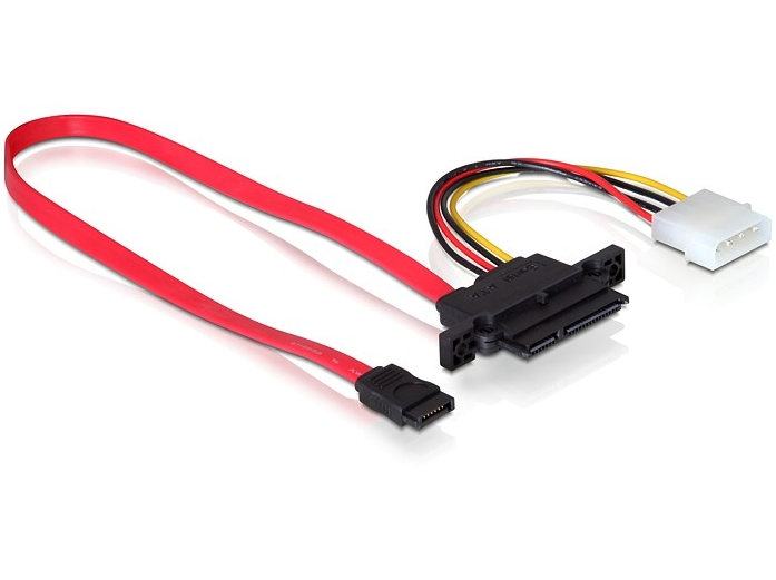

I soldered the Apple SATA quick release to regular SATA connectors in order to use the HD bays to their full extent. The case is also tidier that way. Still misses the fan shroud that should cover most of the cable mess in the front.
Delicious strands... Counting preparation and soldering it took close to a day.
