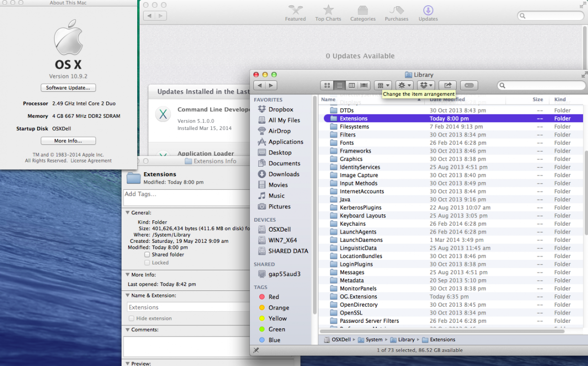

I used a brute force method to restore fully functioning sleep on my XPSm1530 for 10.9.2.  Since I needed to manipulate system files, I booted into a spare OSX installation on an external USB HD.
1. Show hidden files in Finder
defaults write com.apple.finder AppleShowAllFiles 1 && killall Finder
2. Renamed the mach_kernel on the root directory ----> OG.mach_kernel
3. Renamed /System/Library/Extensions ----> System/Library/OG.Extensions
4. Copied 10.9.1 mach_kernel to the root directory
5. Copied S/L/E from a working 10.9.1 install on USB hard drive to System/Library folder (this included regressed
    AppleACPIPlatform.kext 1.1MB size)
6. Repaired permissions with Disk Utility

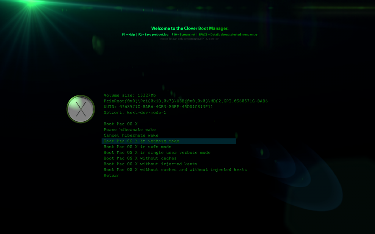

7. Booted into Mavericks without caches with Clover
About This Mac still shows system as 10.9.2 and system as up to date

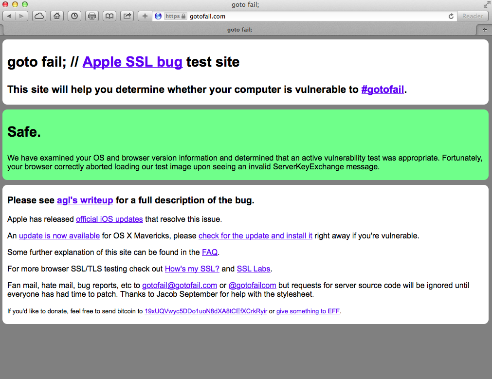

System still fixed with regard to the "gotofail" bug like "proper" 10.9.2
Sleep returned to 100% normal and all applications, iMessage, iCloud etc still work.  Thank god for backups :D.

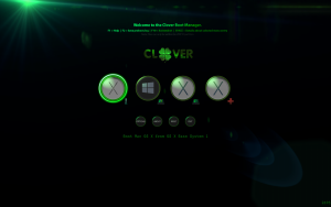

Tried Clover at last !
At last got a chance to try Clover on my Friend’s Lenovo G580 . Had some trouble initially with getting used to EFI, so used legacy mode (our mode :P) to install Mavericks. But later cleared the issues and might probably run well under EFI too. Chameleon might be good for any system pre windows 8 but clover seems indispensable for any machine after that.
Btw, guys MBR is dead :( Gosh I felt very old when dealing with EFI :lol: .
  1. Renamed mach_kernel in root ----> OG.mach_kernel
  2. Renamed /System/Library/Extensions ----> System/Library/OG.Extensions
  3. Copied 10.9.1 mach_kernel to the root directory
  4. Copied S/L/E from a working 10.9.1 install on USB hard drive to System/Library folder (this included regressed AppleACPIPlatform.kext 1.1MB size)
  5. Repaired permissions with Disk Utility
  6. Booted into Mavericks without caches with Clover
If you don't have a backup copy of 10.9.1 S/L/E and mach_kernel from a working install or backup, you could use Pacifist to extract these files and folders from a copy of 10.9.0 or 10.9.1 Install OS X Mavericks.app as shown below....

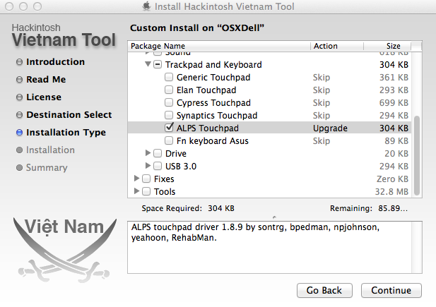

Hi Guys,
I was playing around with the latest Hackintosh Vietnam Tool (an excellent collection of hackintosh utilities compiled by @pokenguyen) and installed the new Alps Touchpad driver aka VoodooPS2Controller.kext ver 1.8.9 from the rehabman/master into bpedman_merge.
It has support for multi-touch gestures, is fully integrated with the native trackpad prefpane (in settings) and seems quite stable.  I recommend other XPSm1530 users try it out :).
VoodooPS2Controller.kext.zip

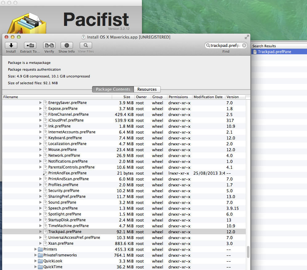

@DarwinX 10.9.2 Trackpad.prefPane.  Don't have the one for 10.8.
This Trackpad.prefPane is working beautifully with the provided VoodooPS2Controller.ketx version 1.8.9 under both the 10.8 and the 10.9.
However, the tracking and scrolling speeds are extremely slow despite my adjusting them all the way up in the Trackpad.prefPane.
Any ideas?

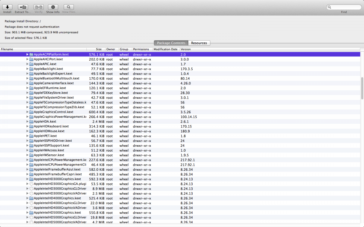

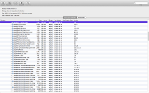

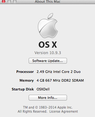

Upgraded successfully to OSX 10.9.3 using the Combo Updater.  System reboots normally and audio still works if you have VoodooHDA and AppleHDADisabler kexts in S/L/E.
Kexts installed by the update can be viewed with Pacifist....
  • AppleHDA ver 2.6.0 ----> 2.6.1
  • AppleGraphicsPowerManagement, AppleSMC, AppleRTC & AppleACPIPlatform get overwritten (despite kext version numbers remaining the same as in 10.9.2) so repatch/replace if necessary.
I also found sleep functions the same on my XPS m1530 as in 10.9.2 with the vanilla AppleACPIPlatform.kext (OK for the first sleep, reboots on invoking sleep a second time) ---> fixed with the same procedure as I described in post #1701.

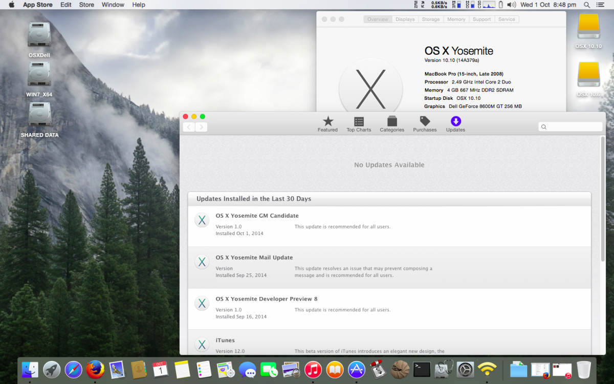

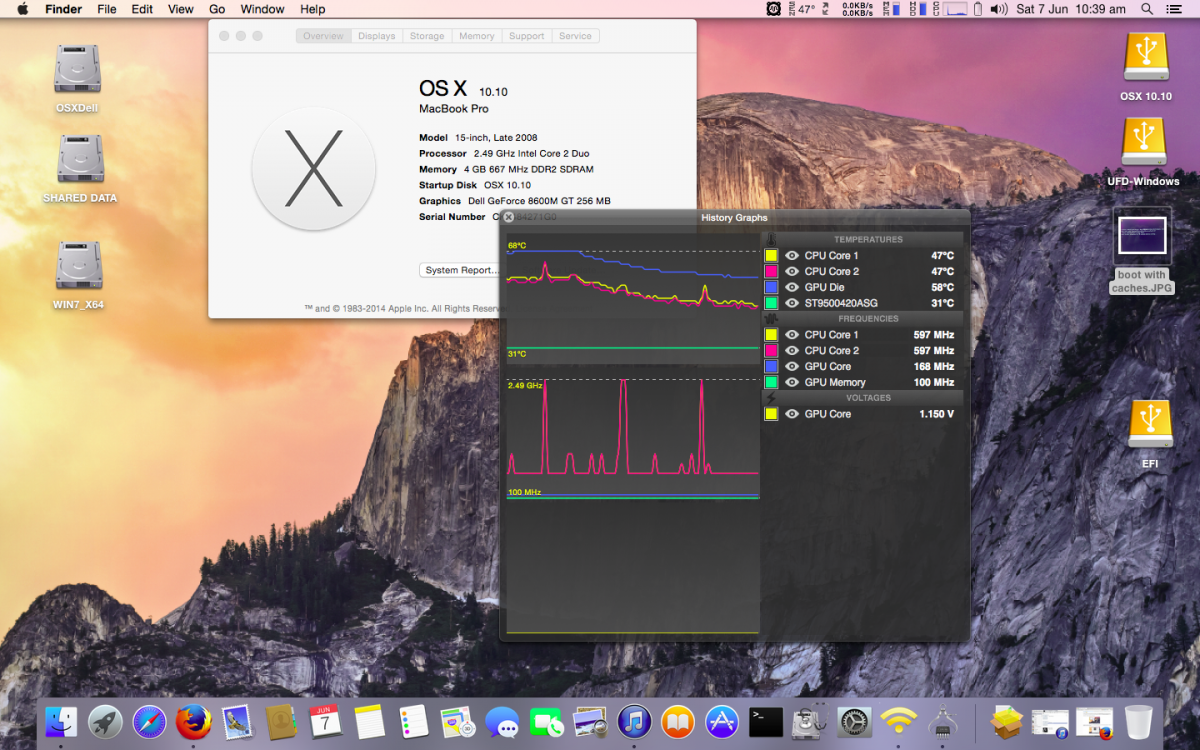

OSX Yosemite DP1 successfully installs on XPSm1530 with Clover
At the moment, Clover is the only bootloader working with OSX Yosemite 10.10 due to changes implemented by Apple to the kernel cache :yes:Version 2695+ uploaded by Slice in this post can inject kexts properly in 10.10 so if you're running Clover, you can try it out for yourself :thumbsup_anim:.
Instructions installing OSX 10.10 DP1

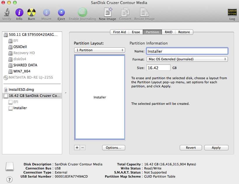

1. Insert a 8GB+ USB and use Disk Utility's partition tab to create a single partition HFS+, GUID formatted USB named "Installer"
2. Use ShowAllFiles.app to show hidden files in Finder

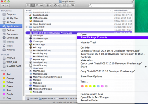

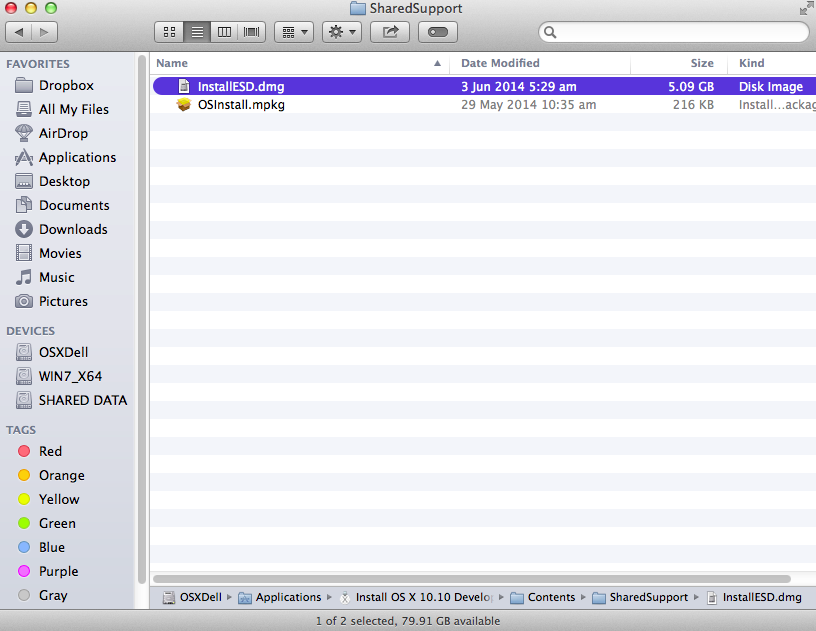

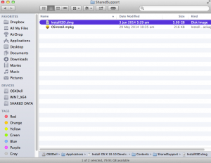

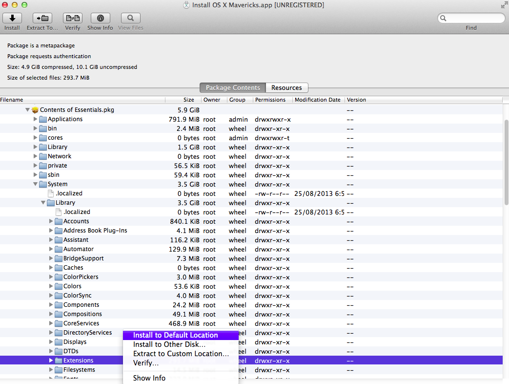

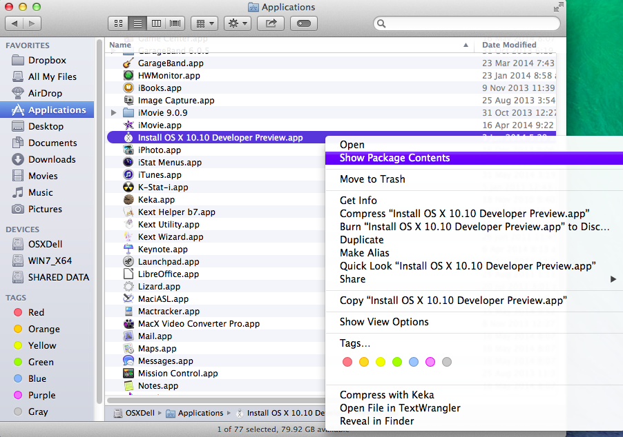

3. In your Applications folder (or wherever you've downloaded Yosemite), right click on "Install OS X 10.10 Developer Preview.app" and choose "Show Package Contents"
4. Navigate to Contents/Shared Support

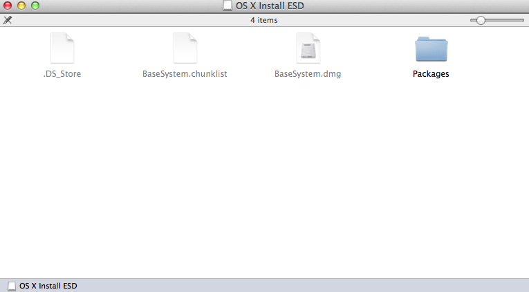

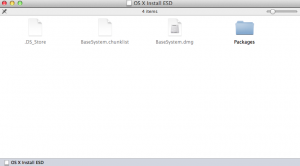

5. Double click on InstallESD.dmg to mount it - you'll see a Packages Folder and 2 hidden files,
      BaseSystem.chunklist+BaseSystem.dmg (you'll need these later)

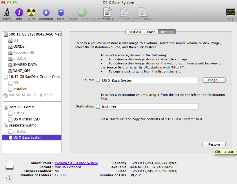

6. Mount BaseSystem.dmg by double clicking on it
7. Using Disk Utility, restore "OS X Base System" to your USB by dragging the icon for the USB to the destination field of the Restore tab

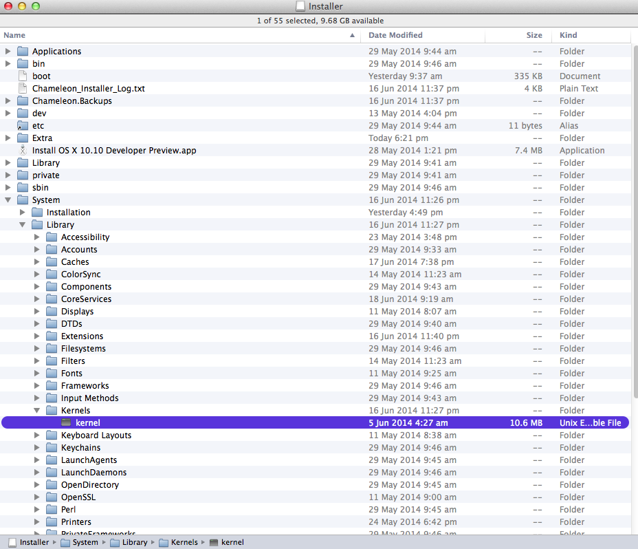

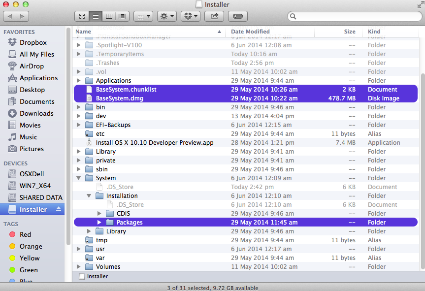

8. On the USB Stick, in the System/Installation folder, delete the link named Packages
9. Copy the Packages folder from "OS X Install ESD" to the System/Installation folder on the USB Stick
10. Copy BaseSystem.dmg and Basesystem.chunklist from "OS X Install ESD" into the root folder of the USB installer

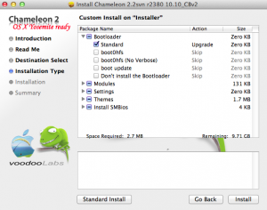

11. Install Clover onto your USB with the following custom options
Attached files to correctly configure Clover Yosemite Installer for the XPS M1530.  Make sure to mount the EFI partition of the USB to access Clover files eg using EFI Mounter-v2-1.app
config.plist--->put into EFI/CLOVER folder
DSDT.aml--->put into EFI/CLOVER/ACPI/patched folder
FakeSMC.kext, VoodooPS2Controller.kext--->put into EFI/CLOVER/kexts/Other & delete 10.6-10.9 folders
Utilities.zip contains
EFI Mounter-v2-1.app to mount/unmount the EFI partition

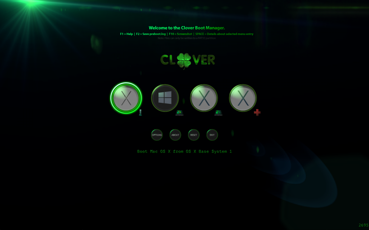

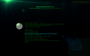

12. Boot the installer USB with Clover (in verbose mode with injected kexts) to install Yosemite.
Choose your default language then use Disk Utility to prepare an HFS+ partition ---> follow the prompts of the OSX installer to install into that partition.
13. Reboot with the USB into OSX Yosemite on the HD to complete the installation, then install Clover into the EFI partition of your boot drive.  Don't forget to mount the EFI of the hard drive and place the same files from step #11 into the corresponding Clover folders.
14. Install post install kexts like VoodooHDA, AppleHDADisabler into S/L/E of the boot drive with Kext Utility.
Initial Thoughts
Everything running like in 10.9.2 & 10.9.3 and the Appstore, iCloud, iMessage etc are OK.  Just reinstall VoodooHDA.kext and AppleHDADisabler.kext in S/L/E with kext utility to get sound.  Temps and speedstep working well with Clover...

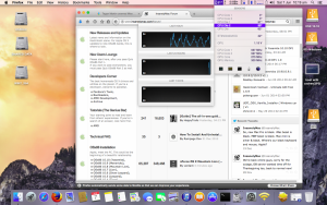

Sleep is still like 10.9.2 and 10.9.3 using all vanilla kexts - works perfectly for the first invokation but unfortunately triggers a reboot when you do it a second time.  I haven't tried rolling back any kexts at this stage but I doubt we will have any luck unless someone discovers/creates a rollback AppleACPIPlatform.kext that is compatible with Mavericks 10.9.2+ & Yosemite.
It really isn't a bother once you get used to it.....just avoid triggering the second sleep (by shutting down instead).  However, I realize fully functional sleep is still important for many people (myself included) so my main install remains 10.9.3 with 10.9.1 kernel/kexts + regressed AppleACPIPlatform.  Yosemite is on an external USB HD for testing :).

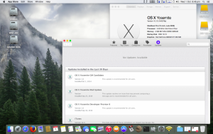

1. Successful update to Yosemite Update1/DP2 through App Store.  Nothing to change with VoodooHDA.kext and AppleHDADisabler already installed, sound still works :)

10. Appstore upgrade to GM Candidate 10/01/14.  Looking good - no problems with update :).
Anyone interested in testing OS X 10.10 without being a registered Mac software developer, or member of the OS X Beta Seed Program, can change their App Store URL by entering the following terminal command (all on one line):
sudo /usr/sbin/softwareupdate --set-catalog https://swscan.apple.com/content/catalogs/others/index-10.10seed-10.10-10.9-mountainlion-lion-snowleopard-leopard.merged-1.sucatalog.gz
and undo the change using the following command:
sudo /usr/sbin/softwareupdate --clear-catalog
Reference - @PikeRAlpha's blog

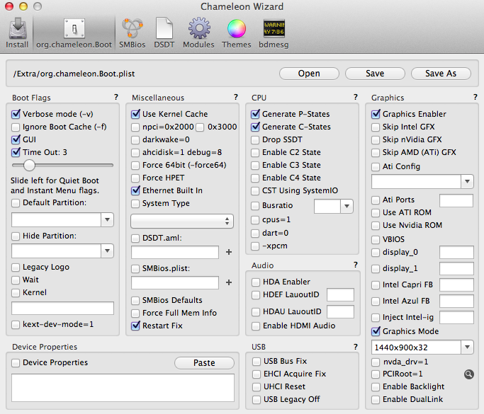

Yosemite Installation with Chameleon (revised)
Make sure to choose "Customize", then select a standard install of the bootloader, custom setttings to generate the following org.chameleon.Boot.plist and MBP 5,1 smbios.plist in /Extra (also provided in attached files).
<plist version="1.0">
<dict>
    <key>EthernetBuiltIn</key>
    <string>Yes</string>
    <key>GenerateCStates</key>
    <key>GeneratePStates</key>
    <key>Graphics Mode</key>
    <string>1440x900x32</string>
    <key>GraphicsEnabler</key>
    <key>Instant Menu</key>
    <key>Kernel Flags</key>
    <string>-v</string>
    <key>ShowInfo</key>
    <key>UseKernelCache</key>
    <string>No</string>
</dict>
</plist>
  • Add DarwinX's DSDT.aml for the XPSm1530 into /Extra
  • Install FakeSMC.kext and VoodooPS2controller.kext into /S/L/E of the USB with Kext Wizard
  • Create a folder "Kernels" in /System/Library and copy the provided Yosemite kernel into that folder
  • Boot into the Installer (verbose mode without caches already specified in o.c.B.plist), choose your default language then use Disk Utility to prepare an HFS+ partition (named say Yosemite)---> follow the prompts of the OSX installer to install into that partition
  • Reboot into Yosemite using the Installer USB and complete the setup & install.  Copy the /Extra folder from the USB to the Yosemite volume and also install Chameleon_2.2svn_r2380_10.10_CBv2 onto the hard drive
  • Install FakeSMC, VoodooPS2Controller, VoodooHDA, AppleHDADisabler kexts into /S/L/E with Kext Wizard and patch AppleRTC.kext as described in this post.
Notes on Post Install
1.  The native kernel in Yosemite is actually named "kernel' and resides in /System/Library/Kernels.   Chameleon_2.2svn_r2380_10.10_CBv2 is able to auto detect its location so you no longer need to specify this with a kernel key in o.c.B.plist.
2.  Apple has changed the compression used for the kernelcache from lzss to lzvn.  You can change it back so that Chameleon can utilize the KC by editing the file /usr/standalone/bootcaches.plist

One of the lesser known features of Clover is its ability to chainload Chameleon.  This can be useful if you want to determine whether any issues are related to a specific bootloader....
Procedure For Installing Clover to Chainload Chameleon in Yosemite
1. Install Clover into the EFI of your boot drive with the following options and "Use Alternative Booting PBR"
post-846696-0-92428900-1402660837_thumb.
2. Download Chameleon r2378_Yosemite boot file from here and rename it boot1
3. Mount the EFI partition and copy boot1 into it
post-846696-0-13882600-1402661198_thumb.
4. Reboot the computer and when you see Clover's blinking underscore, press the <1> key during the two second pause ----> Chameleon will take over the boot process ----> boot into Yosemite.  If you don't press any key, it automatically defaults to a normal Clover boot.
Share this post

Interesting Clover fact posted by Pene in the Clover General Discussion topic:
"Now as a side note, I have seen that many people think that because their system is not UEFI and they use Clover as Legacy, they need to keep using Legacy Windows.
So in case you think that, know that it's not true - I use Windows 7/8.1 installed in UEFI mode on all my systems with CloverEFI (and the systems don't have UEFI bios).
So my main recommendation to both of you is to get rid completely of MBR, stay with a pure-GPT partition, and reinstall Windows in UEFI mode.
CloverEFI provides a full UEFI environment, and you can install Windows in UEFI mode if you boot the Windows DVD or USB through Clover, not as Legacy, but by choosing the EFI entry"
I can confirm that it is possible to install & boot UEFI Windows on our old BIOS based machines with Clover
On a GUID partitioned external USB hard drive, I installed OSX first, then Windows Server 2012 (in "to go mode" following directions from this blog post), then the Clover bootloader into the EFI partition.  I can now dual boot OSX/Windows on the XPSm1530 through Clover (choose Microsoft boot menu and boot through bootmgrfw.efi).
Why boot this way?
Advantages: GPT/UEFI is the way of the future and you avoid the 4 partition/2TB limit of mbr/hybrid mbr - you can have multiple recovery partitions, OSX, Linux and Windows installations in a multiboot arrangement on the same drive.
Disadvantages: Some older disk partitioning/backup programs may only work with mbr.
Edit:  I finally took the plunge and converted the hybrid mbr on my main drive to full GPT and clean installed UEFI Windows 7_X64.
Summary of Steps Installing UEFI Windows 7 X64 on internal GPT HD
  1. Booted into OSX partition and used GDisk to delete the old Windows partition and convert the disk to pure GPT (by writing a protective mbr over the hybrid mbr).   Overview of GPT and man page of Gdisk.
  2. Installed Clover into the EFI partition of the HD
  3. Booted the computer with Clover from the HD, then inserted Windows 7_X64 UEFI install USB
     4. Choose bootx64.efi from EFI boot menu of the install USB.  Follow the prompts to install UEFI Windows into the free
         space created by step 1
     5. After the installer has finished writing files to disk, it will automatically reboot--->remove install USB now
     6. Computer will boot into the Clover screen and there will now be an internal EFI menu to choose--->select to boot
         bootx64.efi.  Windows will now finalize settings and complete the install!
So, I am FINALLY getting somewhere positive with this.  I'm not sure how, but I have managed to get clover to boot my machine successfully several times in a row, and it EVEN detects my internal HDD (I've been booting it from USB drives).  I think it was because I may have been installing it incorrectly before.  This time I took great care to set up the EFI partition beforehand, and it seems to have made a difference.  I'm at the point where I'm trying to test install UEFI Windows on an external drive with two partitions (One for OSX, one for Windows) all GPT and Clover.  However, the problem I'm running into is that I followed the steps outlined above underneath the "Edit" section: Clover isn't seeing the bootx64.efi on the pendrive when it boots to the menu.  Instead, it shows bootmgr.efi, which does nothing when I select it.  Now I know for a fact that bootx64.efi is in the /efi/boot folder, because after rufus was done creating the drive, I double checked to make sure it put the file there.  When it didn't work the first time, I went back and extracted it from install.wim and put it there myself.  I don't know why, but Clover just doesn't provide it as a menu option.  Interesting fact: it /did/ show cdboot.efi as a menu option before I renamed that file to cdboot.efi.old.  Any suggestions?
Side note: haven't really noticed any difference in temperature since booting from Clover, but I'm also not quite done configuring it either, so I'm reserving judgement.  FYI, able to boot 10.9.3 with clover both internally and externally.  Sleep/wake is whacky (freezes on wake with full display showing), but again, not done yet, so...
