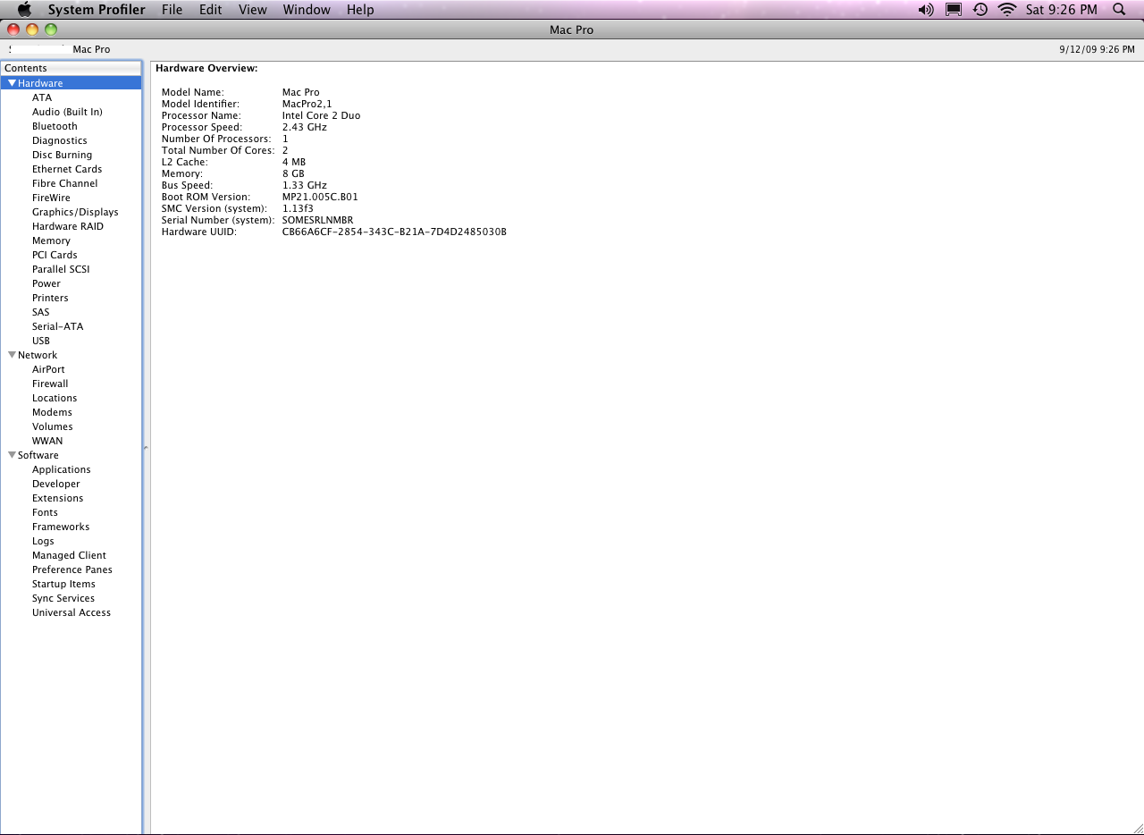

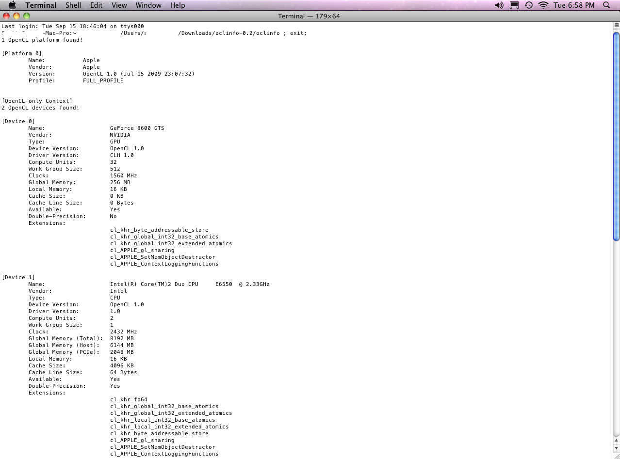

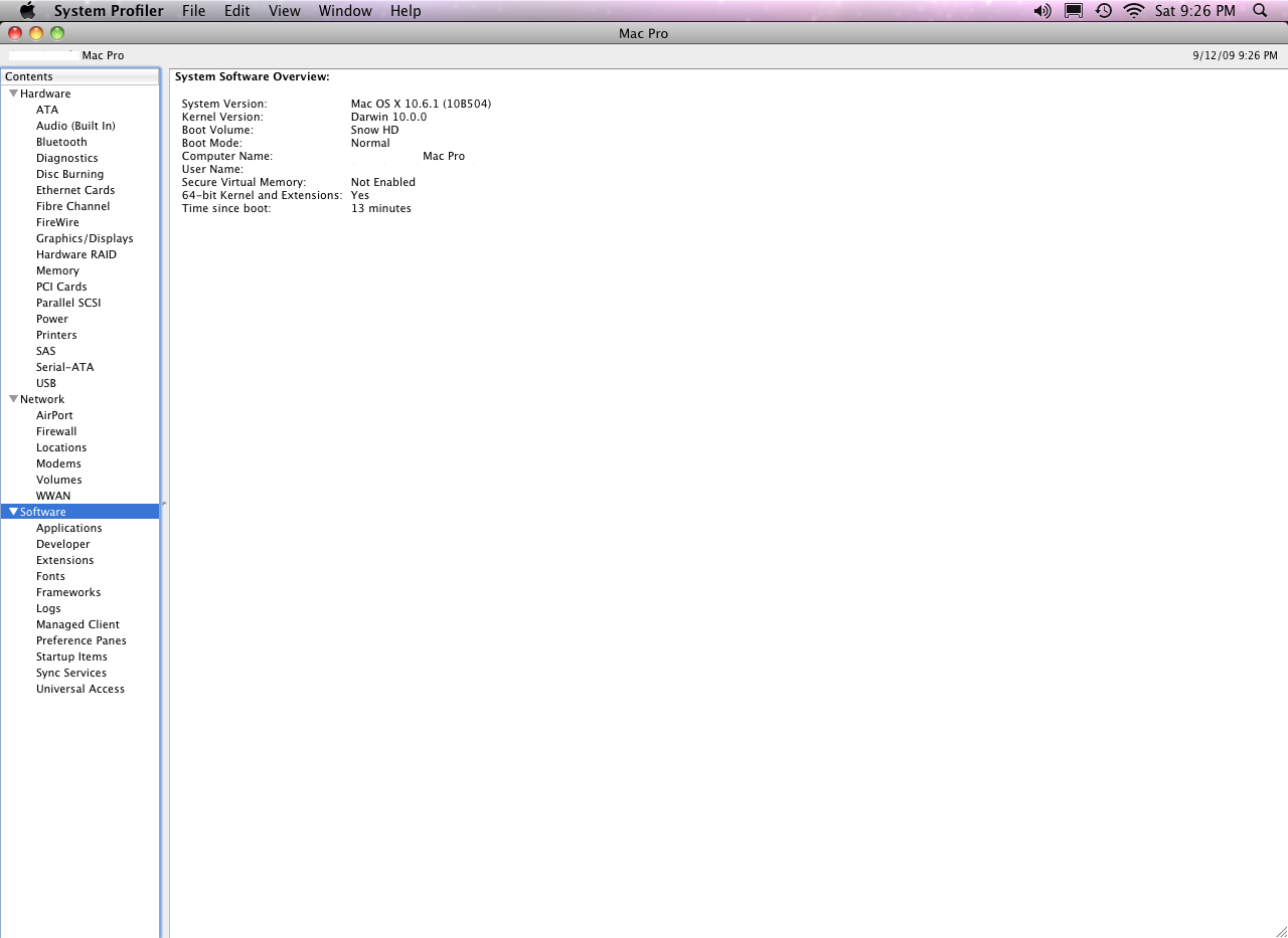

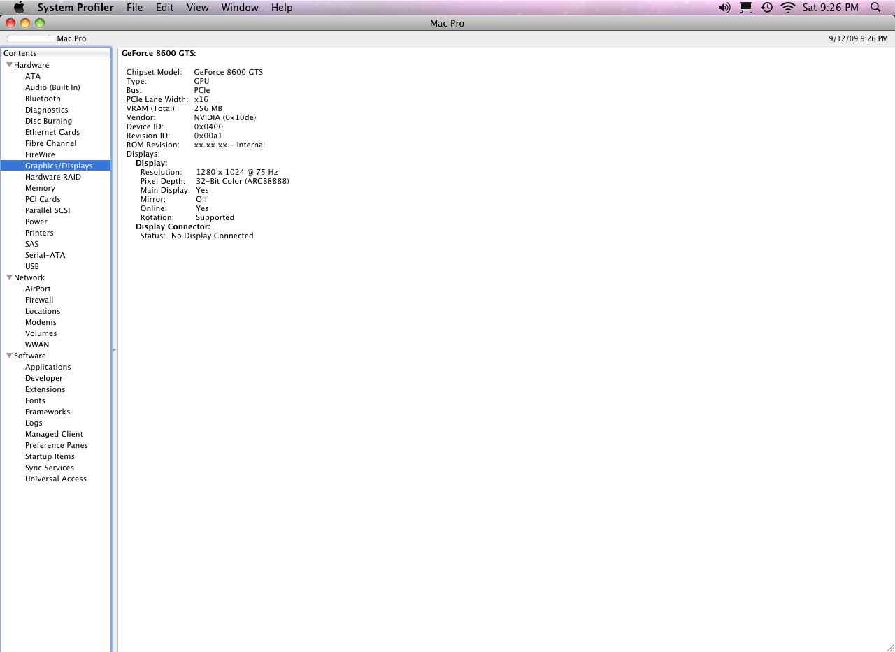

Panther1 Posted September 15, 2009 Share Posted September 15, 2009 Hello to everyone, Today I want to share with you my experience with installing Snow Leopard on an Asus P5Q motherboard with absolutely no kernel panics whatsoever! Defaults to 64bit enabled too! 1. Obtain the modded bios for this motherboard here: Modded Bios for P5Q 2. Download and burn the bootcd here: SL Boot CD - Chameleon RC3 3. Boot system with bootcd and eject when menu appears 4. Insert your retail SL dvd into drive and wait a few seconds then hit F5 and it will now show Mac OSX Install Disk 5. Hit enter and it will boot up into the setup 6. Open up Disk Utility and partition your drive for SL with GUID format 7. Exit out of Disk Utility and then proceed with install picking the defaults or removing unecessary items from list 8. Once install finishes it will state that it did not install successfully (hint it really did, it just could not bless the booting of the installation with out the help of the cd) 9. Reboot system with boot cd and then arrow over to your SL install and hit enter 10. Once you are at the setup screen finish setting up your system. 11. After setting up your system you will have just a few more steps to go for your perfect retail install 12. Download the Kext Helper app here: Kext Helper App 13. Download the VoodooHDA 64bit kext file here: VoodooHDA 64Bit Audio driver for ALC1200 14. Install VoodooHDA kext with Kext Helper 15. Reboot system with BootCD still in drive and pick your SL install 16. Voila! At this point you can update as normal and get up to 10.6.1 without any hassles or kernel panics. * No drivers are needed for the graphics, they are native with full Open CL 1.0 enabled! * Time Machine works out of the box! * The only thing missing from this near perfect retail install is a way to get the BootCD boot loader installed on the SL install. Once this is achieved, you will have the perfect Mac Pro using your retail disk unmodified! Below are the screen shots of my Mac Pro with Snow Leopard 10.6.1 installed: Link to comment Share on other sites More sharing options...

Panther1 Posted September 16, 2009 Author Share Posted September 16, 2009 Thanks Ehh! My system specs are as follows: Asus P5Q - modded bios 2102 from Juzzi Intel Core 2 Duo E6550 2.33GHZ CPU EVGA Nvidia 8600GTS SSC 256mb PCI-e 1 x Seagate 500GB Sata II drive (Snow Leopard) 2 x Western Digital 160GB Sata II drives - 1 Time Machine backups - other misc 8GB DDR2 667 Kingston memory Buffalo 54G PCI Wireless card Mind listing your exact specs and hardware? Congratulations! That's excellent news Bxtreme! Now we just need a way to get Chameleon to boot from the Leopard Partition and not the BootCD! Everything else seems to be working fine! Link to comment Share on other sites More sharing options...

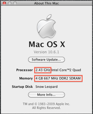

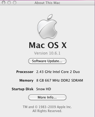

deadpxl Posted September 21, 2009 Share Posted September 21, 2009 Hi! i got my snow leopard running perfectly (with some few random freezes sometimes) i have a minor problem on my About this Mac which displays incorrect value on my cpu & ram, my cpu is 2.40ghz but it indicates 2.43ghz while my ram indicates 667mhz but im using 800mhz, any suggestion how to fix this? Thanks! plus anyone of you tried running iLife '09? on my previous installation using SnowOSX distro caused a lot of kernel panic, not tried it yet on Retail because i don't want to mess up my installation Thanks for this wonderful guide! Link to comment Share on other sites More sharing options...

Panther1 Posted September 23, 2009 Author Share Posted September 23, 2009 Hey Kooby, Thanks! I have not had a single kernel panic from this installation. It is rock solid! I'm getting a evaluation of Snow Leopard Server shortly and will test it out as well. I run ILife 09 and IWork 09 flawlessly! As far as OSX is concerned, I have a real Mac Pro! I have noticed that I too have the incorrect cpu speed listed. I do have DDR2 667 memory so that read out is correct. Also in Disk Utility its stating that the drives are external instead of internal. None the less My Mac Pro is purring like a beautiful kitten! Panther1 Panther..This Sounds like a great guid! I'm going to pull the trigger tomorrow. I've done a leopard install on a P5Q-EM about 6 months back and it went great - nearly 100% stable. I was wondering whether you have had any stability issues re iLife or final cut pro (if you use it). I would like to make this my primary OS X machine and was wondering if it will be relatively problem free. Thanks again! Hi Deadpxl, I had nothing but kernel panic after kernel panic running SnowOsX 3.5. I finally managed to get a working installation of it but wanted a more stable and clean installation. Using this retail method has produced the cleanest and stable Snow Leopard installation to date. As far as OSX is concerned, I have a real Mac Pro. Go ahead and pull the trigger and install with this method. You won't regret it Panther1 Hi! i got my snow leopard running perfectly (with some few random freezes sometimes) i have a minor problem on my About this Mac which displays incorrect value on my cpu & ram, my cpu is 2.40ghz but it indicates 2.43ghz while my ram indicates 667mhz but im using 800mhz, any suggestion how to fix this? Thanks! plus anyone of you tried running iLife '09? on my previous installation using SnowOSX distro caused a lot of kernel panic, not tried it yet on Retail because i don't want to mess up my installation Thanks for this wonderful guide! Link to comment Share on other sites More sharing options...

Ian T Posted September 23, 2009 Share Posted September 23, 2009 Hi! i got my snow leopard running perfectly (with some few random freezes sometimes) i have a minor problem on my About this Mac which displays incorrect value on my cpu & ram, my cpu is 2.40ghz but it indicates 2.43ghz while my ram indicates 667mhz but im using 800mhz, any suggestion how to fix this? Thanks! plus anyone of you tried running iLife '09? on my previous installation using SnowOSX distro caused a lot of kernel panic, not tried it yet on Retail because i don't want to mess up my installation Thanks for this wonderful guide! deadpxl, You can hard-code that information by editing AboutThisMac.strings. But, I do not know of a way to correct that information without hard-coding CPU and RAM info into AboutThisMac.strings. Please note that this is only aesthetics... It doesn't change hardware values to reflect your hardware configuration. /System/Library/CoreServices/loginwindow/Contents/Resources/English.lproj/AboutThisMac.strings Copy AboutThisMac.strings to your desktop, edit with TextEdit, and then copy back into English.lproj of loginwindow (you'll have to authenticate). Change this to reflect CPU information: Before: "ABOUT_BOX_SINGLE_PROCESSOR_FIELD_FORMAT" = "%@"; "ABOUT_BOX_SINGLE_PROCESSOR_L3CACHE_FORMAT" = "%@ L3 cache"; After: "ABOUT_BOX_SINGLE_PROCESSOR_FIELD_FORMAT" = "2.40 GHz Intel Core 2 Duo"; "ABOUT_BOX_SINGLE_PROCESSOR_L3CACHE_FORMAT" = "2.40 GHz Intel Core 2 Duo"; Chances are, it is unlikely that you have to edit the "MULTIPLE_PROCESSORS" fields, but if you want to you can -- it won't hurt anything. Change this to reflect MEMORY information: Before: "ABOUT_BOX_MEMORY_FIELD_FORMAT" = "%@%@"; After: "ABOUT_BOX_MEMORY_FIELD_FORMAT" = "4 GB 800 MHz DDR2"; Regards, IanT Hello to everyone, Today I want to share with you my experience with installing Snow Leopard on an Asus P5Q motherboard with absolutely no kernel panics whatsoever! Defaults to 64bit enabled too! 1. Obtain the modded bios for this motherboard here: Modded Bios for P5Q 2. Download and burn the bootcd here: SL Boot CD - Chameleon RC3 3. Boot system with bootcd and eject when menu appears 4. Insert your retail SL dvd into drive and wait a few seconds then hit F5 and it will now show Mac OSX Install Disk 5. Hit enter and it will boot up into the setup 6. Open up Disk Utility and partition your drive for SL with GUID format 7. Exit out of Disk Utility and then proceed with install picking the defaults or removing unecessary items from list 8. Once install finishes it will state that it did not install successfully (hint it really did, it just could not bless the booting of the installation with out the help of the cd) 9. Reboot system with boot cd and then arrow over to your SL install and hit enter 10. Once you are at the setup screen finish setting up your system. 11. After setting up your system you will have just a few more steps to go for your perfect retail install 12. Download the Kext Helper app here: Kext Helper App 13. Download the VoodooHDA 64bit kext file here: VoodooHDA 64Bit Audio driver for ALC1200 14. Install VoodooHDA kext with Kext Helper 15. Reboot system with BootCD still in drive and pick your SL install 16. Voila! At this point you can update as normal and get up to 10.6.1 without any hassles or kernel panics. * No drivers are needed for the graphics, they are native with full Open CL 1.0 enabled! * Time Machine works out of the box! * The only thing missing from this near perfect retail install is a way to get the BootCD boot loader installed on the SL install. Once this is achieved, you will have the perfect Mac Pro using your retail disk unmodified! Below are the screen shots of my Mac Pro with Snow Leopard 10.6.1 installed: Panther1, I tried using the BootCD.iso that you provided, but was unable to use a USB keyboard or mouse. Also, I found that if I followed this method, the wireless card (Netgear WG311T Super-G Wireless PCI Adapter) that I have wouldn't show up as Airport. Now, if I used the method of installing SL using Leopard via OSInstall.mpkg, it shows up without a hitch. I even created my own boot disc, but kept encountering a {censored} load of EBIOS errors, but it would eventually get to the boot menu, and was able to boot from the retail dvd. Thanks, IanT PS. My guide is still pending, cause I'm seeing a flurry of cdboot methods based on the RC3 binaries, but you give up one thing for another. Chances are the device id for my wifi card isn't listed and just needs to be added. However, why would it work at Setup/Welcome via the OSInstall.mpkg, that's what's odd.... The OSInstall.mpkg issue with permissions can be bypassed by installing SL from within a working SL install, but that is, by all accounts, not possible for most (i've got a {censored} load of hard drives). Link to comment Share on other sites More sharing options...
Panther1 Posted September 23, 2009 Author Share Posted September 23, 2009 Hi Ian T, I'm using a real mac pro keyboard (slim) and Apple Pro mouse. Not sure why your usb keyboard and mouse are not recognized. As far as the Netgear 311 card goes, I have always found that the Broadcom based nic cards work as native airport cards. Not sure what the chipset is on the Netgear 311 series. An excellent piece of advise to Deadpxl! This is exactly what I have envisioned this tutorial would be, a collaboration of Mac Enthusiasts enjoying the benefits of being Mac! Panther1 deadpxl, You can hard-code that information by editing AboutThisMac.strings. But, I do not know of a way to correct that information without hard-coding CPU and RAM info into AboutThisMac.strings. Please note that this is only aesthetics... It doesn't change hardware values to reflect your hardware configuration. /System/Library/CoreServices/loginwindow/Contents/Resources/English.lproj/AboutThisMac.strings Copy AboutThisMac.strings to your desktop, edit with TextEdit, and then copy back into English.lproj of loginwindow (you'll have to authenticate). Change this to reflect CPU information: Before: "ABOUT_BOX_SINGLE_PROCESSOR_FIELD_FORMAT" = "%@"; "ABOUT_BOX_SINGLE_PROCESSOR_L3CACHE_FORMAT" = "%@ L3 cache"; After: "ABOUT_BOX_SINGLE_PROCESSOR_FIELD_FORMAT" = "2.40 GHz Intel Core 2 Duo"; "ABOUT_BOX_SINGLE_PROCESSOR_L3CACHE_FORMAT" = "2.40 GHz Intel Core 2 Duo"; Chances are, it is unlikely that you have to edit the "MULTIPLE_PROCESSORS" fields, but if you want to you can -- it won't hurt anything. Change this to reflect MEMORY information: Before: "ABOUT_BOX_MEMORY_FIELD_FORMAT" = "%@%@"; After: "ABOUT_BOX_MEMORY_FIELD_FORMAT" = "4 GB 800 MHz DDR2"; Regards, IanT Panther1, I tried using the BootCD.iso that you provided, but was unable to use a USB keyboard or mouse. Also, I found that if I followed this method, the wireless card (Netgear WG311T Super-G Wireless PCI Adapter) that I have wouldn't show up as Airport. Now, if I used the method of installing SL using Leopard via OSInstall.mpkg, it shows up without a hitch. I even created my own boot disc, but kept encountering a {censored} load of EBIOS errors, but it would eventually get to the boot menu, and was able to boot from the retail dvd. Thanks, IanT PS. My guide is still pending, cause I'm seeing a flurry of cdboot methods based on the RC3 binaries, but you give up one thing for another. Chances are the device id for my wifi card isn't listed and just needs to be added. However, why would it work at Setup/Welcome via the OSInstall.mpkg, that's what's odd.... The OSInstall.mpkg issue with permissions can be bypassed by installing SL from within a working SL install, but that is, by all accounts, not possible for most (i've got a {censored} load of hard drives). Link to comment Share on other sites More sharing options...
