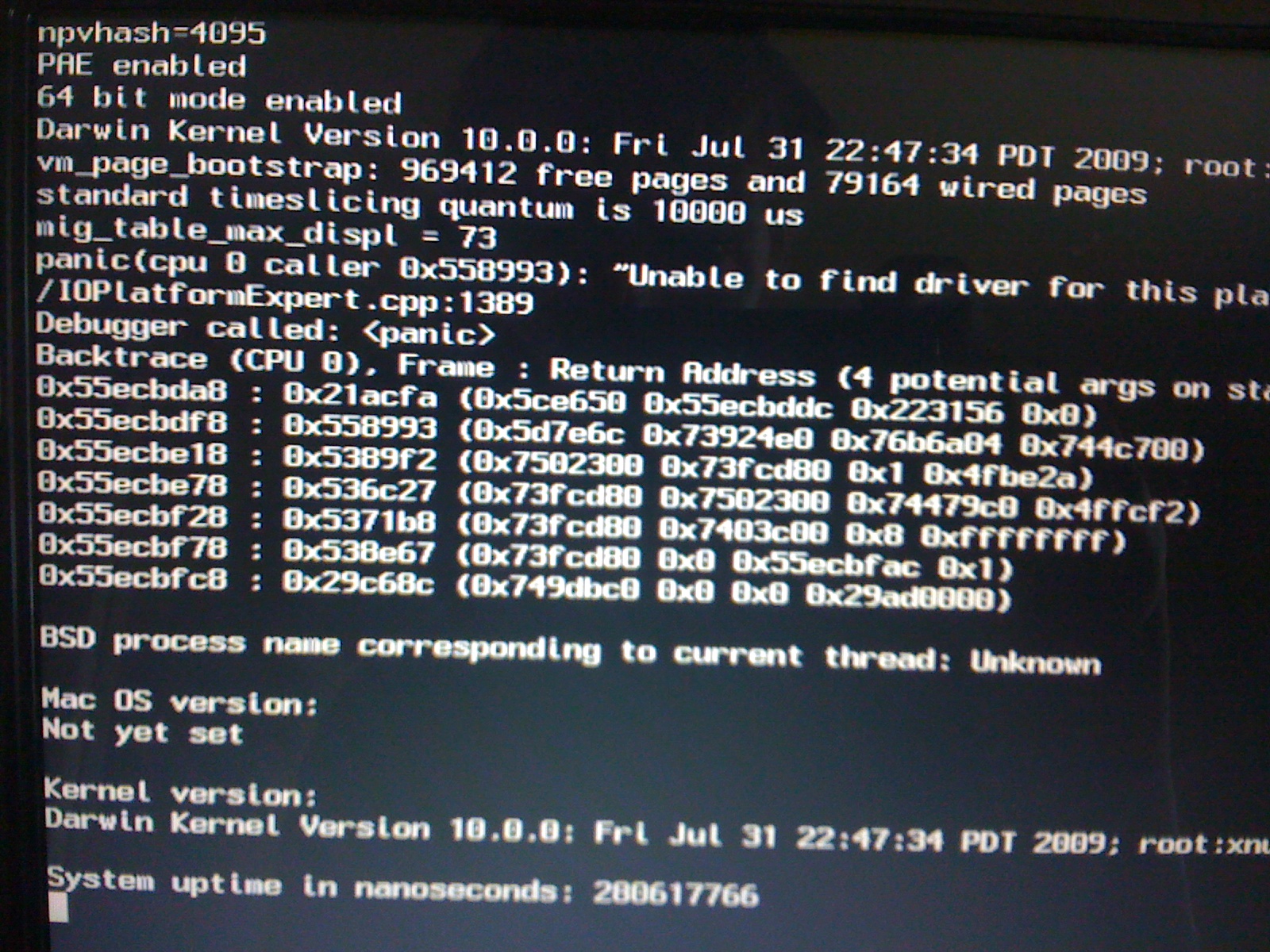

tripkip Posted September 3, 2009 Share Posted September 3, 2009 Hi all, as you can see I have a KP related to the ACPI driver. I tried: Booting with (-f -x -v) or (-v) or (-x -v) or (-f -x -v -x32) placed "AppleIntelPIIXATA.kext" in "/Extra/Extensions" Added -x32 under kernel flags. Still get this kp: Link to comment Share on other sites More sharing options...

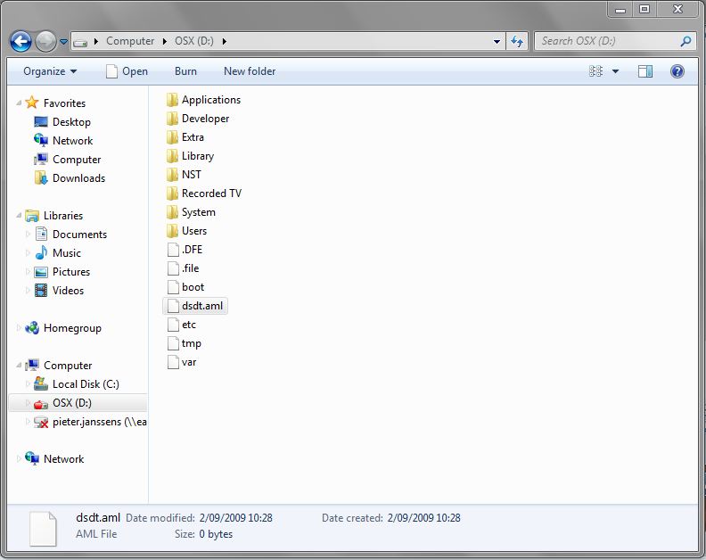

tripkip Posted September 4, 2009 Author Share Posted September 4, 2009 The DSDT.aml file in the root of the macdrive, is an empty file 0 bytes it says: Link to comment Share on other sites More sharing options...
adamsweeting Posted September 4, 2009 Share Posted September 4, 2009 There's your problem right there... DSDT file should contain a lot of info. Create your DSDT using Koala's patcher. You'll need a BIOS .bin for your MoBoard. I managed to get a SnowLeo install to boot without DSDT, but then you'll constantly get the CMOS corruption at every boot, so I used DSDT in the end. Much better as you can inject Sound and GFX without EFI strings or sound enablers = S/L/E is completely untouched. To not use DSDT you need to use Netkas' boot (10_1) file, and the correct Chameleon release. Link to comment Share on other sites More sharing options...
