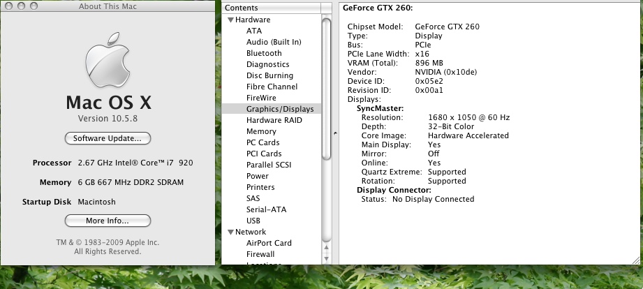

Downloaded and installed osx update 10.5.8 via Software Update. Failed to boot after restart. Simply put iAtkos install disc in, selected same install fixes as when I initially installed 10.5.7, installed them, rebooted into osx. Ethernet, sound working.
iAtkos v7 Install Fixes;
dsmos
disabler
delete tymce
ahci
voodooHDA
nvenabler
nv gt200
Intel Gigabit
(no post-install actions as this was a driver-only install, made sure nothing else was selected too)
Please respond if there is simpler way to do this next time. (Still, this was pretty easy and worked on the first try, unlike figuring out fixes for initial install)
Hope this helps other smackover users!

Yes. Once v7 is installed you can get the 10.5.8 update through ->Apple->Software Update, Install update. I think the update messes up the first install since my machine wouldn't boot after updating. All I did was re-install the driver fixes from the v7 disc, and presto! My system is down right now though because of a hardware failure, nothing related to osx86. If your hardware differs from mine then you might need different driver fixes.
