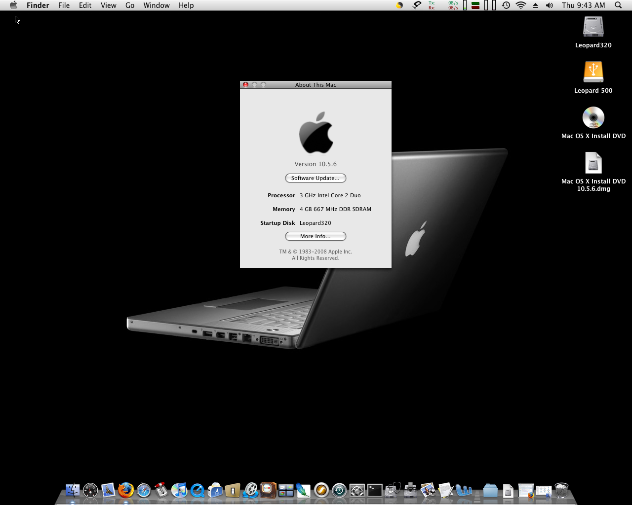

I have tried Unsuccessfully to upgrade my Kalyway Leopard from 10.5.3 to 10.5.6 Countless Times and has Always ended with a System Boot Freeze on StartUp but with the help of a Self Modified Version of LTL's Post Patcher and some Custom Kext Files for my Asus P5K-E Wifi AP Motherboard I was able to get it Done!
1.) Use Kalyway's Method to Upgrade to 10.5.3 if you are not using this Version already... (I used the Vanilla Kernel)
2.) Download and Install the 10.5.6 Combo Update from Apple (668Mb)... Do Not Reboot!!!
http://www.apple.com/downloads/macosx/appl...omboupdate.html
3.) Edit the Post-Patch.sh File Located in the v4.4 Folder with the Name of Your Leopard Install Hard Drive (Located at the Top of the Page) (Ex; Destination=yourharddrivename) Save and use the Following Command Lines to Run the Program from Terminal...
. Open Terminal
. TYPE or cut n past into Terminal: sudo -s
. enter your password
. TYPE or cut n paste into Terminal: /usr/sbin/vsdbutil -a /Volumes/Leopard320 <==== (Rename
this to your Hard Drive Volume)
. TYPE or cut n paste into Terminal (change yourusernamehere to your username):
cd /users/yourusernamehere/desktop/v4.4
. TYPE or cut n paste into Terminal: ./post-patch.sh
. after it finishes TYPE: Exit and Press Enter.
. Reboot Your PC and Press F8 at the Darwin Prompt and Type: Update -v and Hit Enter.
Download My Modified PostPatch Prog Here:
http://www.mediafire.com/?xmqblgyuggr
Congratulations you are now running Leopard 10.5.6!!! :(
3-20-09: All of the Necessary Kext Files are Included in the PostPatch Prog for Wifi, Sound, Video (Geforce 7900GS) and Ethernet for the P5K-E Wifi AP to work Perfectly after the Program has Finished Installing.
If you have Any Other Questions feel free to Ask Me... :)

Didn't work for me. I have P5K-E with Raid mode for Sata and running Kalyway 10.5.3. It crashed at 12% during 10.5.6 Combo Update installation. Could the Raid be the problem ? How did you set your Sata in Bios ?
