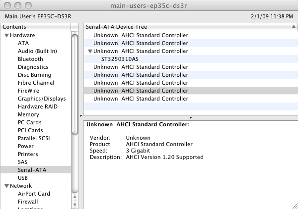

thorazine74 Posted February 1, 2009 Share Posted February 1, 2009 Also if by ports showing up on boot you mean before starting up mac os x it doesnt really matter if they dont show up inside mac in system profiler, in the serial ata section you have to have as many entries as ports you have: If all the ports show up there, but not the device, the problem might be the recorder, if you search the forum you will find some reports of troubles with sata recorders not working as they should. Link to comment https://www.insanelymac.com/forum/topic/150536-does-sata-slot-affect-osxs-ability-to-find-a-drive/#findComment-1065379 Share on other sites More sharing options...
