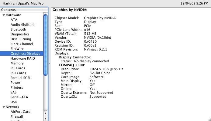

Did you get the card using only the DVI output. I've got an 8400GS 512MB and I've got it working on the VGA alone or with dual monitors on the VGA & DVI. But I can't get the thing to work properly with just a DVI output. It will work on a low res setting, but when I bump it up, I get a blue screen.
I'm using NVinject.0.2.1 and an NVCAP of 04000000 00000300 04000000 00000007 00000000.
