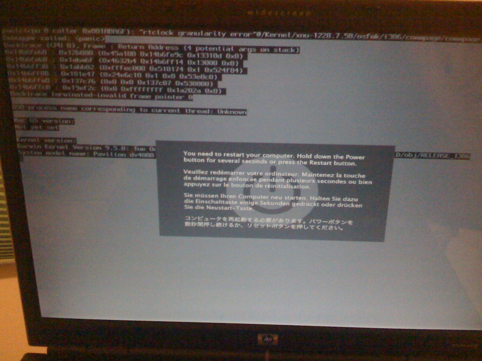

the system clock seems to be running very fast and the seconds fly by at twice normal speed. i have tried booting with busratio=16 but it does nothing. using fsb=100 causes a kernel panic.

And lastly, post a photo of the kernel panic. If it just hard freeezes, boot with flag debug=0x100 to get it show the KP message over the gui.
1. i actually used both and they resulted in the same issue. an rtc granularity error. i attached a blurry image. :-)

That's your problem. Broken ACPI reports ~2.8 Volts! That's clearly too large. Just see how your actual current voltage (at 600 MHz) is 748 mV, not 2796 mV as your ACPI is trying to have us believe.
I'm trying to find a workaround to this. Intel keeps the algorithm to calculate the voltage 'secret' ...
