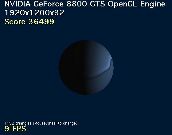

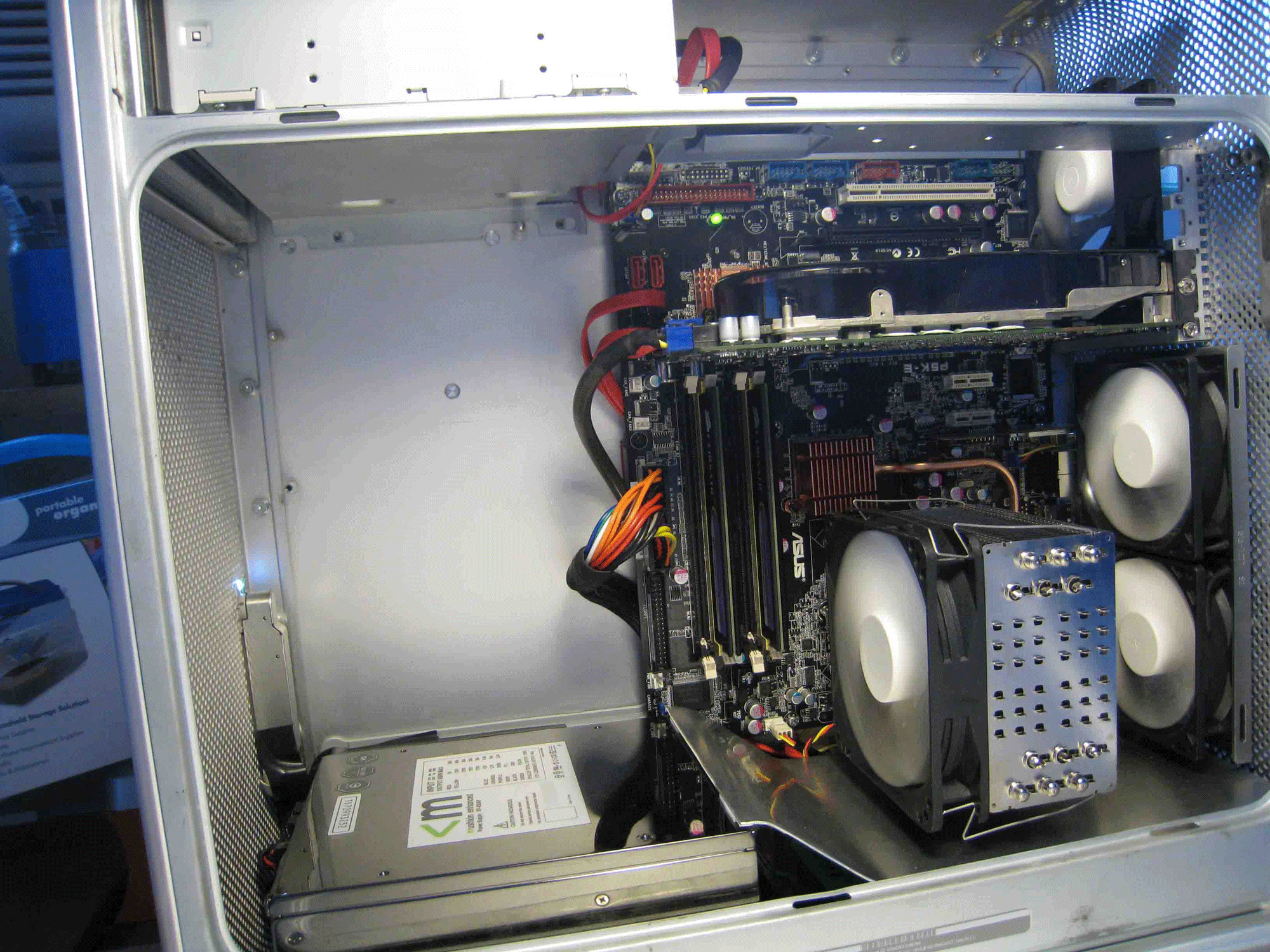

onemanstrash Posted September 27, 2008 Share Posted September 27, 2008 i saw aquamac's and others' great g5 case mods and gave this a try because I just love the look of the g5 case. My first one was hard and i was learning how to make it all work as i went. So it was not very easy (this is my second case mod ever). Also on my first mod i was just using parts i had around the house and tried to make them work. On this case i bought parts that seemed to go a bit better with the g5 case. The dvd player ejects the door just perfectly and i have access to all of the i/o ports on the mobo. lost one pci slot and 2 pci express x 1. No big deal. I really love the g5 case design and now i have two. I used a nibbler to cut out the manifold for the psu. I didn't want to cover the psu with the manifold because i like the mirror finish on the psu. I have two hard drive down there that get air blown across them and out the back from the psu. The whole rig is quiet and cool. Mobo P5K-E wifi e8400 3.0 @ 4.07 stable http://browse.geekbench.ca/geekbench2/view/79056 8800 GTS Pioneer sata DVD R/W 2x2 gigs Corsair 800 Nexus case fans(super quiet and nice sounding) ThermalRight HR-01 Plus cpu cooler Link to comment Share on other sites More sharing options...

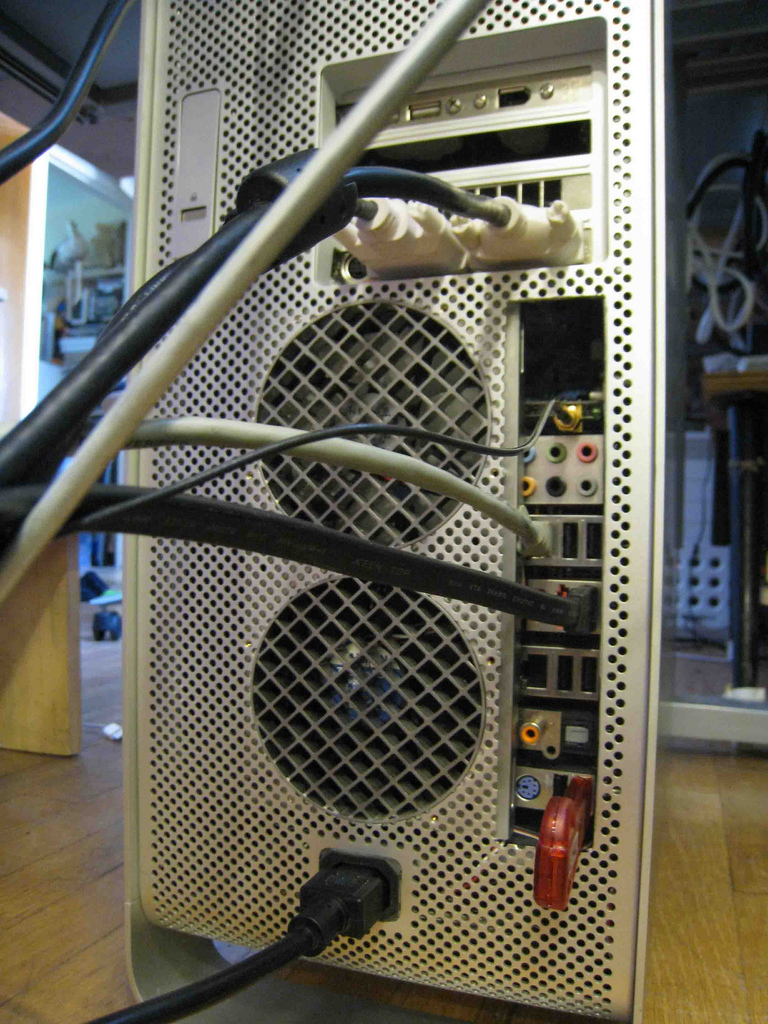

SticMAC™ Posted January 21, 2009 Share Posted January 21, 2009 Pleas show us the back?! (or are ye chickin' ) SticMAC Link to comment Share on other sites More sharing options...
onemanstrash Posted February 17, 2009 Author Share Posted February 17, 2009 hehe sticmac. I haven't been here in a while..just saw the request. Well it's nothing fancy. I just cut the solid part of the i/o plate from the g5 case using a dremel. I have access on both of my G5 cases to all of the ports on the asus boards except some of the sound, but that's not an issue as i use firewire sound cards and just the stereo out(green). Link to comment Share on other sites More sharing options...
