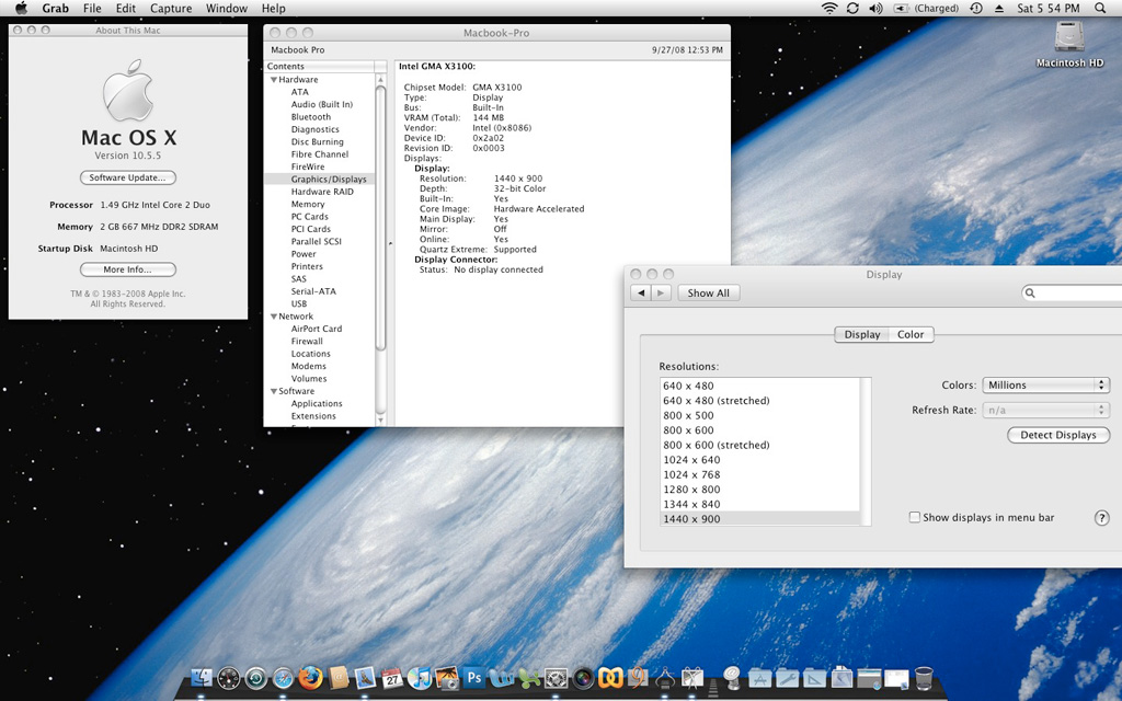

jayman30 Posted September 27, 2008 Share Posted September 27, 2008 I have full screen resolutions and hardware Quartz Extreme and core image working on my Gateway X3100 video hackintosh running Leo4All that's been upgraded to 10.5.5. I just downloaded and installed the Leopard Graphics Update found here and then installed Natit.kext (attached file) with KextHelper then rebooted. Try it out and let me know if you get it fixed. Natit.kext.zip Link to comment Share on other sites More sharing options...
raziiq Posted September 28, 2008 Author Share Posted September 28, 2008 @jayman30 Thanks for the reply but i m a newbie and dont know much abt mac. At the moment as after installing the os i cant see my deskyop as graphics are scrambled so i dont know how to install the files u r talking abt. I can boot in darwin using the bootable dvd is there anyway to install these files in darwin? Need help desparetly Link to comment Share on other sites More sharing options...
jayman30 Posted September 28, 2008 Share Posted September 28, 2008 @jayman30Thanks for the reply but i m a newbie and dont know much abt mac. At the moment as after installing the os i cant see my deskyop as graphics are scrambled so i dont know how to install the files u r talking abt. I can boot in darwin using the bootable dvd is there anyway to install these files in darwin? Need help desparetly You should first try booting with a -x flag at the darwin prompt, that will boot you into safe mode if your screen isn't scrambled, you can then try the method I outlined in my first post. To manually delete all X3100 kexts and driver bundles, boot with -s flag at the Darwin prompt and, after you get to a command prompt, type: (hit return after each command) sudo bash cd /System/Library/Extensions rm -rf AppleIntelGMAX3100.kext rm -rf AppleIntelGMAX3100FB.kext rm -rf AppleIntelGMAX3100FB.kext rm -rf AppleIntelGMAX3100GA.plugin rm -rf AppleIntelGMAX3100GLDriver.bundle rm -rf AppleIntelGMAX3100VADriver.bundle rm -rf AppleIntelIntegratedFrameBuffer.kext rm -rf Natit.kext reboot Note: Not all these files may be present in your particular installation. But removing the files that are present should allow you to boot to the desktop in standard 1024x768 mode with no resolutions options or QE/CI It would probably be easier for you to just reinstall OSX and not select the GMA and X3100 graphic options so you can at least get to the desktop in 1024x768 mode then try the method I posted about earlier. Good Luck Link to comment Share on other sites More sharing options...
