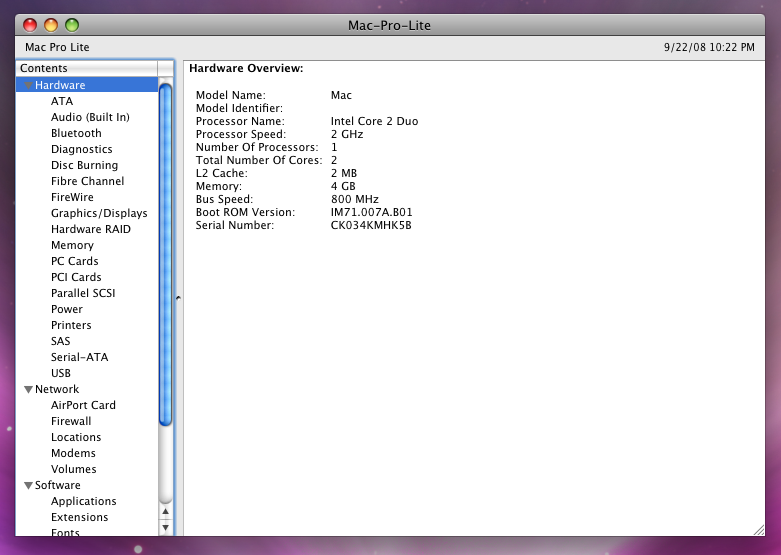

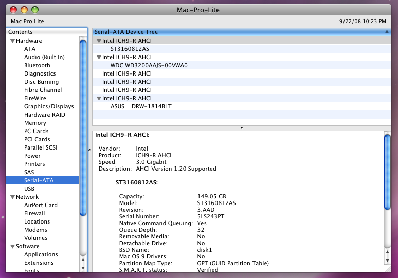

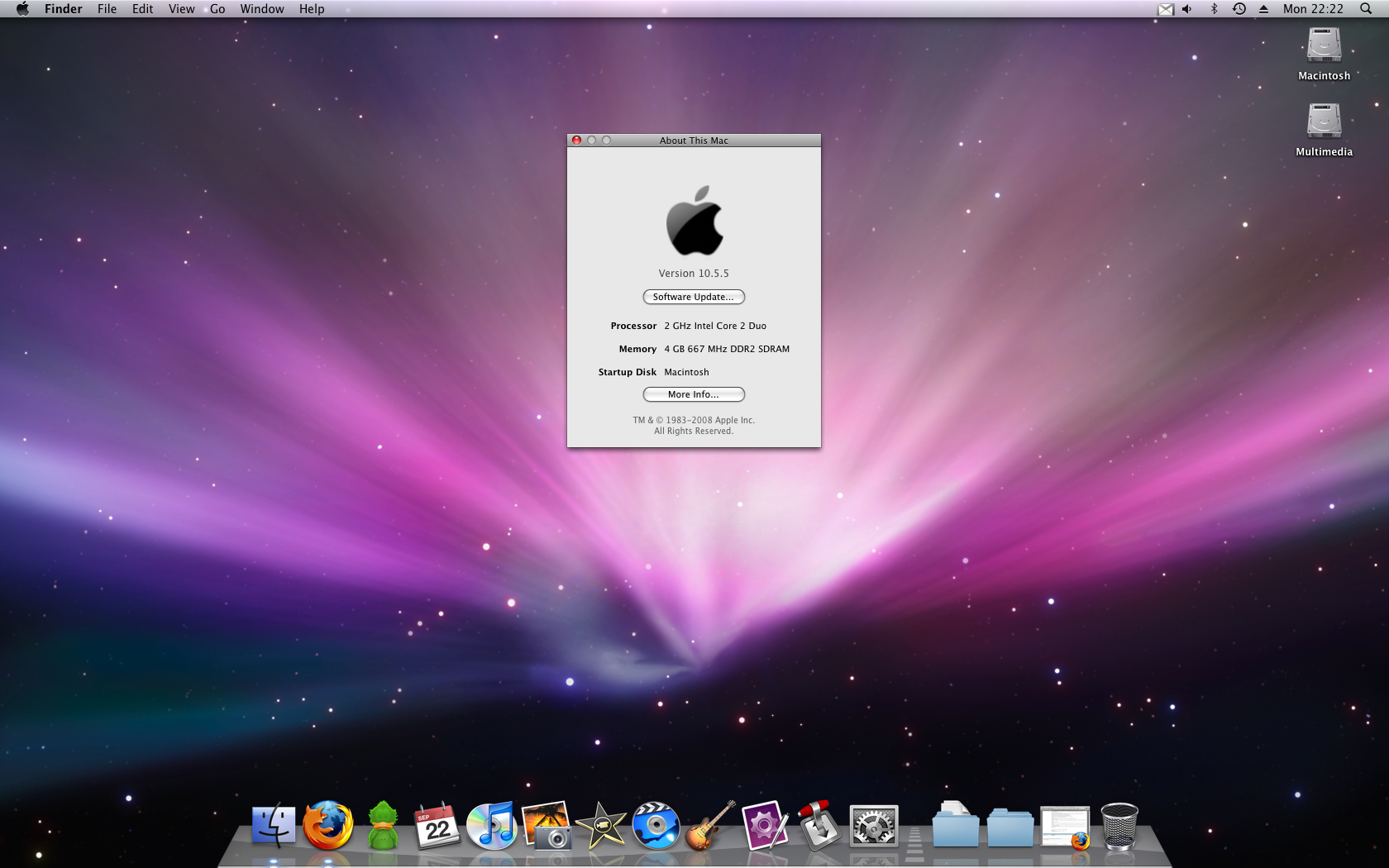

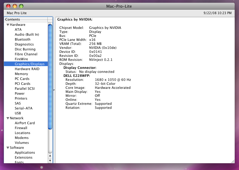

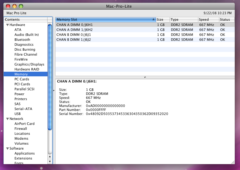

HiDDeNN Posted September 22, 2008 Share Posted September 22, 2008 Hello all, I have an Intel DP35DP mobo running 10.5.5 perfectly (with vanilla kernel, this is the original from Apple). I use it primarily for web development, music recording (GarageBand and Logic Audio) and video editing (iMovie '08 and Final Cut). What is not working: - Sleep. Until everything is installed and ready, be sure to deactivate automatic sleep, because I have not get it to work Things you will need: - DS3L-Package by weaksauce12. You can find it in this thread: http://forum.insanelymac.com/index.php?showtopic=112708 (download the 58.3 MB package, this is the direct link if you don't want to search: http://rapidshare.com/files/131245992/DS3L-Package.zip.html) - Kalyway 10.5.3 ComboUpdate. You can find it in torrent search engines. - Apple's 10.5.4 delta update: http://www.apple.com/support/downloads/macosx1054update.html - Apple's 10.5.5 delta update: http://www.apple.com/support/downloads/macosx1055update.html - The audio drivers that I'm attaching to this post. - A cheap Realtek network PCI card (the onboard chipset is not working yet). Procedure: - I personally started with AHCI disabled from BIOS. Some other interesting things could be enabling UEFI and xD technology also in BIOS. - Boot your PC with the Kalyway 10.5.2 DVD in your DVD drive and enter the installation program. - Prepare your disk with Disk Utility, with GUID partition type (you have to work this out in the partition tab). - Press the "Customize" button and select the packages you need to install. Basically, deactivate everything except for this: - "Kernel 9.2 vanilla" under "Kernels" - "AppleOnboardPCATA" and "AppleGenericPCATA" under "Motherboard chipsets" - "Lastnetkassmbios" under "Hardcoded_SMBIOS", "PCGenUSB Fix" and "TimeMachineFix" under "Other Patches" - So, you don't need to install networking, video nor audio at this time. - Start the installation and wait for it to restart. - When system restarts, don't extract the DVD, because the boot loader is still not working. Just bypass the installation question, let the 4 seconds to pass... and it will boot from the hard disk. - After the welcome animation, configure your system. - Open terminal and type: - sudo -s - diskutil list - Pay attention to the identifier of the just installed partition - fdisk -e /dev/rdisk1 (if disk is 1) - f 2 (if the partition is 2) - w (write changes) - q (exit) - Extract the DVD and reboot (when you see the waiting indicator on the screen, press the reset button of your PC, as it will not reboot automatically until we install the corresponding driver, this is called 'hard reset'). - Install 10.5.3 update, but DO NOT when it tells, just keep the window open. - Install the 10.5.3 patch that comes in the same package (select kernel 9.3 vanilla), and now you can restart (hard reset again). - When the darwin bootloader appears, press some key and type this: update -v - It will boot 2 times after showing some Firewire errors. This is normal. - When you get to the desktop again, install the 10.5.4 update, and again DO NOT reboot yet. - In DS3L-Package install Vanilla / AppleACPIPlatform.kext with Kexthelper - Install CHUD.pkg - Go to your hard drive and browse to Developer > Extras > PreferencesPanes and install "Processor.prefPane" (for all users). - Install PowerOff bug fix. - Now you can reboot (hard reset again). - Open "Kext files" folder and install all kext with Kexthelper (except for the bluetooth ones, as Bluetooth works perfectly for me without these drivers), and reboot (now it WILL reboot automatically). - Activate AHCI in BIOS (if it doesn't boot once you do this, let it to IDE). - Install the 2 kext of the audio zip I'm attaching to this post with some Kexthelper. - Install the video driver inside DS3L-Package (NVinstaller). - Reboot. - Install updates from the Software Update (DO NOT install 10.5.5 updates or higher) and reboot. - Open terminal and type: - while sleep 1 ; do sudo rm -rf /System/Library/Extensions/ AppleIntelCPUPowerManagement.kext ; done (put your password when it asks for it). - Install the 10.5.5 update. - Reboot: - I personally get a kernel panic, black screen asking to reboot with a hard reset. If you do it, it will restart 2 times in a somewhat long process. - You will get to the desktop and you will have to reinstall again the files inside the "Kext Files" folder from the DS3L-Package, as well as the audio drivers and reboot. - Once the system is booted, you will have to wait until Spotlight indexes everything again. Otherwise you will see that the system is less responsive... - End! Now you have a fast and perfect Leopard 10.5.5 Some screenshots... DP35DP_audio.zip Link to comment Share on other sites More sharing options...
