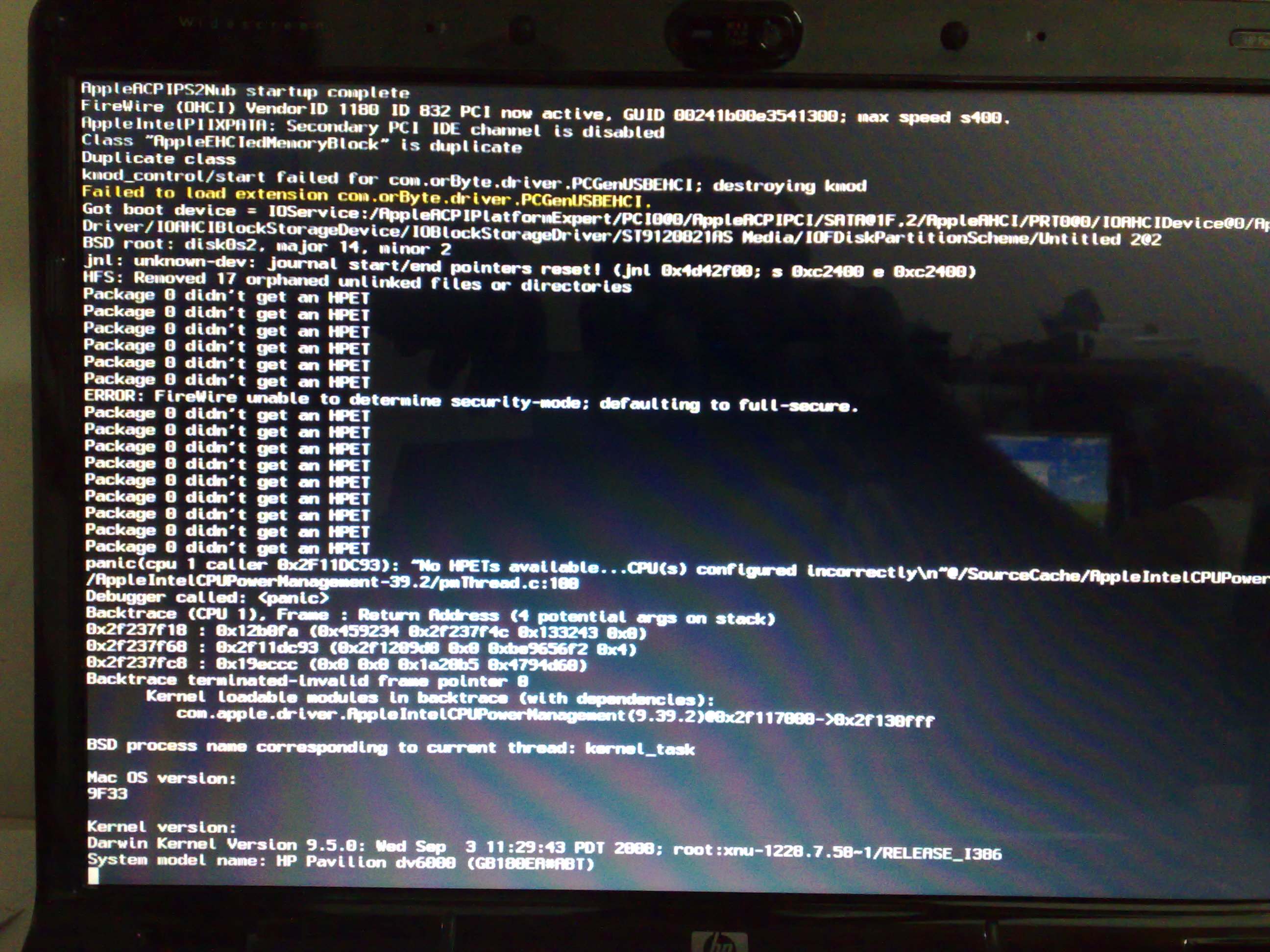

tm81 Posted September 17, 2008 Share Posted September 17, 2008 hi i tried to update from 10.4.5 to 10.5.5 throw the apple update in the middle of the update its crashed, and now i get something with kernel see the attached picture anyone knows how to fix it? Link to comment https://www.insanelymac.com/forum/topic/126592-problem-updating-to-1055/ Share on other sites More sharing options...
overflow1972 Posted September 17, 2008 Share Posted September 17, 2008 Delete the AppleIntelCPUpowermanagement kext. Regards Link to comment https://www.insanelymac.com/forum/topic/126592-problem-updating-to-1055/#findComment-895068 Share on other sites More sharing options...

tm81 Posted September 18, 2008 Author Share Posted September 18, 2008 i tried to delete the AppleIntelCPUpowermanagement kext but it didnt worked Link to comment https://www.insanelymac.com/forum/topic/126592-problem-updating-to-1055/#findComment-896321 Share on other sites More sharing options...
tm81 Posted September 18, 2008 Author Share Posted September 18, 2008 ok, i take it back i have deleted the AppleIntelCPUpowermanagement kext and my pc dont stack anymore , but it also dont work like it should what do i need to know maybe i need to get an older AppleIntelCPUpowermanagement kext file ? Link to comment https://www.insanelymac.com/forum/topic/126592-problem-updating-to-1055/#findComment-896371 Share on other sites More sharing options...
