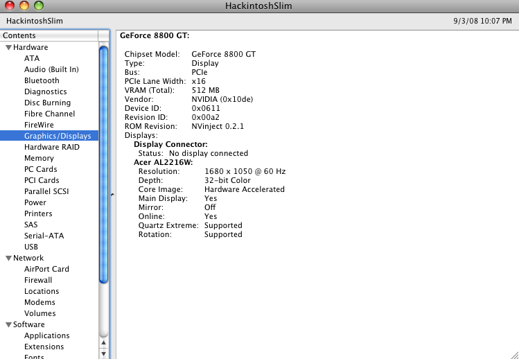

Im exceptionally pleased with my build seeing that everything is stable. The only problem are some small inconsistencies. One of those is when I start the Doom 3 Demo I get audio, but no visual of any kind. Also, when I apple-Q out of the program I still have no functional display.
I'm using nvinject 0.2.1 with the nvkush fix for quartz extreme.
Here is my graphics info page

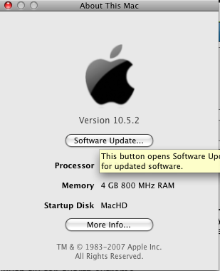

here you can see my processor is an unknown (Q9450) and my ram shows ddr2 800, when it is set to ddr2 1066 in the bios.

Try switching the cable from the monitor connecting to the video card to the other port it looks like you have it on the second one instead of the first.
Edit: You might want to consider updating to 10.5.4 too as there was a graphic update in there that included upgrades for the 8800GT driver.
Switching to the other port did the trick! thanks for ctching that
