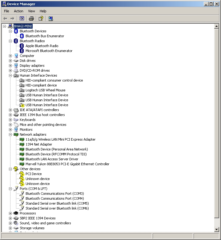

bhagiratha Posted March 22, 2006 Share Posted March 22, 2006 It's now 1:27am and I got successful in getting my bluetooth device to work on my intel mac mini core duo. You can get to see a pic of the Device Manager on my system here: http://homepage.mac.com/bhagiratha/xp_on_m...otoAlbum27.html thanks guys Link to comment https://www.insanelymac.com/forum/topic/12293-bluetooth-fix/#findComment-80713 Share on other sites More sharing options...
