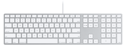

yusa2812 Posted July 27, 2008 Share Posted July 27, 2008 Hello, my Apple Aluminium Keyboard doesn't work in my Hack Mac, Im on 10.5.3 Zephyroth and Leo4All 10.5.2 doesn't too !!!! Model Identifier: MS-7309 Processor Name: AMD Athlon™ 64 X2 Dual Core Processor 5200+ Processor Speed: 2.73 GHz Number Of Processors: 2 Total Number Of Cores: 2 L2 Cache: 512 KB CPU Features: CMOV PAT PSE36 CLFSH MMX FXSR SSE SSE2 HTT SSE3 CX16 Memory: 4 GB Bus Speed: 200 MHz Any ideas about how can fix this issue.... ????? the regular white Apple Keyboard is working fine !!!!! THANKS IN ADVANCE !!!!! :( :( :( :( :( :( :( :( :([/font] Link to comment https://www.insanelymac.com/forum/topic/117895-apple-aluminium-keyboard-doesnt-work-in-my-hack-mac-im-on-1053-zephyroth-and-leo4all-1052-doesnt-too/ Share on other sites More sharing options...
