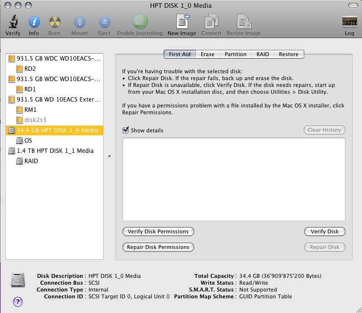

rsandru Posted September 25, 2008 Share Posted September 25, 2008 In case anybody's interested, I've successfully set up a server around the Highpoint RocketRaid 2320 card. I chose that card because of the low price and OS X driver availability :-) Components: - Asus P5WD2-Deluxe (i955X) motherboard - 4GB RAM - Highpoint RocketRaid 2320 controller - 2x36GB WD Raptor - 4x500GB WD RE II - JaS 10.5.4 The plan was to have the OS installed on and boot from a RAID 1 made using the two 36GB drives and have a data drive in RAID 5 using the four 500GB disks. Here's what I did: 1) Added the RocketRaid drivers to the installation DVD... - Grab the driver installation files from http://www.hptmac.com - Extract the rr2320.kext file from the dmg (open the DMG, look in the rr232x.pkg, grab the .pax file, extract and you'll have the .kext) - Open the JaS ISO file and copy the /System/Library/Extensions.mkext file to your harddisk (create a directory and place it in, we'll extract its contents in a second) - From a Shell prompt, unpack the Extensions.mkext file: # sudo su - # cd <directory where Extensions.mkext file was copied to> # mkextunpack -d . Extensions.mkext - Copied the rr2320.kext file to the above directory - Rebuilt the kext cache: # kextcache -m Extensions.kext <directory name> - Replaced the Extensions.mkext file on the DVD and burned it to a disc Optional: Add a copy of the rr2320.kext file to the DVD root, we'll need it later. Otherwise we'll extract it from the mkext again. 2) Install OS - Powered up system, created the RAID 1 array - Booted from JaS DVD - Disk Utility can now see the RAID 1 array. I've partitioned it as HFS+J and proceeded with the installation... - When installation was completed (and during the 30s countdown), opened up a Terminal window 3) Patched OS to include RocketRaid driver Freshly installed OS needs the kext too so I've simply grabbed again the Extensions.mkext file again from the DVD, copied it to a temporary folder on the RAID Volume, unpacked it and copied the rr2320.kext file to the /System/Library/Extensions folder. I could've placed a copy of the kext on the DVD too, but I forgot to do it and didn't want to burn the disc again Don't forget to delete the /System/Library/Extensions.mkext cache on the RAID volume Reboot... I hope this helps - see attached picture. Please also read this (this is how I got started): http://forum.insanelymac.com/index.php?showtopic=66345 Link to comment Share on other sites More sharing options...

rsandru Posted September 28, 2008 Share Posted September 28, 2008 rsandru, Thanks for the info - what are performance numbers like? Have you benched RAID 0? Hi Vlad! Sorry but I've got no spare drives to try a RAID 0 - my boot volume is a RAID 1 made using my old 36GB Raptors so compared to the more recent drives they probably won't shine in terms of performance. If you'd still like RAID 1 or RAID 5 numbers, please let me know what benchmark you'd like me to run! Kind regards, Robert Link to comment Share on other sites More sharing options...
