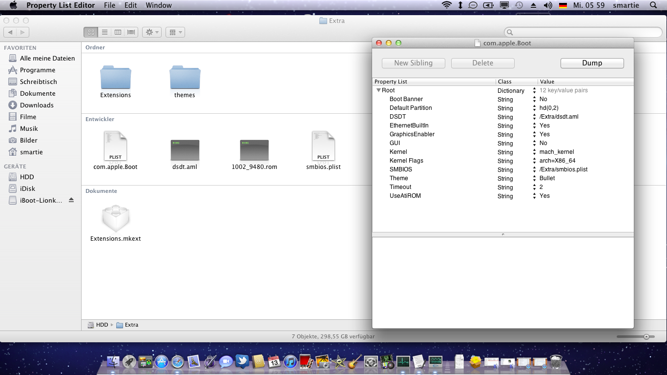

2. When you are now in Stage2 , after OSX is installed on local HDD, install a recent Chameleon Bootloader , see above.
EXTRA folder ( updated 17 August 2011 with fixed DSDT
3. again make your hidden files visible, EXTRACT THIS "Extra" folder and PUT THE WHOLE EXTRA its contents in the root directory ( / ):
Notice regarding smbios ( Mac Model ID )
the SMBIOS IS NOW THE MBP5,1 one , use the modded AppleGraphicsPowermanagement.kext to turn on support for the Ati Fansettings. MBP is best for laptop fucntions, Core2Duo speedstep and just "fits" a laptop way better then "iMac" ( which I used before all the time ).
What's inside the "Extra" :
It contains the ROM ( BIOS ) of the ATI card, do not remove this and do not rename that, kexts for the ICH9 chipset AHCI identifiers,fakesmc and nullcpupowermanagement, a SMBIOS that will fake your Toshiba to be a MBP5,1 + modded kext so MBP works in fact with iMac speedstep ( for Ati card which is needed ) .

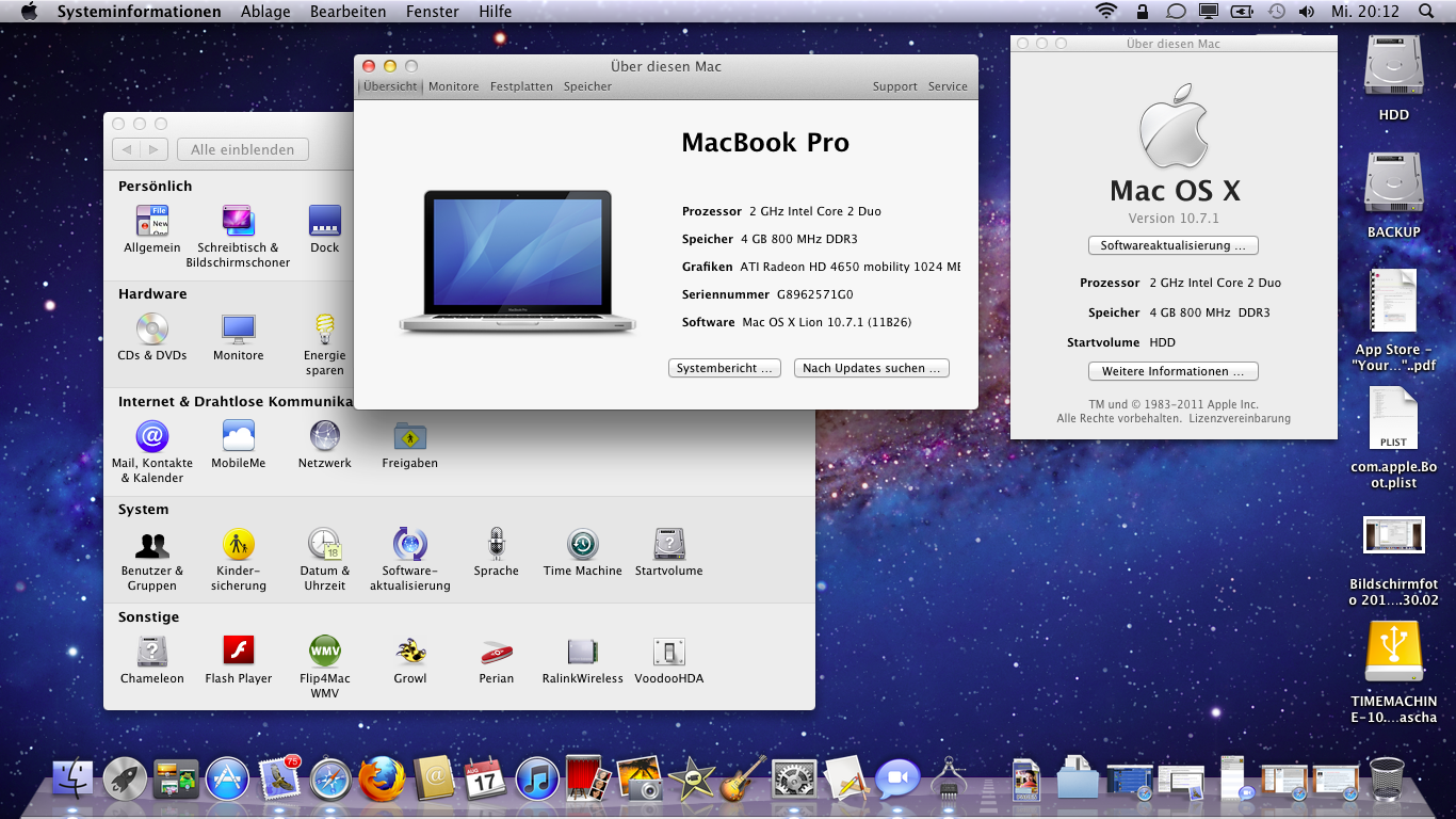

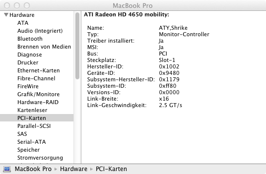

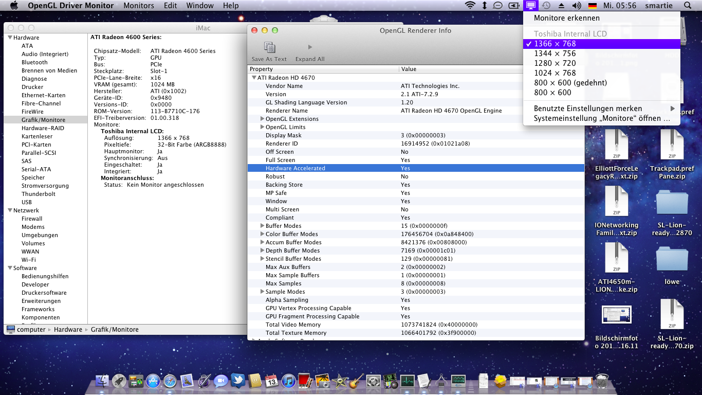

GRAPHICS : ATI mobility Radeon HD 4650
the L500 uses the "Shrike" Framebuffer to signal screen on the internal LVDS connected 15,6inch . The device ID of the card is 9480 and with this kexts it will work at a max of 1366x768 ( Toshiba L500 native resolution ). Display can be configured via Systemsettings, all modes down to 800x600 are available.
In order to have Quartz Extreme ( QE ), Core Image (CI ) and OpenGL acceleration, you need to have this modified ATY_init in /S/L/E, it will not work in Snow and not with other cards.
these are the kexts from 10.7.1, they work in 10.7 also. The included Powermanager kext is modded to work with the MBP5,1 SMBIOS ( also in my Extra folder ) .

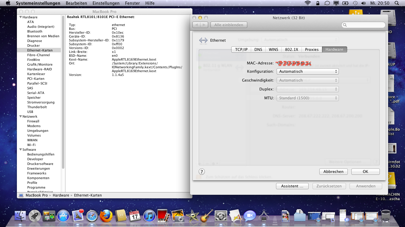

LAN
- LAN , REALTEK 8101E/EL :
Official drivers from Realtek , Snow leo version works in Lion - go here to official site, select OS : "other" to see mac os x.
or use this pre-made kext which has the driver applied already as a plugin:

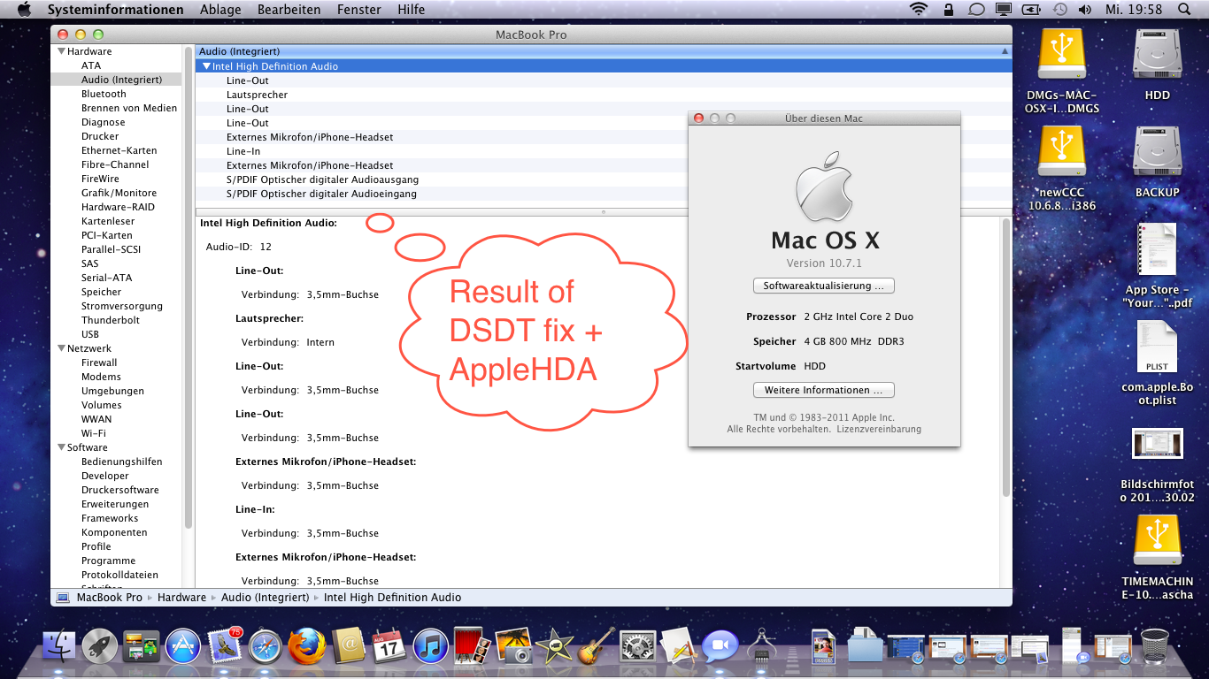

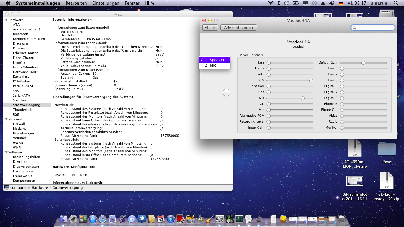

AUDIO : REALTEK HDA ALC727
- Option 1 : VOODOOHDA SOUND + PREFPANE , delete original AppleHDA.kext before ( this kext is for Alc727 Realtek/Intel HDA )[/b][/color] SOUND.zip -- this includes a prefpane for Systemsettings, copy the prefpane to
/Library/Prefpanes -- after repairing permissions and reboot you can use it
- Option 2 : We now have a working SL+Lion working APPLEHDA sound kext for the L500's ALC727 - you can take this instead of the generic VoodooHDA, needs Pin configuration in Section HDEF of DSDT, see: AppleHDA

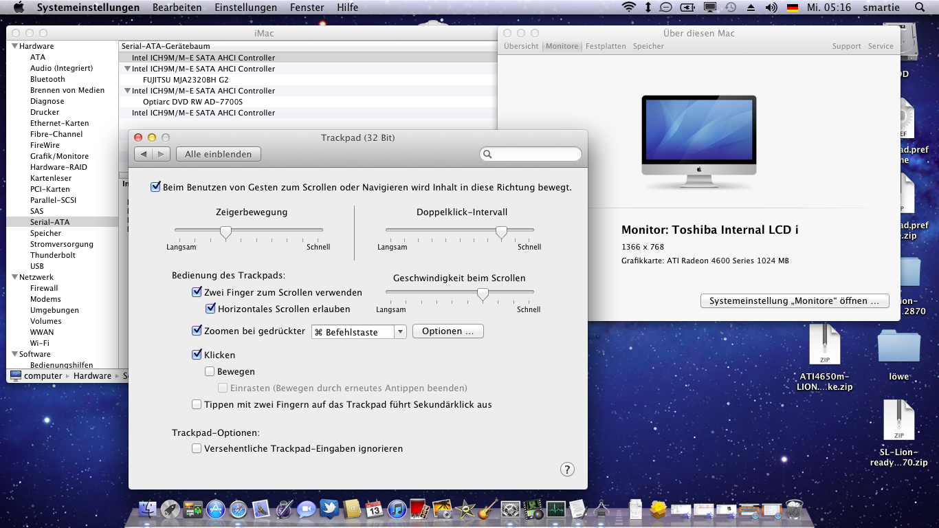

PS2 Keyboard and scrolling/clicking Synaptics TrackPad
APPLEPS2.kext + APPLEACPIPS2NUB + PREFPANE
-- this includes a Trackpad prefpane for tap to click, scrolling , two fingers and so on , kexts in /S/L/E, copy prefpane to /Librar/Prefpanes, BUT do not replace the "trackpad.prefpane" of OSX ( in /S/L/prefpanes )
- working function keys : Brightness up/down = FN+F6,FN+F7. Disable Trackpad= FN+F9 Mute Sound Multimedia Key , Volume slider on front. All ok

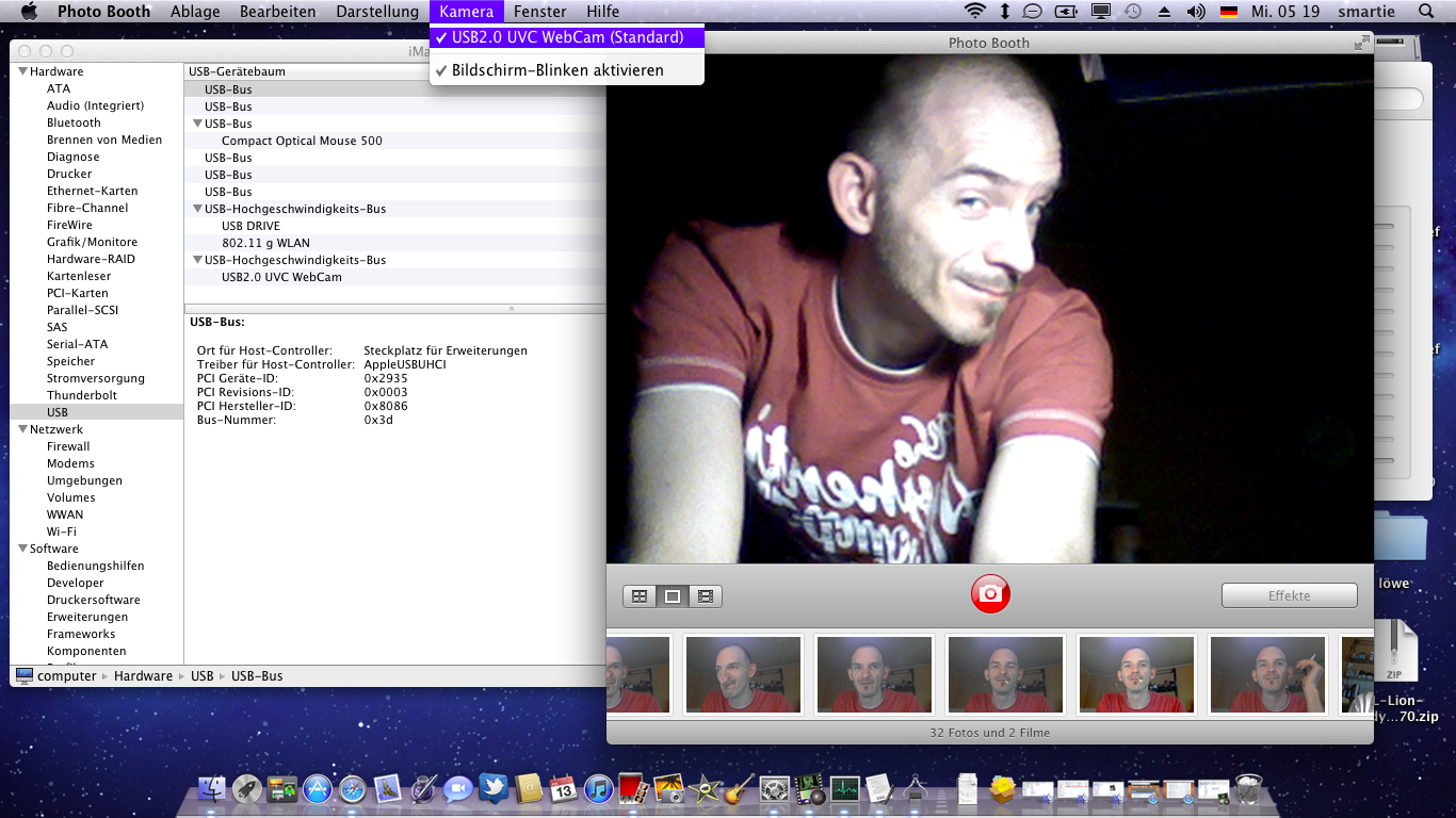

TOSHIBAS UVC WEBCAM
- UVC 1.3 MP Webcam internal "Chicony" is the vendor : no kext needed - but to make it work in Photobooth,ichat,QuicktimeX you must FIRST launch the Apple apps, THEN launch cam twist , OR "Cameracontroll.app" from NETKAS ( does basically the same as Camtwist, but might be easier )
If you know Automator you can use that to click together a workflow like "open photobooth", "launch CameraControll" "Quit Cameracontrol". save as a new application, give it a name like "fixed photobooth.app" and in future you can launch that and have the cam autoloaded in Photobooth. ;)
The only application that instantly works with any internal uvc is "EvoCam" , that does not need any cam twist hacks. Comercial, cannot share.

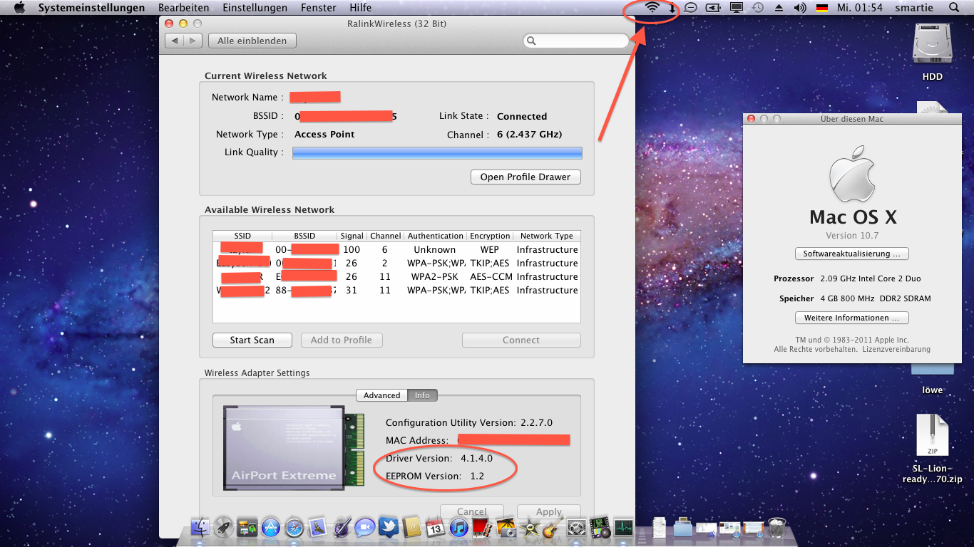

WIFI ( internal does not work,needs replacement like this : )
- WiFi USB RALINK RT2870/2770 aka SITECOM WL-608 , this small and cheap ( 10 euro ) thing here : sitcom product page : Ralink has official software ( included ) but the utility does not play nice with Lion. I found a tool here on insanelymac that is operable via prefpane ( 32bit but works ):
set the airport like tool to autolaunch on login , either that or the official utility but not both at once - the included Kext is the latest 32/64 and works with SL and Lion good :

OK.. I have 4GB of RAM and I have an Intel Core 2 Quad. I have vendor 1002 and Decide ID 9480, but when I try to activate QE/CI my monitor is divided into 4 parts and I see the same thing...
This is an image http://imageshack.us/f/135/img0025aj.jpg/
As you can see from the image the QE/CI are enabled
How can i fix it?
that is Snow Leo that you use ?
Are you using Snow Leo ATI Kexts for it or the ones from this LION thread ?
ATI kexts from 10.6.8 are version 1.6.36
ATI kexts from 10.7 are version 7.2.9
for Snow use only the correct files, have a look at my Snow section, there is also a compatible ATY_init.
: http://www.insanelymac.com/forum/index.php?showtopic=260786
Is your maximum screen size 1366x768 ? ( 15,6 inch screen ? )

device in slot 1 is the graphics , yes.
For Lion you need a newer chameleon booter and you cannot use the SL ATI and/or ATY_init kexts, you need the ones from here - only these are working in Lion . The old ones from my Snow solution is not working in Lion.
( fakesmc,nullcpupowermanagement,voodoohda is still same as SL ).
You can go with the shrike.modded chameleon from here, or use any newer chameleon/chimera/pc-efi that is Lion compatible if you like ATY_init better as solution.
black screen or ""device in slot 1" with nothing happening is typically a Framebuffer problem :
used ATY_init and GraphicsEnabler=Yes = don't works, only one - init OR GE..
Have used a ATY_init from somewhere else ? Then you are not using Shrike but Motmot or Vervet FB .. mine have Shrike ( for Laptop LVDS )..
have used Apples stock ATI*.kexts and not these here ? Apples kexts cannot output to LVDS, only these here..
have a look into that possible issues. Also check that device ids in kexts are ok and that driver version is starting with a 7.2.9 or 7.4.9 ( SL has 1.6.26 and 1.6.36 kexts ).
to temporary be able to get to the desktop = remove all ATI.kexts from /S/L/E in single user mode ( boot with -s ). that gives a generic frame buffer at 1024x768. But you are then inside OSX again and can change kexts.

Thanks for your reply.
yes i used your kext, ATI_init, with a non edidet boot file, your last ati46xx kext for lion 32/64 bit and i booted with GraphicsEnabler=No cpus=1 (i used in SL a legacy kernell for dual core) npci=0x2000 -v
i installed the latest chameleon i think, following your link in this topic
and i also changed the smbios and the atipowermanagement as you explain
Should i delete radeonHD? is in S/L/E since snowleopard for making the 4650 to work.
Ok, this explains everything.. Away with "radeonhd",yes.
My guides/topics always propose that you are NOT using radeonHD ( or for that matter any other Ati.kext replacements ) radeonHD is a replacement for the shrike frame buffer. In Lion ATIs own frame buffer is located inside ATI4600controller so it cannot work together. AtiRadeonX2000.kext ( which is for QE/CI )and the bundles won't load when not the original shrike fb inside ATi4600controller is used.
