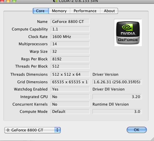

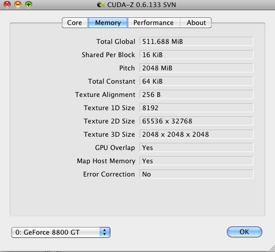

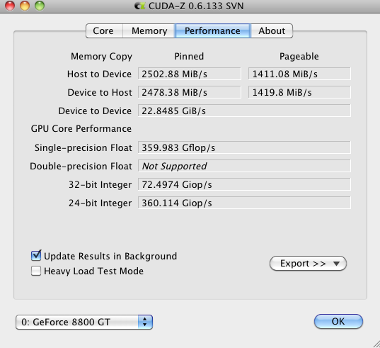

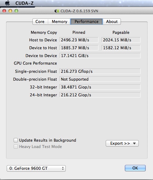

Hi,
some OS X Apps already use CUDA (must be installed extra, Nvidia gpus only!!) , like Squeeze 7, Mathematica, Toast 11 for h.264 encoding export also.
I found an great CUDA-Z Tool which shows much informations and also has an small benchmarks (VRAM speed, PCI-E VRAM Speed,..) within.
EDIT: New Beta 0.11.259 Version available!

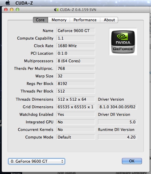

Added DL Link and new screenshoots of my 9600GT / 10.8.2
New version shows more details about CUDA and gpu card.
GPU GHz + VRAM GHz are max+fixed values (like using OpenCL info) and can´t be used to check AGPM.
http://sourceforge.n...es/cuda-z/Beta/

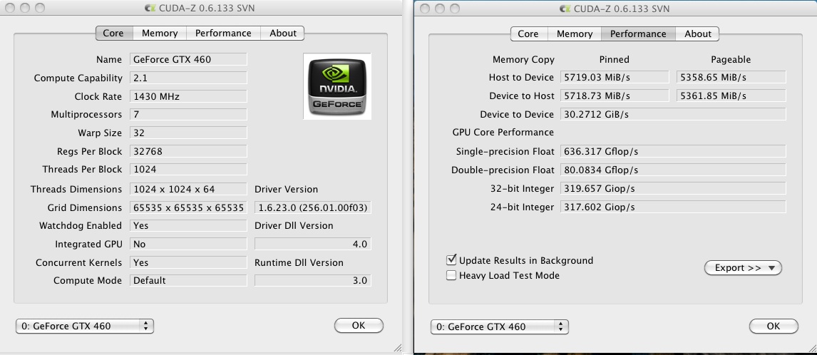

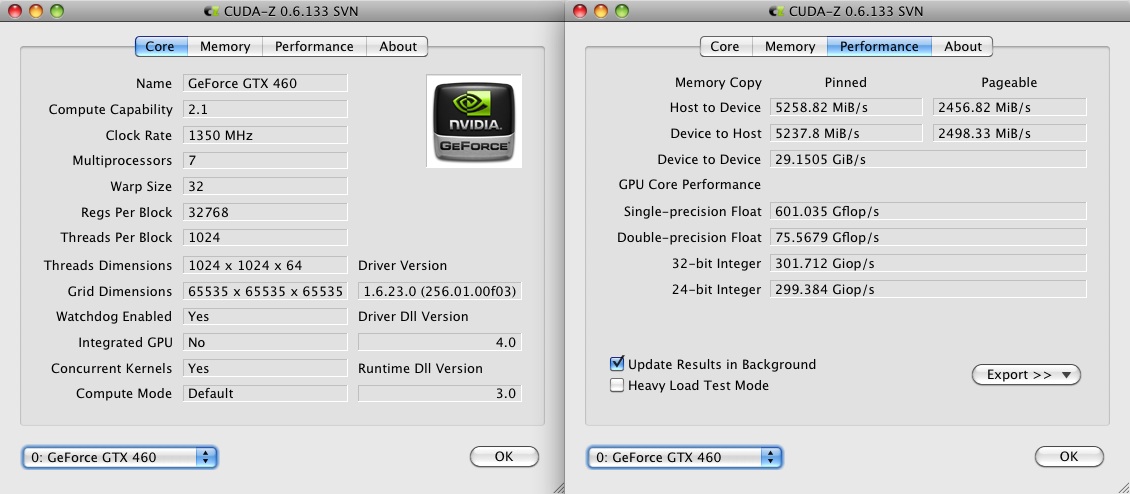

In diff to OpenCL , GTX4xx card should run CUDA (withz newest CUDA drivers) also with OS X 10.6.x. Would be nice to see some CUDA GTX4xx SL basic benchmark values (Gigaflops + memory copy speeds / VRAM speed (dev to dev speed).
For mitch.
1GB ASUS ENGTX460 on 10.6.7, latest Quadro 4000 drivers, CUDA driver and SDK installed.

Your GTX 460 is clocked higher than mine - compare:
Your extra 80 Mhz = nice g1g4fl0pz boost.
And look at your pageable memory copy, that's crazy...it's more than twice as fast as mine!
You: Core i7, memory controller is part of the CPU, DDR3
Me: Core 2 Duo, P45 chipset, DDR2
*lmao* yeah that's depressing alright.

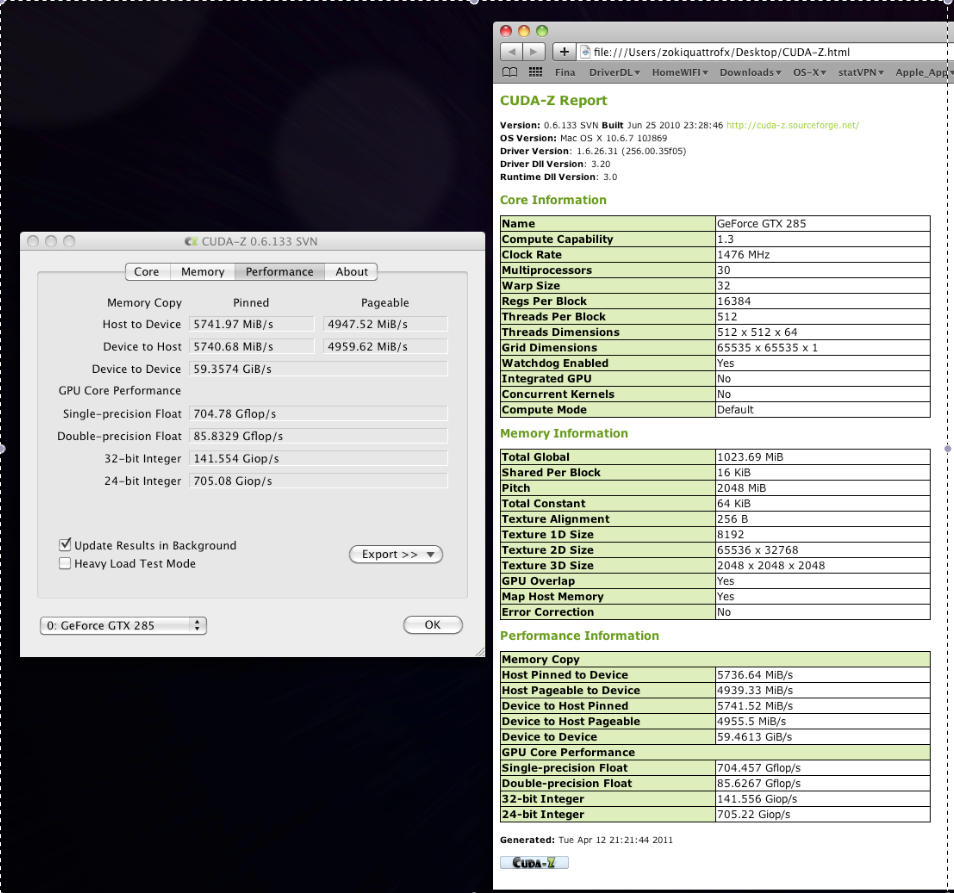

I just kept scrolling down and down and down.. until my E8500 finally appeared waaaaay down at the end. ;)
The fastest CPU on that list that would work in my motherboard is the Intel Core 2 Extreme X9750 - interestingly, its clock frequency is 3.16 GHz just like my E8500, but it scores in the low 5000s - almost twice as much as the E8500. I wonder if there's more to it than the two extra cores.
I can't find it for sale online, which is probably for the best, I'm sure it costs a million dollah..
