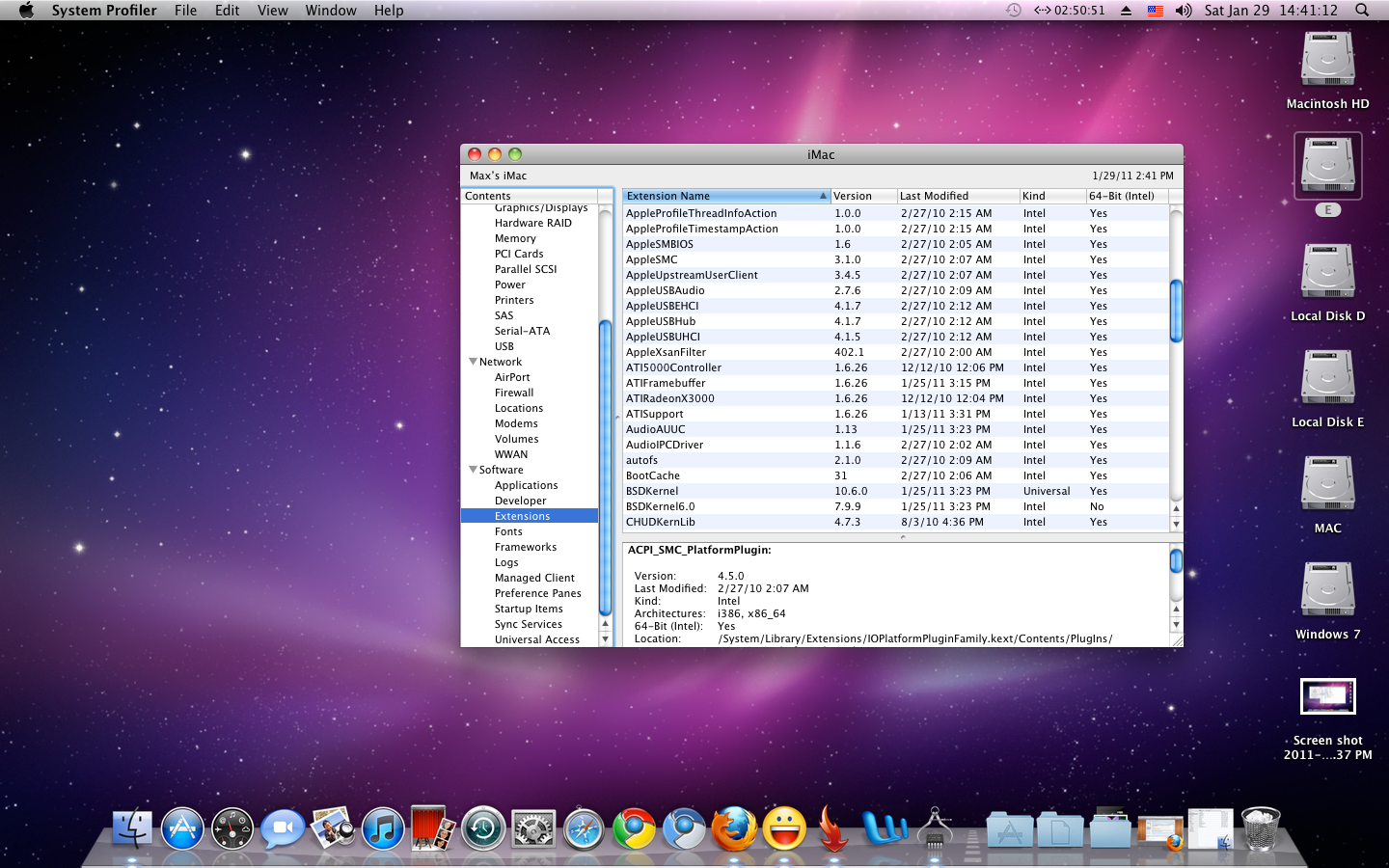

post-690732-1298697049_thumb.pngATI 5450 is 68f9
ATY_init.kext not support 5450 so it will display the 5500

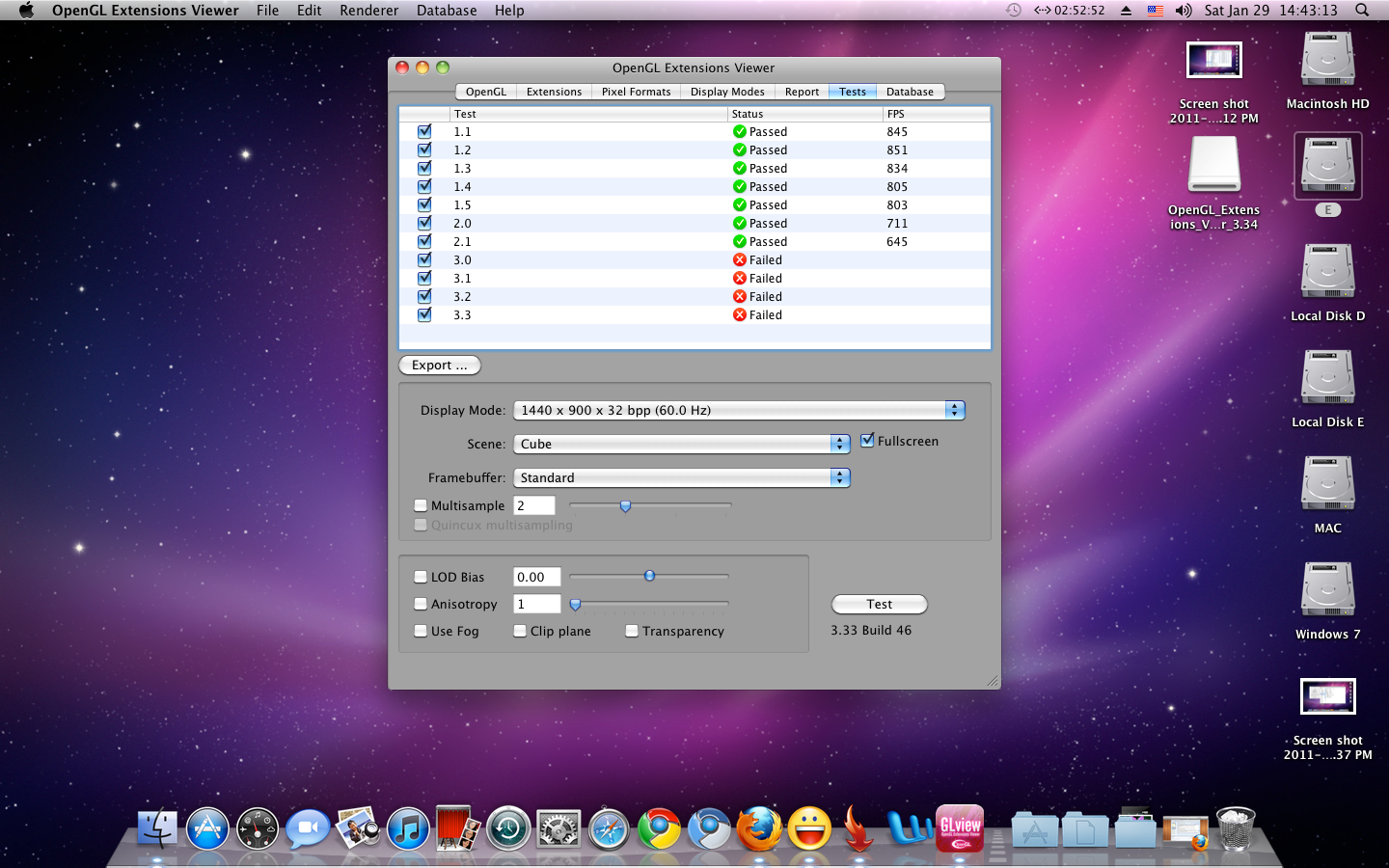

QE CI it work
