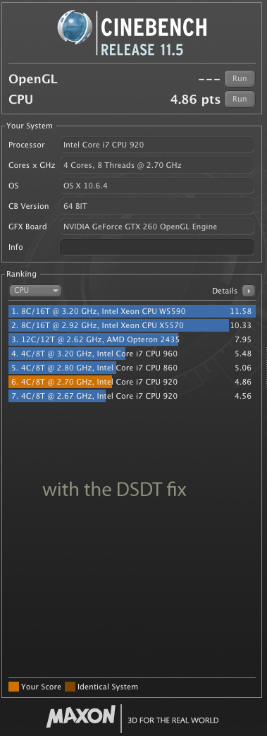

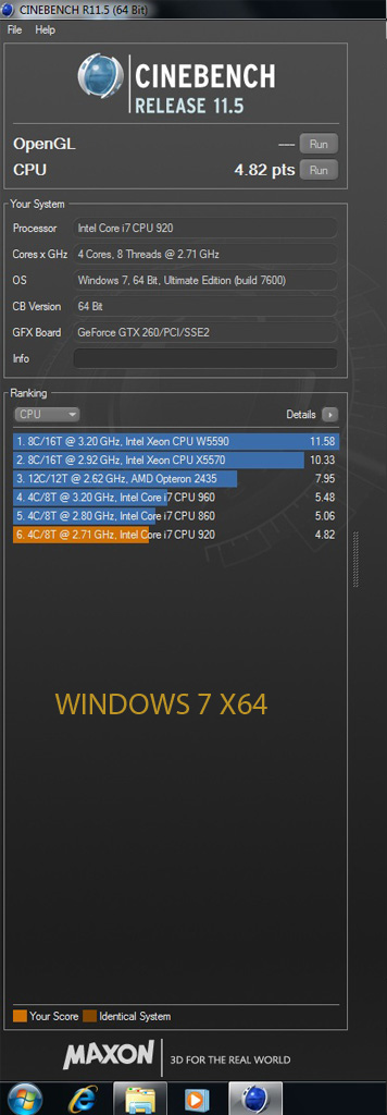

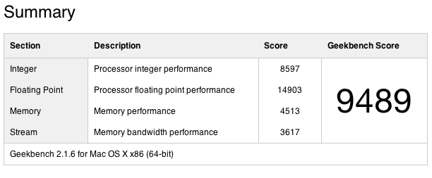

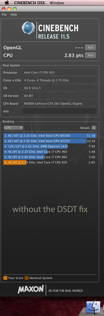

Sinadrin Posted September 24, 2010 Author Share Posted September 24, 2010 Test Snow leopard 10.6.4 x64 With this package drivers v1.2 DSDT Temperature Ambient: 32º Cpu Temp: idle 0%: 39º idle 100%: 58º Benchmark: Geekbench: 9489 CineBench: 4.86 pts without the DSDT fix Temperature Ambient: 32º Cpu Temp: idle 0%: 52º idle 100%: 72º Benchmark: Geekbench: 5150 CineBench: 2.83 pts Windows 7 x64 Benchmark: Cinebench: 4.82pts see the screenshots... Conclusion: the DSDT is not working correctly the temperature increases and the CPU performance is lower because of the Nullcpupowermanagement.kext, with the fixes of this installer you are not going to use the nullcpu anymore, and you will have the correct performance, the temperatures at the normal levels, and with a performance even better than if you use Windows 7 x64. enjoy it!! Link to comment Share on other sites More sharing options...
