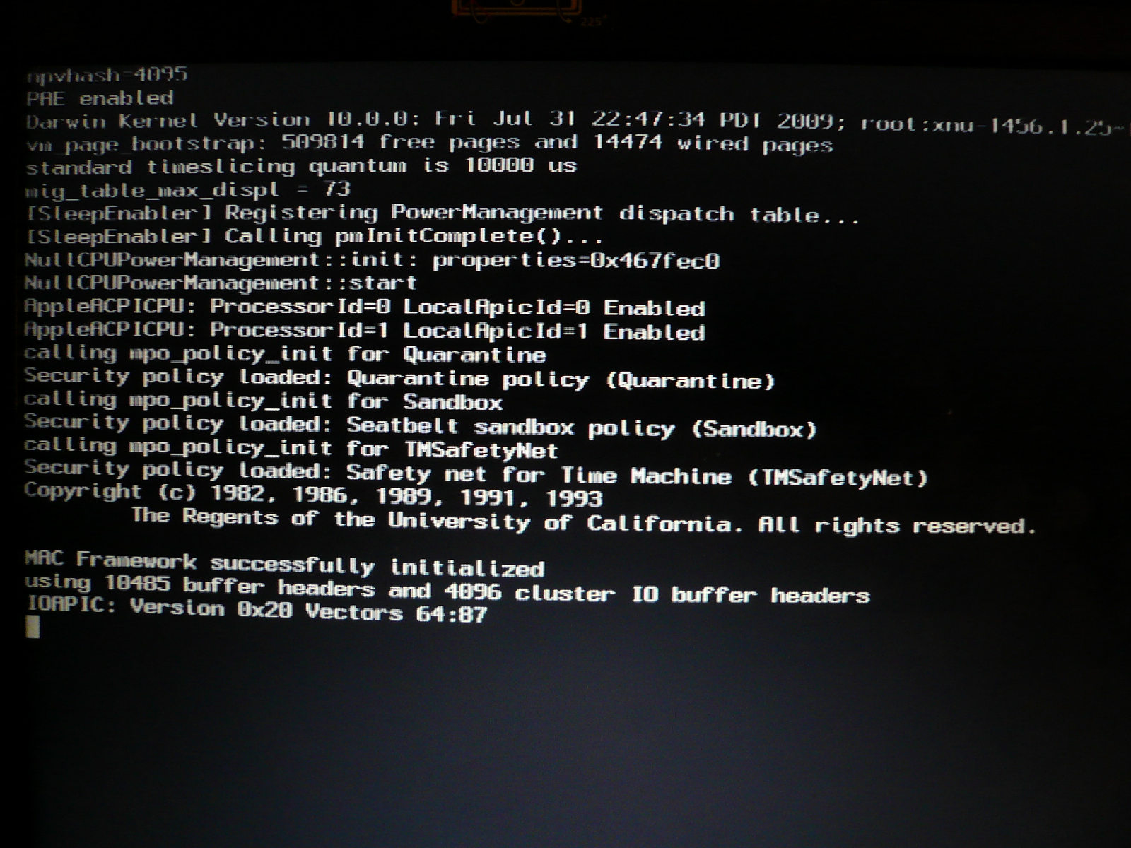

Zirus69 Posted January 26, 2010 Author Share Posted January 26, 2010 Boot in verbose mode (type -v in Chameleon) to see where is it hanging. I have an Aspire 5920 that needs "UHCIreset=yes" for Chameleon to work. Which wifi card do you have? Thanks for the quick answere! During v- boot I got following message. see Attachments Wifi: Intel PRO/Wireless 3945ABG Notebook specific can find here: http://wellsaler003.en.ec21.com/Acer_Aspir...43_3138246.html Link to comment Share on other sites More sharing options...

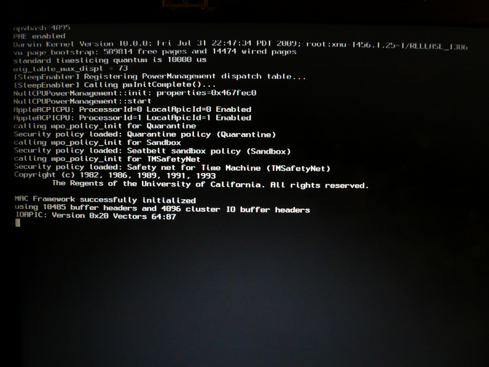

Zirus69 Posted July 24, 2010 Author Share Posted July 24, 2010 I tried it now with 1) EMPIRE EFI v. 1.085 und OS 10.6 Install DVD 2) Snow Leopard 10.6.2 by Hazard 3) iAtkos S3 v2 and I always get the same problem when I start the system ...... can anybody help me? (I already replayed my wifi with an braodcom 4321 ) Link to comment Share on other sites More sharing options...
jor90 Posted November 26, 2010 Share Posted November 26, 2010 I tried it now with 1) EMPIRE EFI v. 1.085 und OS 10.6 Install DVD 2) Snow Leopard 10.6.2 by Hazard 3) iAtkos S3 v2 and I always get the same problem when I start the system ...... can anybody help me? (I already replayed my wifi with an braodcom 4321 ) I have the same problem when booting with 2 cpu's..... try booting with 'cpus=1', it should bypass this problem (but there will only be 1 core recognized.....) I'm yet waiting for a final solution to come.... I figure this should be possible by some BIOS or DSDT modifications... Link to comment Share on other sites More sharing options...
michaelz Posted November 30, 2010 Share Posted November 30, 2010 I have the same problem when booting with 2 cpu's.....try booting with 'cpus=1', it should bypass this problem (but there will only be 1 core recognized.....) I'm yet waiting for a final solution to come.... I figure this should be possible by some BIOS or DSDT modifications... I had the same problem with some Tiger distros and also with Leopard. The solution was flash the bios with a custom firmware wich I have. Now you can do the same with DSDT. asstastic is an user from here who is always looking for solutions for this notebook. He gave me this bios hack but a few months ago he told me that I had to change my bios for the original one to use DSDT instead of bios hack because it´s the best solution. With the DSDT that he gave me we can fix also the 3945ABG wifi (Leopard) with Voodoo wireless. Here is the post where asstastic tell about that http://www.insanelymac.com/forum/index.php...50#entry1428745 Good luck. michaelz Link to comment Share on other sites More sharing options...
jor90 Posted November 30, 2010 Share Posted November 30, 2010 I had the same problem with some Tiger distros and also with Leopard. The solution was flash the bios with a custom firmware wich I have. Now you can do the same with DSDT.asstastic is an user from here who is always looking for solutions for this notebook. He gave me this bios hack but a few months ago he told me that I had to change my bios for the original one to use DSDT instead of bios hack because it´s the best solution. With the DSDT that he gave me we can fix also the 3945ABG wifi (Leopard) with Voodoo wireless. Here is the post where asstastic tell about that http://www.insanelymac.com/forum/index.php...50#entry1428745 Good luck. michaelz Thanks for your post, Michael! Yeah, Assastic seems to have done some great work (he already helped me out quite a bit!), however, using his DSDT gives me a crash at booting. It hangs at: IOAPIC: Version 0x20 Vectors 64:87 (right before ACPI: System State [s0 S3 S4 S5] (S3) should show up...) Since this DSDT solution doesn't work for me, maybe I should try his modified BIOS... Do you still have it somewhere / know where I can download it? Link to comment Share on other sites More sharing options...
