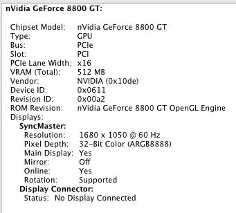

blackosx Posted September 30, 2009 Share Posted September 30, 2009 Just for comparison (if it's any use), I am using the MSI 8800GT OC 512MB which I have activated through patched DSDT. Here's a screenshot of my System Profiler... Link to comment Share on other sites More sharing options...

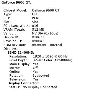

mm67 Posted September 30, 2009 Share Posted September 30, 2009 I don't think that that line tells anything. Even my 9600 GT looks the same Link to comment Share on other sites More sharing options...

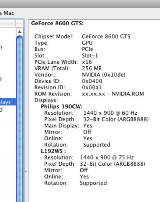

el_charlie Posted October 21, 2009 Share Posted October 21, 2009 It's working for me.I'm using GraphicsEnabler=Yes in my com.apple.Boot.plist file, and get the following in System Profiler; ROM Revision: xx.xx.xx - internal I got Gigabyte.GTX285.PCIe.1024MB.Rev.01.rom from mvktech.net, copied it to /NVIDIA.ROM and rebooted, now I have; ROM Revision: xx.xx.xx - NVIDIA.ROM If I then set GraphicsEnabler=no, the monitor feed goes dead after verbose boot. So it appears that GraphicsEnabler=Yes must be set if one wants to use a ROM image, and copy it to /NVIDIA.ROM. If it's in a non default place or named differently, something like VideoROM=/System/gtx285.rom would also need to be added to com.apple.Boot.plist. What about if the Bootloader is on the EFI partition?? Should I place the ROM on the root of the SnowLeopard partition or on the EFI partition????? Do I have to delete the EFI string of my 8800GT too????? Please help. EDIT: So far, I've placed the NVIDIA.ROM on both the root of the SL partition and the EFI partition. I've also placed the ROM on the Extra folder as well and no luck. My Geforce 8800GT is not detected. I tried with GraphicsEnabler=Yes and without it and still no luck. The only way to detect my card is with the EFI string. How can I do to use the Mac Pro's 8800GT bios???? I repeat, the bootloader is on the EFI partition. I use Netkas' PCEFI V10.4.1 wich is based on Chameleon 2 RC3. Thanks in advance for your help. Cheers! Link to comment Share on other sites More sharing options...
