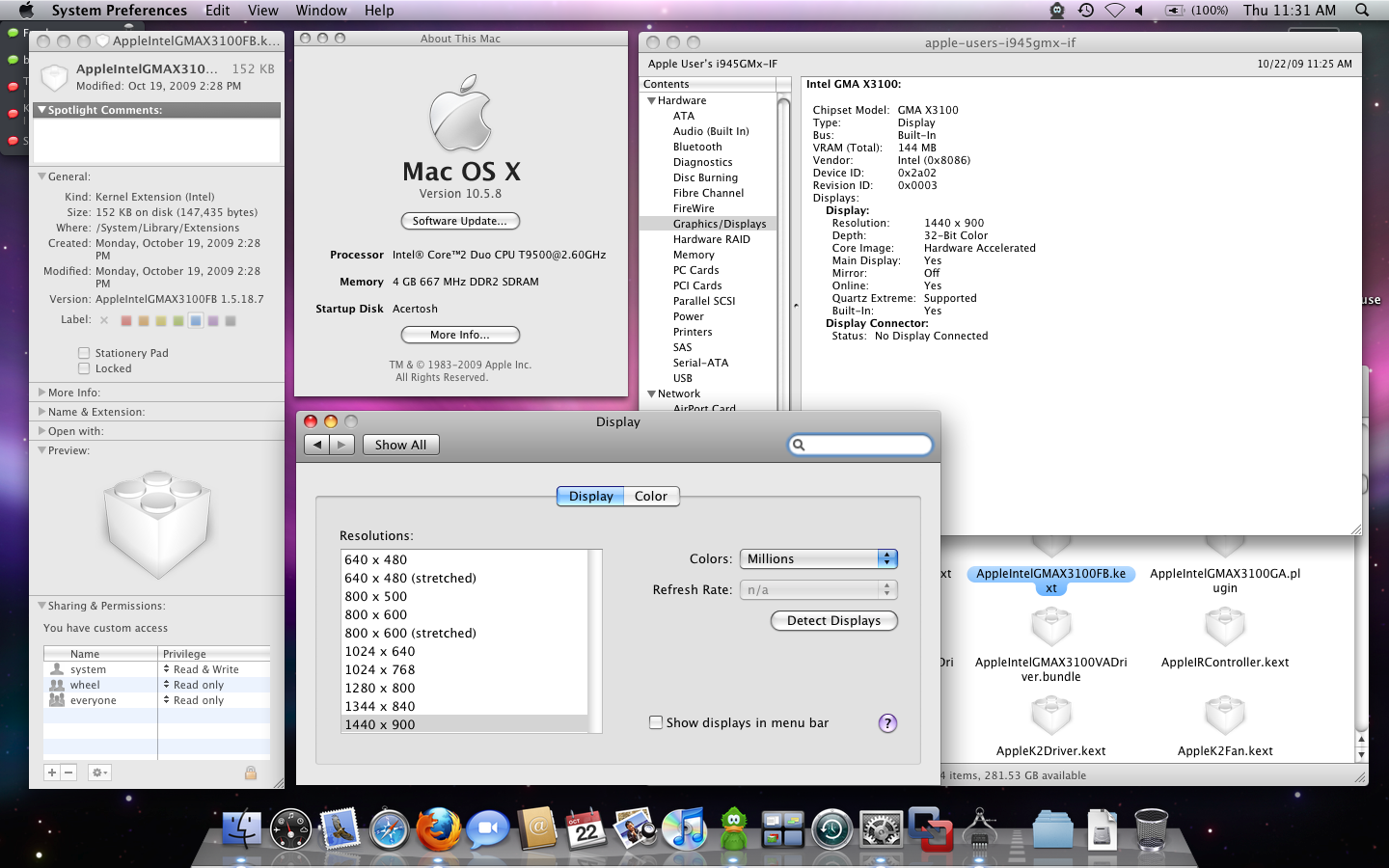

I'm sorry I haven't been on for a while. It appears this fix only works for 0x2a02 GPUs. I have a picture of the system profiler specs attached in the original post.
As far as kexts go these are mine. They work on 10.5.8.

I thought I would share my X3100 issue and how I solved it, in case it can help anyone else perusing this thread for a fix:
Whenever I tried booting a retail OSX DVD, or after installing iDeneb, I would get a black "blank" screen on my laptop. The backlight was on, but no picture. Eventually I figured out that disabling or deleting all X3100 kext's would let me boot, but this was, of course, not a permanent solution.
Long story short, with some trial and error, I discovered that the framebuffer was the issue. Swapping out the AppleIntelGMAX3100FB.kext with one off the iDeneb 1.6 dvd (version 1.5.18.7, dated October 19, 2009) gave me perfectly working graphics. All other X3100 kexts are stock on my 10.5.8 retail installation. Full available resolution list, plus QE. No graphic glitches whatsoever!

Attached is the framebuffer kext that cured things for me. I would just delete your current AppleIntelGMAX3100FB.kext from S/L/E, then install this one using B7 Kext Helper, and reboot. That's all it took for me... working 100% solid now, everytime!
AppleIntelGMAX3100FB.kext.zip

Attached are the working AppleIntelGMAX3100FB.kext and Natit.kext I was using under 10.5.8. Hope they help.
X3100FB_Natit.zip
