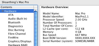

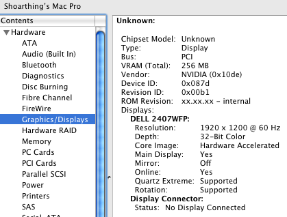

shoarthing Posted August 2, 2009 Author Share Posted August 2, 2009 Images are from first boot into a retail install via Chameleon RC2. Completely vanilla . . but no audio & USB issues. Attached Extensions.mkext used, together with dsdt from first post. ION_330_ChamRC2_Extensions_mkext.zip Link to comment Share on other sites More sharing options...

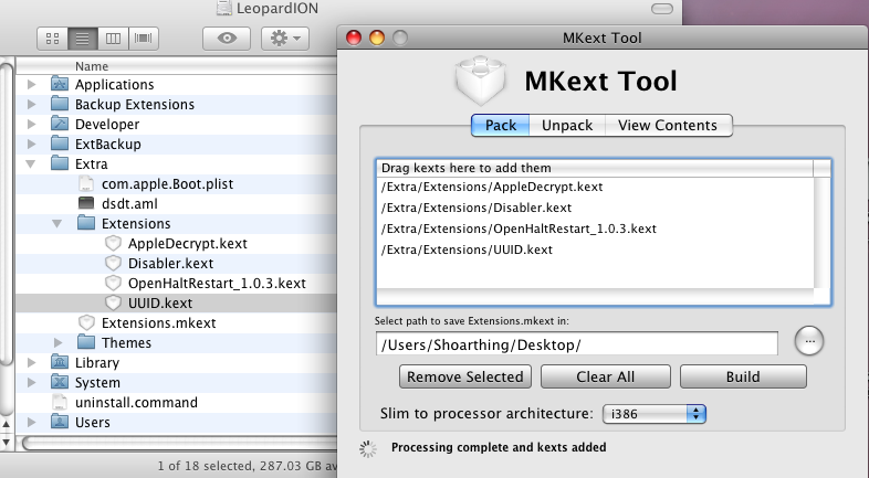

shoarthing Posted August 4, 2009 Author Share Posted August 4, 2009 As a pointer; you shouldn't need more than these 4 kexts in your Extra/Extensions folder to be able run the ION 330 . . . image includes use of the useful Mkext Tool by 'pcwiz' - just in case this is being read by someone new to OSX86 who doesn't know you need to rebuild the *.kexts in your Extra/Extensions folder to a new Extensions.mkext in your Extra folder, every time you change them. The UUID.kext is a reliable means to enable use of Time machine. For anyone who hasn't used this hassle-free method, it has to be edited to show your machine's unique en0 MAC address Link to comment Share on other sites More sharing options...

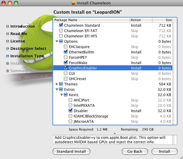

shoarthing Posted August 4, 2009 Author Share Posted August 4, 2009 Hey Shoarthing......... I have REALLY got to stop doing these installs in the weeeee hours of the am cause I miss things like the CUSTOMIZE button! DOH! Installed the new Chameleon B.L. RC2 and all seems to be working well with video now, thanks for sharing your screen of RC 2 config. Now I just cant seem to get it to see 2 cpus. Questions I have for ya: 1.) Did you use a modified SMBIOS at all? I am still using the original Mach Kernal, so all should be ok there. 2.) How do ya get Chameleon to install in the EFI volume, and how do you get the DSDT file over there as well? I got errors when I selected the HFS install option. Going to be installing Snow Leo after this and want to just use one bootloader. 3.) Any luck getting audio working? For me, video (9400m) is good and kicking out 1280x1080@75hz on my DLP projector, wired ethernet is good. Just starting over with a fresh retail base image restore as I have this much squared away, and want to get rid of the junk kexts. THANKS a bunch for the help getting this one squared away! I just got done building up a 1000HE last week that I am using now, if you ever need a hand with one of these, just let me know. Not the fastest thing in the world with the Atom 280, but VERY portable and turns heads . . use my patched dsdt.aml . . . place in /Extra (see image in post 7) . . . disable hyperthreading in the BIOS. Do you have working USB2? Link to comment Share on other sites More sharing options...
UN_WIRED Posted August 4, 2009 Share Posted August 4, 2009 . . use my patched dsdt.aml . . . place in /Extra (see image in post 7) . . . disable hyperthreading in the BIOS. Do you have working USB2? Still having issues getting the 2 cpus to work, and still having to use the CPUS=1 flag. Just rebuilt drive from my image, and moved the dsdt and mkext files into place. Noticing that I had not done anything with the original applesmbios.kext as there was a rom# in my details, and did not see one in yours. Might be wrong, but I assume you apple the applesmbiosbefi patch so it uses uses the dsdt file instead of being hardcoded? Still working on the USB2.0 solution you wrote about. Will be trying it this evening. Man, was not this tough to get everything working on the 1000he, or maybe it was and just did not realize it! Link to comment Share on other sites More sharing options...
shoarthing Posted August 4, 2009 Author Share Posted August 4, 2009 Still having issues getting the 2 cpus to work, and still having to use the CPUS=1 flag. Just rebuilt drive from my image, and moved the dsdt and mkext files into place. Noticing that I had not done anything with the original applesmbios.kext as there was a rom# in my details, and did not see one in yours. Might be wrong, but I assume you apple the applesmbiosbefi patch so it uses uses the dsdt file instead of being hardcoded? Still working on the USB2.0 solution you wrote about. Will be trying it this evening. Man, was not this tough to get everything working on the 1000he, or maybe it was and just did not realize it! . . if you put the files I linked to in your Extra/Extensions folder, with the linked dsdt.aml & Extensions.mkext in the Extra folder, & with hyperthreading disabled in BIOS v1.50, you should see 2 cores w/ 2x 512MB L2 cache. . . seriously: this works . . . I have re-installed like this a half-dozen times. You don't need any smbios injector, or a hacked smbios [for now]. Getting the thing up & running with full function is I would suggest the first goal . . . . Link to comment Share on other sites More sharing options...
UN_WIRED Posted August 5, 2009 Share Posted August 5, 2009 . . if you put the files I linked to in your Extra/Extensions folder, with the linked dsdt.aml & Extensions.mkext in the Extra folder, & with hyperthreading disabled in BIOS v1.50, you should see 2 cores w/ 2x 512MB L2 cache. . . seriously: this works . . . I have re-installed like this a half-dozen times. You don't need any smbios injector, or a hacked smbios [for now]. Getting the thing up & running with full function is I would suggest the first goal . . . . So I have gone through and checked anything I can think of..... DSDT (Both .aml and.dsl files) are in the /Extra folder and the Extensions.mkext are in the /Extra/extensions folder and no go, still have to boot with cpus=1 flag. Something that came to mind tonight. I HAVE installed the new RC2 boot loader in the EFI partition once trying to set it up for win 7 in the future........ I am using a GUID boot scheme as well (Same as my 1000he), is there any way to mount the EFS partition so I can see what is there? I also tried installing an older EFI V8 of Chameleon to the leo partition I am booting from (disk0s2) and it should have loaded that version instead, but I still have the rc2 version loading. I am thinking something is messed up in my paritions and this is why I cannot load the dsdt file. Sorry for any stupid questions, I am still fairly new to the hackintosh ways, installed 10.4 a long time back, but just recently started to mess with the new versions. Thanks for your patience! PSS- Obviously it HAS to be loading the DSDT.aml file because my NV graphics, and lan are working 100% without pacthed kexts. Trying a repart and reload again from raw image. Link to comment Share on other sites More sharing options...
shoarthing Posted August 5, 2009 Author Share Posted August 5, 2009 So I have gone through and checked anything I can think of..... DSDT (Both .aml and.dsl files) are in the /Extra folder and the Extensions.mkext are in the /Extra/extensions folder and no go, still have to boot with cpus=1 flag. Something that came to mind tonight. I HAVE installed the new RC2 boot loader in the EFI partition once trying to set it up for win 7 in the future........ I am using a GUID boot scheme as well (Same as my 1000he), is there any way to mount the EFS partition so I can see what is there? I also tried installing an older EFI V8 of Chameleon to the leo partition I am booting from (disk0s2) and it should have loaded that version instead, but I still have the rc2 version loading. I am thinking something is messed up in my paritions and this is why I cannot load the dsdt file. Sorry for any stupid questions, I am still fairly new to the hackintosh ways, installed 10.4 a long time back, but just recently started to mess with the new versions. Thanks for your patience! PSS- Obviously it HAS to be loading the DSDT.aml file because my NV graphics, and lan are working 100% without pacthed kexts. Trying a repart and reload again from raw image. . . . no: graphics will work [accelerated] if you have ticked the right box in Chameleon RC2 b640's options. NFORCE MCP79 Ethernet just works. Check you are using the latest build of Chameleon & have ticked the right options. If installing vanilla you will only have 2x cores & 2x 512KB L2 cache if you have the right setting in the BIOS [hyperthreading disabled] & if you have loaded the dsdt.aml - else you will have to use "cpus=1" or the thing will have KP'd I have checked the dsdt.aml [& dsdt.dsl] I uploaded here - they are correct. The dsdt.dsl is just there for your interest &/or reference [it can be opened with an editor to see what I have changed, then compiled with IASL or the MS. equivalent]. Link to comment Share on other sites More sharing options...
UN_WIRED Posted August 5, 2009 Share Posted August 5, 2009 . . . no: graphics will work [accelerated] if you have ticked the right box in Chameleon RC2 b640's options. NFORCE Ethernet just works. Check you are using the latest build of Chameleon & have ticked the right options. If installing vanilla you will only have 2x cores & 2x 512MB L2 cache if you have the right setting in the BIOS [hyperthreading disabled] & if you have loaded the dsdt.aml - else you will have to use "cpus=1" or the thing will have KP'd I have checked the dsdt.aml [& dsdt.dsl] I uploaded here - they are correct. The dsdt.dsl is just there for your interest &/or reference [it can be opened with an editor to see what I have changed, then compiled with IASL or the MS. equivalent]. All very valid points and I am learning something with each reply! I am thinking that the fact I restored from an image is the problem? If I do a fresh virgin install from the DVD, it should setup the EFI partition again, right? Anyways, starting a new reload and will check on it tomorrow! Link to comment Share on other sites More sharing options...
