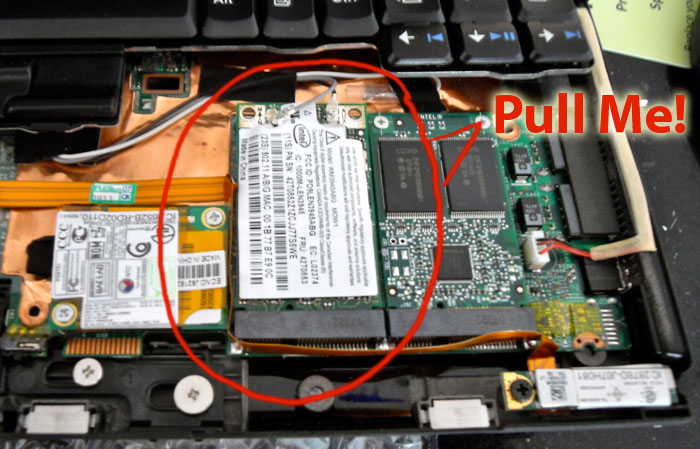

Do you have the ThinkPad Wireless MiniPCIE card? If so -- you have Atheros, and you're ready for wireless! Have the Intel 3945 card? You're screwed! Get on eBay and pick up the Atheros controller, you can search for Thinkpad wireless atheros, or by FRU, which could be 39t5578, 39t0499, or 40Y7026. I had to replace mine, and it's not terrible. Remove all of the keyboard screws and the bottom half of the "board" screws on the bottom of the machine, lift up the palmrest, and it's right in front of you. I will not be held responsible if you damage anything. wink.gif Please note that other cards, such as the Dell 1490 series, will NOT work with your ThinkPad. Lenovo, in their infinite wisdom, has a white list of PCI IDs that they will allow as a network controller. Putting that card in your system will just give you an error message asking you to get it out of that laptop.
To get your Atheros card working, pop into a terminal, and go to /System/Library/Extensions/IO802.11Family.kext/Contents/PlugIns/AirPortAtheros.kext/Contents. Edit Info.plist with vi, nano, pico, or your editor or choice. Go down to IOPCIMatch, and under that, with all the <string> entries, add <string>pci168c,1014</string>. Save and exit, and manually load it by entering "kextload /System/Library/Extensions/IO802.11Family.kext" You'll be able to head into System Preferences, Network, and watch as it adds an AirPort option. Hit the 'Turn AirPort On' button, and you're in business.
If you can't get it to turn on, go to "Advanced", and click some checkbox, like "Disconnect when user logs out". Hit Okay, and hit Apply at the main Networking window. The Apply button will turn your card on, and it will work from then on out. Have fun!

Alex Palmas
QUOTE(outZider @ Feb 14 2008, 06:37 AM) *
Wireless
AAAAAARGH blink.gif blink.gif blink.gif !!!!
You gave me a terrible news!!!!!
Last monday I ordered from DELL a Wireless 1490 802.11a/g Mini Card (54Mbps) dell Latitude D420/D520/D620/D820 / D620 ATG!!!
I bought it because I have read many threads (Italian Forum) and all people say that this is the most compatible Mini PCIE card for Leopard..
Are you sure about its Lenovo incompatibility?!?!
In Europe I have found only this ebay object: 190198921471 (search object on ebay) but I don't know if chipset AR5006EGS is compatible..

Wireless
Hi outZider, is it possible to bypass BIOS error with this?
http://www.thirdblessing.net/svemir/archiv...r/#comment-6298
Did you try the no1802.com file?
It would be a great solution!
Thanks and bye:-)
ixion
Not sure I can be bothered with having external sound adapters - you think there will be a fix one day?
Also, this slide the wireless card power switch on the front of the laptop to the off position before sleep hasnt helped, my laptop sleeps and immediately wakes up again
Any clues?
outZider
QUOTE(Alex Palmas @ Feb 18 2008, 03:54 AM) *
Positive. sad.gif I had a 1490 sitting around here. I popped it in, and the BIOS started whining about an unrecognized network card installed and refused to boot. Sorry to give the bad news. sad.gifI ended up ordering FRU 39T5578, Lenovo ThinkPad Wireless PCI-E AR5BXB6. Spent US$23 plus shipping, works great. I did a search on eBay for (39t5578,39t0499,40Y7026), which searches all three valid FRUs for the card.
QUOTE(Alex Palmas @ Feb 18 2008, 05:40 AM) *
Did you try the no1802.com file?It would be a great solution!
Unfortunately, seems that this can't be bypassed in newer models. Some of the [T/A/X]4x series and all of the 6x series override this fix. sad.gif
