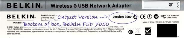

Alright peeps, back on track: the Belkin USB F5D7050. I went out to Fry's and bought one of these beauties for $29.95. First of all there is a notice inside that says the device is not Vista compatible. Although, as we all know, things can be hacked tongue.gif .
I have included a few box scans so everyone knows what the package looks like, as well as the bottom flap where the version number is so you know Where to look. I went to the website listed above for my chipset. I installed the driver, restarted the computer, inserted the device into my USB port. Voila! Instant wireless connectivity (after configuring my security settings).
This fantastic chip supports WEP as well the network types where you have to enter the network name too. Everyone go out and buy one of these! Great antenna, better connection that my onboard.
Click to view attachment
EDIT:
It is intresting to note that this piece of hardware evidently does not work universally across all versions and distros of of HacOSx86. I have had a problem or two getting the connection to register in my system. This only happened once, but otherwise this hardware works just fine.
It DOES suffer from the replug glitch. You have to unplug/replug the device after the os has loaded for it to register as a device. Once I left it unplugged, and only plugged it in after the system loaded, and had problems. I suspect that it needs to be plugged in BEFORE you turn the system on and boot MacOS. Then you will need to unplug/replug to get it to work. Minor problem. Maybe there will oneday be a workaround.
My system:
Fujitsu Lifebook A6020
Core2Duo
Leo4all v2 10.5.2

So for the hackintosh newbies let me see if I can summarize and get concurrence from someone more in the know. This is what I think I learned before I head to my local BB tonight:
If you can find an F5D7050 Version 2xxx.....get it as a first choice because you can just download the dirver from http://web.ralinktech.com/ralink/Home/Support/Linux.html or http://rt2x00.serialmonkey.com and use these drivers with NO mods. READ THAT NO mucking around with a text editor required! Correct?
[Just a question...since I don't know MAC (as opposed to Jack wink.gif how does one load a driver on a MAC?]
Use version 3xxx or 4xxx as second to last choice. (both apparently require mucking with the driver/editing "your must add the Belin USB ID data to rtmp_def.h to the #define RT73_USB_Deivces section"....does one do that in a text editor? And then what??? Does it need to be compiled or is this merely a config file?
Don't go with version 1xxx or because it is status GREY and requires mucking with the driver ...and may not work.
