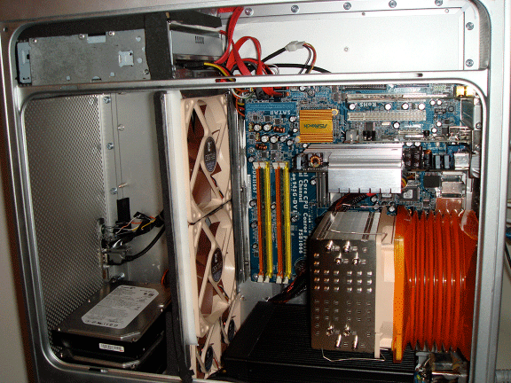

I arranged my mATX board to the 4 PCI slots. This way, I can put an ATX in there at some point. My goal was to go for quiet, as you can see. The DVD drive and HD drives are all foam mounted to the case, to reduce transmitted vibration noise.

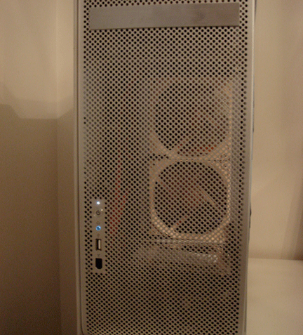

I had to make a CD door cover:
Click to view attachment
I never use the front audio out, so I put the HD activity LED there:
Don't have onboard firewire, so a big hole there right now....
I want QUIET!! So lots of big fans@slow speed, big heatsinks, and physics:
Note: heatsink is Thermalright HR-01, the (ugly) fans are made by Noctua, power is Antec Phantom 500W

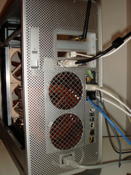

For the back, I just hacked a hole for the USB/sound/Ethernet, which are always grouped together:

I still can't believe the color of the fans, they are so ugly. And lets not even mention the orange duct. whistle.gif But when the cover is on....... thumbsup_anim.gif.
Anyway, not the most satisfying mod, as now OSX actually looks like it is running on supported hardware. Big deal. hammer.gif
But I've achieved my goal of quiet cool. smoke.gif This computer is MUCH quieter than my dual G5. My plan is to eventually use this hackintosh to replace the noisy G5 that is currently in my recording studio. And when I get a conroe, I should be able to (quietly) overclock a bit...... guitar.gif

Made some improvements to the back end.
CPU fan is now on the case, not on the heatsink. Made it all pretty....
Also got the front firewire connected.
New mobo/CPU/VGA on the inside, as per my sig....
It didn't look quite finished, but I couldn't put a finger on it.... until I accidentally stuck my finger in the fan. biggrin.gif
Put a grill on the fan.
