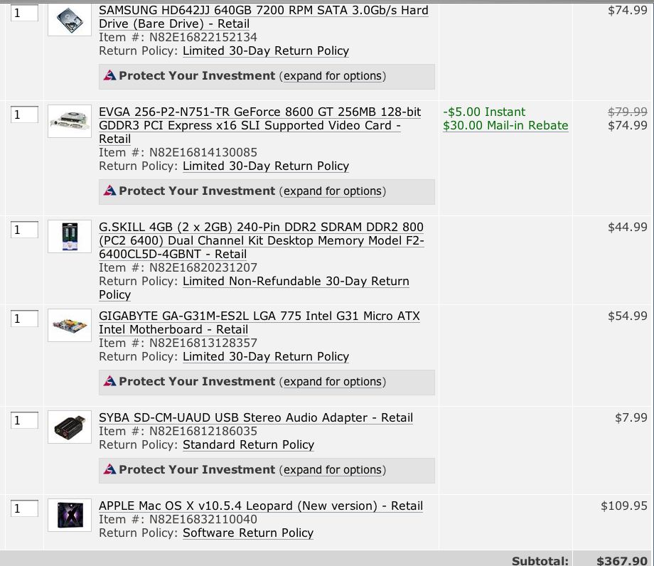

Well, the hard drive in my old Mac died, so I have to go ahead with this. I have a case, monitor, an IDE DVD drive and an E7200 processor already. This is my shopping cart:
Click to view attachment
Is there anything wrong with getting the retail Leopard version 10.5.4? They also offer 10.5.1.
As far as the video card, I'm still not clear on whether this one works in a really straightforward manner without any special procedures I have to go through. I could get a 7300GT if that would be easier- it looks like the most trouble-free card listed in the HCL.
I'm going to pull the trigger tomorrow.
Zaap
Someone over on Anandtech's forums bough the DG31PR and it shipped with the latest BIOS. So it might be that Intel has finally fixed the catch-22 with those boards and has updated them. I can't say for sure, because I haven't purchased one recently, but just a heads up.
The graphic card should work fine- use EFI studio to enable it- takes literally a second.
Buy OSX and support Apple no matter if you're doing a retail install or not. smile.gif
