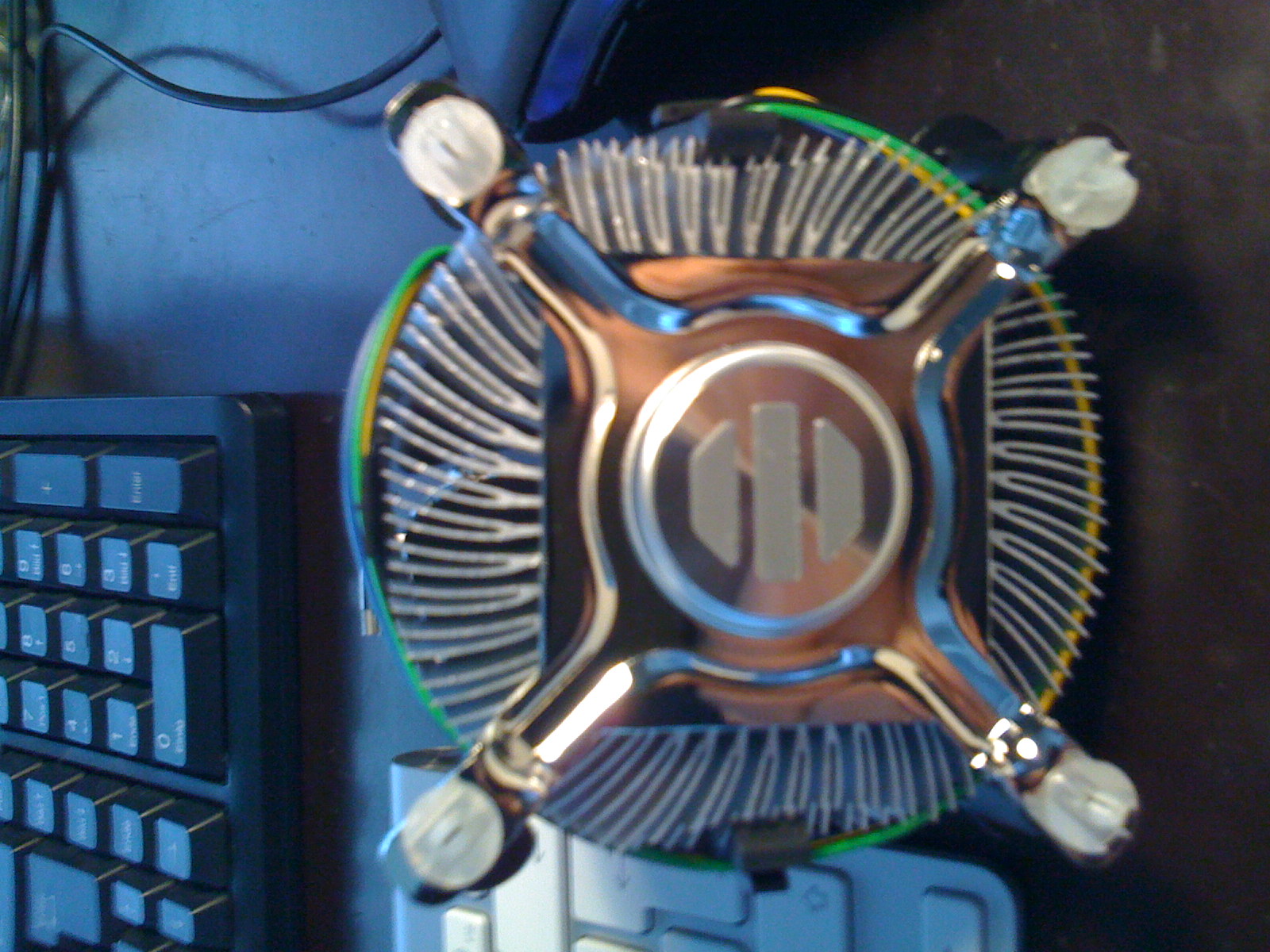

PoloBear
Aug 30 2008, 08:16 AM
Did you buy a boxed processor with heatsink? If so, the heatsink has a pad of thermal grease on it...
If you use another heatsink, clean it and apply a small dot of arctic silver on the heatspreader...use a blade to even apply it then...mount the heatsink.
Click to view attachmentyou can see how small the heatsink of an 45nm processor is..

ok, i don't think i can go one step w/o having a problem. so i popped in the processor and put the heatsink on and it is the one that you had a picture of above. so now, i was able to easily push in two of the four corners, but the other two won't go down in either position. i don't want to force it too hard, i'm afraid i'll break the motherboard. what am i doing wrong here? the first two went down w/ no problem at all
jbaruch76
Aug 31 2008, 02:39 PM
ok, i got it, i was just being a bit of a pansy and i had to push it down a little harder, it's in securely now. all i am doing now is waitig for my video card and then i will start installation. any point of trying to install with an old video card and then just replace it when mine comes on tuesday?
