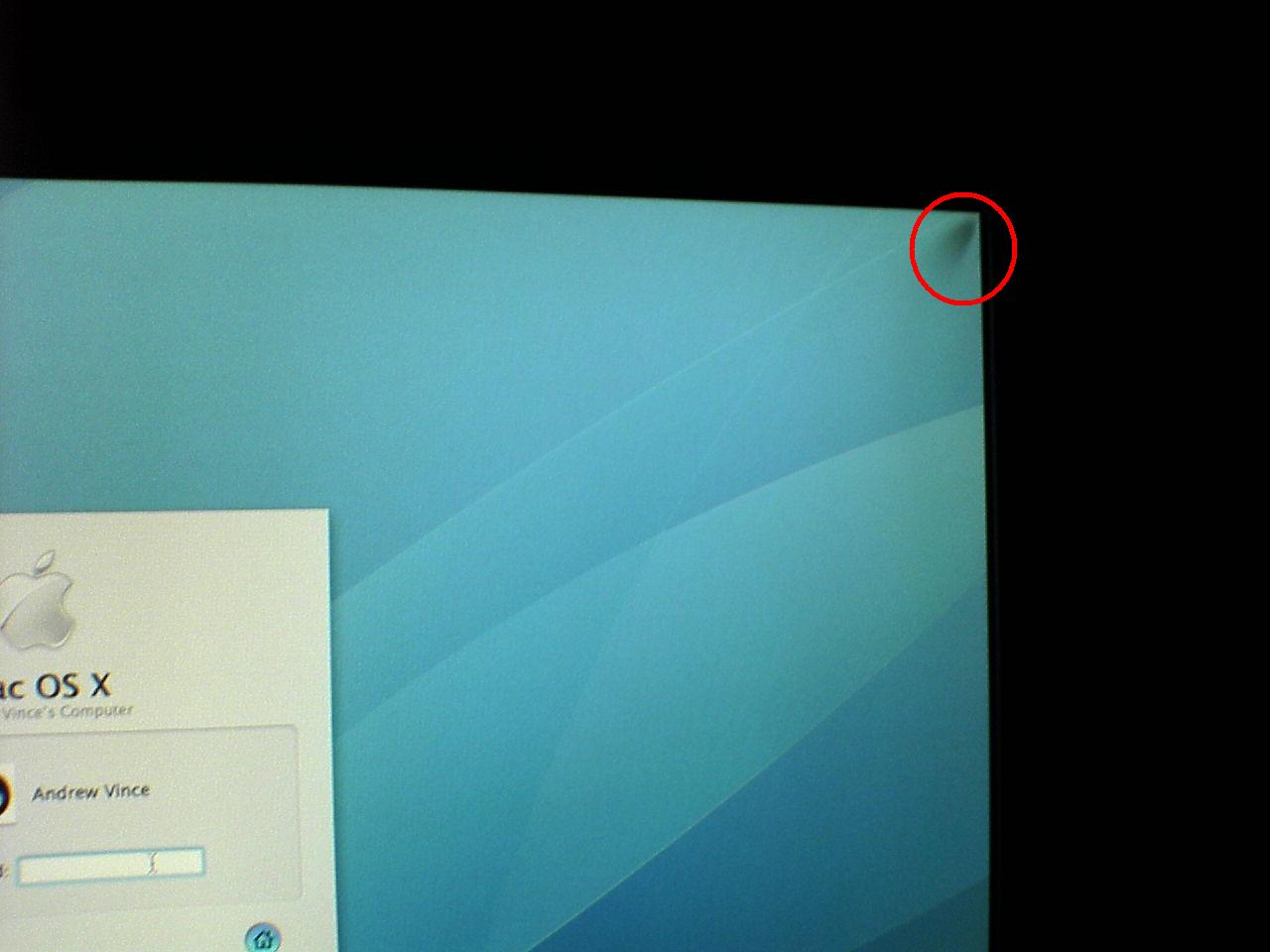

Just one other thing has anyone ever seen these shadows in corner of mac screen and know what it is.. i have them in three of the corners. ??
Click to view attachment Thanks
Andy.
