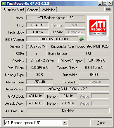

Hi developers,
I'm also very interested in this project, I'm very annoyed by the Xpress 200M Chipset and the QE/CI problem.
I'm using Leopard 10.5.4 (Zephy using ASU) with a ATI Radeon Xpress 1100, and Callisto 003 has given me resolution and refresh rate changes.
I'm not a developer but let me know if you need me to test anything relating to the above card.

graphics:
Radeon XPRESS 200M (PCIE):
 Chipset Model:    Radeon XPRESS 200M (PCIE)
 Type:    Display
 Bus:    PCI
 VRAM (Total):    48 MB
 Vendor:    ATI (0x1002)
 Device ID:    0x5975
 Revision ID:    0x0000

Compile radeontool & avivotool, latest src at:
http://gitweb.freedesktop.org/?p=users/air...;f=radeon_reg.h
see radeon_reg.h
scanpci:
pci bus 0x0001 cardnum 0x05 function 0x00: vendor 0x1002 device 0x5975
ATI Technologies Inc RS482 [Radeon Xpress 200M]
# lspci -n | grep 5975
01:05.0 0300: 1002:5975
# echo 1 > /sys/bus/pci/devices/0000\:01\:05.0/rom
# cat /sys/bus/pci/devices/0000\:01\:05.0/rom > myrom
# file myrom
myrom: BIOS (ia32) ROM Ext. IBM comp. Video (128*512)
# cp myrom /media/bios/BK-ATI-VER008-050l.036.003
# ./avivotool --debug romtables myrom
Found card 1002:5975 (30000)
 (unknown card)

RaBiT www.techpowerup.com:
-- RaBiT v.2.1.0 build 645 --
Read file: 65536 bytes, ROM len: 65536 bytes
-- Analyzing ROM BIOS --
> HEADER offs: 0x118
> PCIR struct offs: 0x18C
> CRC table offs: 0x1C0
> CLOCK table offs: 0x8A2
Core clock is 400.00 MHz
Memory clock is 200.00 MHz
Reference clock is 14.32 MHz
> Memory config: 0xAA55
> TV table offs: 0xCA77
Active TV type: 'NTSC'
> Hardware table: at 0x4C0, Rev.2
hw_a: 0x330F, hw_b: 0x0000
> DFP table offs: 0x4D4
DFP table Ver.2, 6 preset(s)
> Connectors Layout table offs: 0x4CA
Conn0 type = VGA, DDC = CRT2, DAC = Unknown
Conn1 type = Proprietary, DDC = MONID, DAC = Unknown
Conn2 type = Unsupported, DDC = None, DAC = Primary
> VESA BIOS Extension 2.00, Rev. 1.00:
Vendor: ATI Technologies Inc.
Product: MS48, Rev. 01.00
OEM: ATI Radeon® Xpress 1150
> ASIC config:
0x75 = 0x00, 0x74 = 0x00
0x7C = 0x00, 0x7B = 0x00, 0x7A = 0x00
This BIOS has hidden (by RaBiT) data
-- ROM BIOS info --
Desc: RS485/M Ferra6 VBIOS BR#21663
Info: MS48PCIEDGD1UN,  uyferra.ace v611 , 2006/08/23 17:35
! Chipset family: Unknown
> PLL script at 0x038C
> PLL2 script at 0x0421
> INIT script at 0x0222
> MEMORY script at 0x02BF
-- Found hardware registers values: --
> PLL(0A): 0x001CA802 at 0x03AC
> PLL(0D): 0xFFFFFFF9 at 0x03D1
-- User changes followed --
