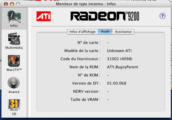

Krazubu Posted June 2, 2008 Share Posted June 2, 2008 Wandering on the web, I found latests "ATI Displays" tools (4.5.9 last updated for G5 and X1900 iirc). It adds a special panel in preferences, as usual, it comes with a kext for TVout kext, but - more interesting - it seems this time it's universal. I had tried 4.5.7 not a long time ago and managed to get the tools to "see" my radeon 9250, it needs to have correct values injected (especially the board codename). However most features were greyed out because of missing intel kexts. Maybe this time TV out is possible. I quickly tried again with this new one and my X1600 but haven't managed, however I haven't bothered much about it. I upload it here, maybe you'll manage to get something off it. I'll try again with my 9250 when I have some time to waste. You can get it here Link to comment https://www.insanelymac.com/forum/topic/96664-ati-framebuffer-development/page/3/#findComment-768531 Share on other sites More sharing options...

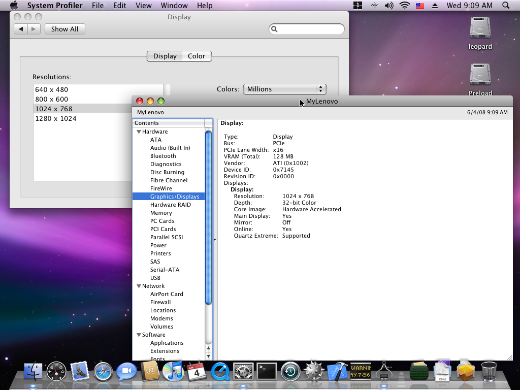

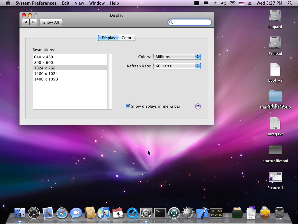

dong Posted June 4, 2008 Share Posted June 4, 2008 A little progress for my X1400 mobility! I subclassed IONDRVFramebuffer and add some code to cscGetNextResolution, now some more resolutions appeared in display preferences. I'm using manually injected EDID to get these resolutions. The problem is that the native resolution:1400x1050 is not shown. Did not figure out the reason yet. And need add code to cscSwitchResoltion to really do the job! Edit: Made a mistake when assigning displayMode ID, now all resolutions that my internal LCD supported show up after fix it. Link to comment https://www.insanelymac.com/forum/topic/96664-ati-framebuffer-development/page/3/#findComment-770637 Share on other sites More sharing options...
justin1986 Posted June 4, 2008 Share Posted June 4, 2008 Don't know that much about this, but in Post 50 (by Slice) i see a for i=4 loop, which gets the resolutions from the EDID. And you happen to get 4 resolutions. So my guess is it first passes the 4 lowest resolutions, and the script never gets to 1440, as you do have the common 640,800,1024 and 1280 ones. So maybe changing it to i=5 or 6 might do the job? (feel free to shoot me if this is a stupid answer) Link to comment https://www.insanelymac.com/forum/topic/96664-ati-framebuffer-development/page/3/#findComment-770834 Share on other sites More sharing options...
dong Posted June 4, 2008 Share Posted June 4, 2008 I'm not using Slice's source code, but rather directly based on apple's source. Actually Slice's kext is not for Radeon card beyond x800. Also the i=4 loop is just for detailed timing modes which is the max number of this kind of modes in EDID. The 4 modes I observed is from established timing modes and standard timing modes. After fixing the code, the two detailed timing modes: 1400x1050@60Hz and @50Hz are now listed in display preference. But I am still confused by one thing: the rowBytes gaven by boot mode of "1400x1050x32" is 5632, instead of my calculated value 5600 (1400 * 4). While for 1024x768x32 or 1280x1024x32, the two values are the same. Where comes the extra 8 pixels in case of 1400x1050? Help is needed to clarify this. Link to comment https://www.insanelymac.com/forum/topic/96664-ati-framebuffer-development/page/3/#findComment-770930 Share on other sites More sharing options...

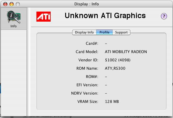

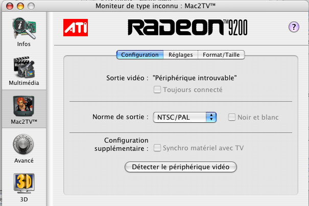

Slice Posted June 6, 2008 Author Share Posted June 6, 2008 Wandering on the web, I found latests "ATI Displays" tools (4.5.9 last updated for G5 and X1900 iirc).It adds a special panel in preferences, as usual, it comes with a kext for TVout kext, but - more interesting - it seems this time it's universal. Good news! I checked it. See picture. Yes, ATITVOut.kext is universal binary now!!! The only problem is to understand how to switch it on. <key>IOMatchCategory</key> <string>ATITVOut</string> There is a real task for our development. A little progress for my X1400 mobility!I subclassed IONDRVFramebuffer and add some code to cscGetNextResolution, now some more resolutions appeared in display preferences. I'm using manually injected EDID to get these resolutions. The problem is that the native resolution:1400x1050 is not shown. Did not figure out the reason yet. And need add code to cscSwitchResoltion to really do the job! I agree. But there are 29 other cscXXX commands that might be needed to do the job. We need to exchange informations about the commands. Actually Slice's kext is not for Radeon card beyond x800. Sorry! I have Radeon9000 and my kext would work for it. For beyond it is a matter for discuss. After fixing the code, the two detailed timing modes: 1400x1050@60Hz and @50Hz are now listed in display preference. But I am still confused by one thing: the rowBytes gaven by boot mode of "1400x1050x32" is 5632, instead of my calculated value 5600 (1400 * 4). While for 1024x768x32 or 1280x1024x32, the two values are the same. Where comes the extra 8 pixels in case of 1400x1050? Help is needed to clarify this. I am not ready to answer your question. May be you publish your part of the codes where the value is calculated? My results. I manually inject EDID and got dmesg ATIFB: videomodes to var 1600 1200 1600 1200 0 0 6172 304 64 46 1 192 3 3 Depth set : 32 1600 1200 1600 1200 0 0 6172 304 64 46 1 192 3 3 hStart = 1664, hEnd = 1856, hTotal = 2160 vStart = 1201, vEnd = 1204, vTotal = 1250 h_total_disp = 0xc7010d hsync_strt_wid = 0x18067d v_total_disp = 0x4af04e1 vsync_strt_wid = 0x304b0 pixclock = 6172 freq = 16202 But my LCD has mode 1024x768 but not 1600x1200 so I got black screen. So now I return to the problem of getting good EDID. I have no EDID in BIOS. I need to get it from I2C but I have no good procedure reliable for my hardware. Searching... Link to comment https://www.insanelymac.com/forum/topic/96664-ati-framebuffer-development/page/3/#findComment-773236 Share on other sites More sharing options...
Krazubu Posted June 6, 2008 Share Posted June 6, 2008 Slice, I think you have to enable the TV out using the ATI control panel (the app you shot in your post). That's what I was explaining before, if the rights strings are correctly injected, the card will be detected and many more options will appear, including those for TV out. However there must be a "generic way" to enable it but it requires some more coding so maybe testing it this way would be better, before getting into something complicated maybe for nothing. I'm gonna try again with my 9250, I had managed not long ago to enable this panel. Edit : I'm posting a screen shot to show how it's supposed to look, I did it last time, I didn't have that intel kext yet. Look at the icons on the left. Edit 2 : I managed to bring back the full panel. I tried several codenames, they all enabled it but only "Bugsy" brang all the features. I join the plist I used in the injecter. I get an error at the launch of the control panel : "A problem was encountered. Unable to connect to the TVout kernel extensions. Some features are unavailable". I join a new shot of the TV panel, however it's still greyed out since the extensions can't be "connected". The extension is loaded successfully, maybe a problem with the device path ? If you look closely, you'll notice I get a kind of echo, what could this mean ? I don't get this usually when only using VESA. Maybe one of my injected strings triggered something. <dict> <key>@0,AAPL,boot-display</key> <integer>1</integer> <key>@0,ATY,EFIDisplay</key> <string>LVDS</string> <key>@0,compatible</key> <string>ATY,Bugsy</string> <key>@0,device_type</key> <string>display</string> <key>@0,display-dither-support</key> <integer>1</integer> <key>@0,display-link-component-bits</key> <integer>6</integer> <key>@0,display-type</key> <string>LCD</string> <key>@0,inverter-current</key> <integer>0</integer> <key>@0,name</key> <string>ATY,Bugsy_A</string> <key>@1,AAPL,boot-display</key> <integer>0</integer> <key>@1,ATY,EFIDisplay</key> <string>CRT2</string> <key>@1,compatible</key> <string>ATY,Bugsy</string> <key>@1,device_type</key> <string>display</string> <key>@1,display-dither-support</key> <integer>0</integer> <key>@1,display-link-component-bits</key> <integer>6</integer> <key>@1,inverter-current</key> <integer>1</integer> <key>@1,name</key> <string>ATY,Bugsy_B</string> <key>AAPL,backlight-control</key> <integer>1</integer> <key>AAPL00,Coherency</key> <integer>2</integer> <key>ATY,Copyright</key> <string>Copyright ATI Technologies Inc. 2005</string> <key>ATY,DeviceID</key> <integer>22880</integer> <key>ATY,EFIVersion</key> <string>1.3</string> <key>ATY,VendorID</key> <integer>4098</integer> <key>DFP1,EDID</key> <data> AP///////wAebQEAAQEBAQAQAQOAQCWWCs90o1dMsCMJ SEwvzgAxQEVAYUABAQEBAQEBAQEBZiFQsFEAGzBAcDYA xI4hAAAeDh8AgFEAHjBAgDcAP0MhAAAcAAAA/QA4Sx88 CQAKICAgICAgAAAA/ABEQTcwWAogICAgICAgANI= </data> <key>LVDS,EDID</key> <data> AP///////wAebQEAAQEBAQAQAQOAQCWWCs90o1dMsCMJ SEwvzgAxQEVAYUABAQEBAQEBAQEBZiFQsFEAGzBAcDYA xI4hAAAeDh8AgFEAHjBAgDcAP0MhAAAcAAAA/QA4Sx88 CQAKICAgICAgAAAA/ABEQTcwWAogICAgICAgANI= </data> <key>device_type</key> <string>ATY,DDParent</string> <key>model</key> <string>ATI Radeon 9250 PCI</string> <key>name</key> <string>ATY,BugsyParent</string> </dict> Link to comment https://www.insanelymac.com/forum/topic/96664-ati-framebuffer-development/page/3/#findComment-773316 Share on other sites More sharing options...

dong Posted June 7, 2008 Share Posted June 7, 2008 1408 / 8 = 1761056 / 8 = 132 Voila, we have a slightly larger resolution that fits the aspect ratio and now fits with the divisible by 8 timing. So either 1400x1050 displays aren't really 1400x1050 pixels, or the driver is adding some padding to the values to make them compatible and the rest of the pixels are lost to overscan. Thanks for the analysis. It makes sense to me. Edited: Read some more documents. It turned out to be a Width vs. Pitch thing. 1400: display width, what we see. It is also the pixel numbers of a line of my LCD since it is the native resolution. 1408: surface pitch, the actual pixel numbers of a framebuffer line (corresponding video memory will be used to handle such a line), must dividable by 32 from ATI register document, seems can be any suitable value as far as enough video memory is available. The radeonHD driver makes it dividable by 256, thus at least be 1536. The above analysis does not considering multiple screens, otherwise the pitch value is calculated from the whole expanded desktop width (virtual x in radeonHD driver), not from the primary display width only. This link explains how to differentiate width from pitch: http://msdn.microsoft.com/en-us/library/bb206357(VS.85).aspx Link to comment https://www.insanelymac.com/forum/topic/96664-ati-framebuffer-development/page/3/#findComment-775239 Share on other sites More sharing options...
