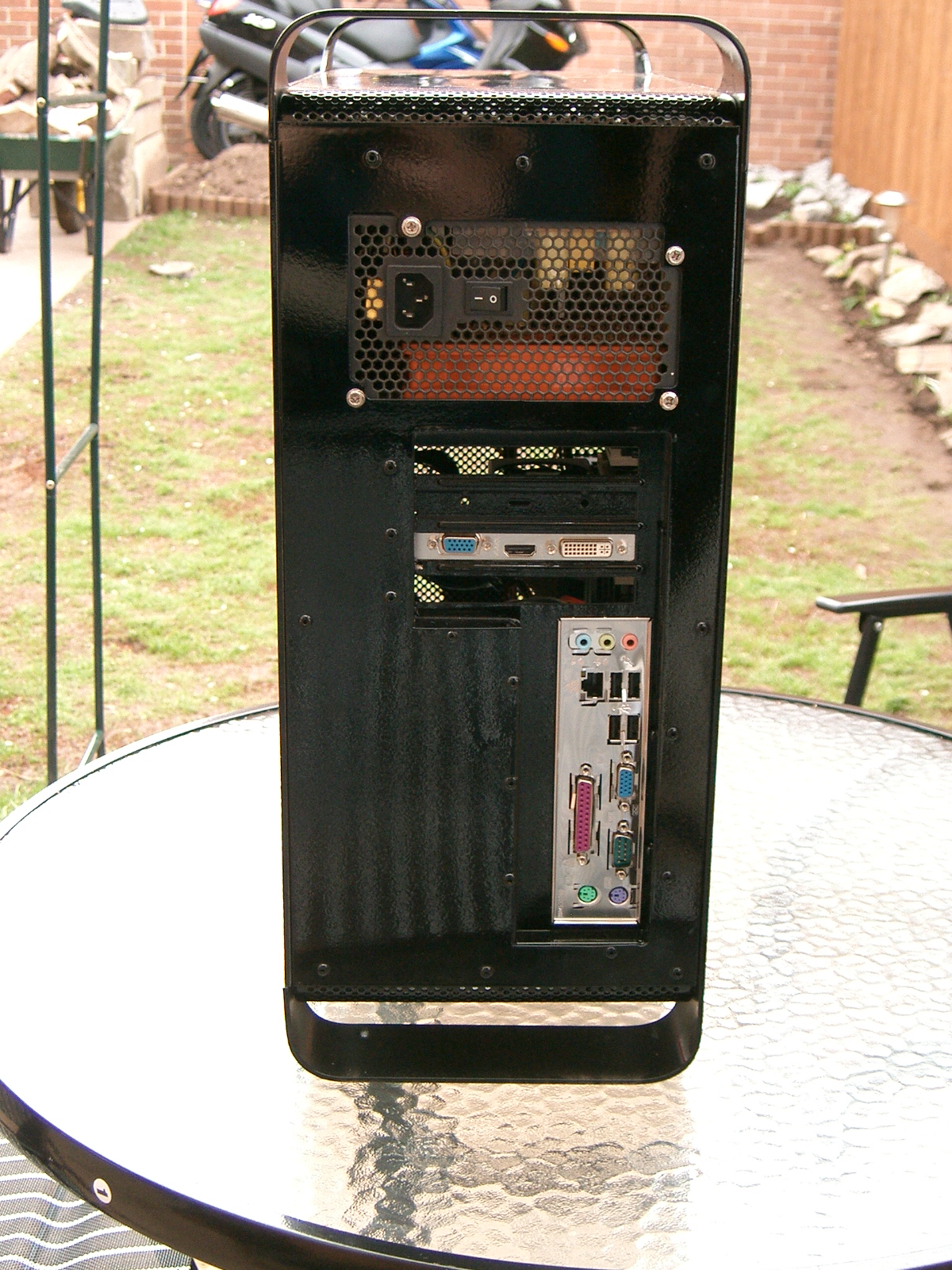

my mac mod
intel e5300 2.6gig chip overclocked to 3.4gig.
runs cool ,around 32degs with just the psu as cooling.
have run it at 4.2gig but it got in the high 50's.
runs leopard at lightning speed.
backpanel has had the 2 missing panes filled with black panels.
inside has been cable tied since these photoes were taken.
had to lose the door handle to fit in the psu.two small contersunk screws in the top corners
hold the door on .
