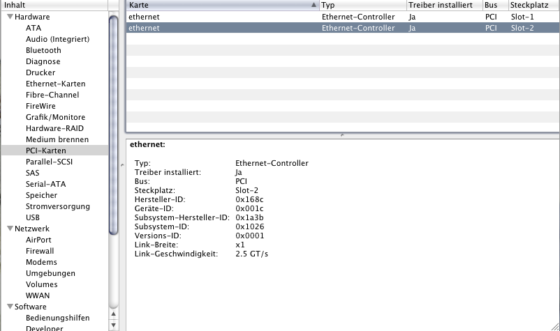

Giuly Posted October 26, 2009 Share Posted October 26, 2009 Hi, I have an AR5006EG 802.11 b/g Wireless PCI Express Adapter, Dev-ID: 168c:001c That Dev-ID is in the 64Bit-Driver already, so I didn't do anything to it. But it shows up (And showed up before) as a Ethernet-Card. No Airport-Icon, I can't figure out why. The drivers are loaded on boot, but they get unloaded, as they are not needed, because no suitable device found, I guess. Any Idea? Link to comment Share on other sites More sharing options...

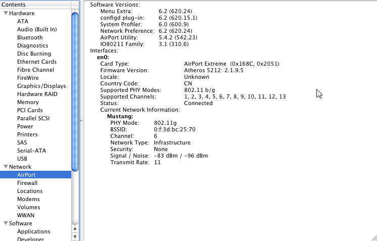

Mustang Sally Posted January 14, 2010 Share Posted January 14, 2010 my tp link tl-wn651g pci card is working in sl 64 using the AtherosFix.kext on a vanilla install on a p5q pro with all updates, one hard drive with win 7 and snow. I couldn't connect when i just had leo installed on the drive so i installed win 7 64 on the spare partition and after settingup and exiting windows, i booted into the snow partition and now i had wifi. installed all the software updates and rebooted. lost the wifi again. booted back into win 7, took a bit before the wifi connected, exited and rebooted in to snow again and had wifi again. it will only work if i boot into win 7 first and the card gets initialized then connects every time and decent speed. Updates.tiff Link to comment Share on other sites More sharing options...
