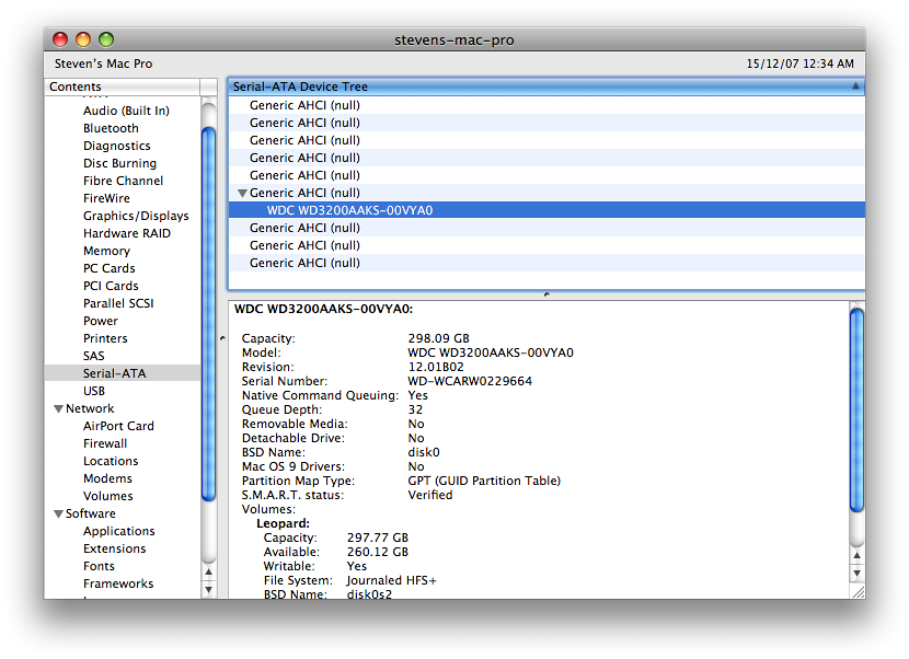

weaksauce12 Posted December 15, 2007 Share Posted December 15, 2007 BJMoose, I've got everything working but the second Marvell SATA controller. Any tips? I've tried disabling/re-enabling it, turning on HPET, switching to ACPI and then to IDE, and playing with the Marvell config. I've had no luck so far. What do you suggest? Link to comment Share on other sites More sharing options...
cipherworld Posted December 15, 2007 Share Posted December 15, 2007 So is this means I have all 8 SATA channels? Mine is on EFI v8 and Vanilla kernel. Link to comment Share on other sites More sharing options...
BJMoose Posted December 15, 2007 Author Share Posted December 15, 2007 BJMoose, I've got everything working but the second Marvell SATA controller. Any tips? I've tried disabling/re-enabling it, turning on HPET, switching to ACPI and then to IDE, and playing with the Marvell config. I've had no luck so far. What do you suggest? I can't imagine what could be wrong here if they once worked and now they don't. Is it possible you are using a flat image that someone else created on a system that's different from yours? Even if that, when booting, the os should still detect the other controller. Is your controller set to AHCI in the bios? I don't know if that is absolutely necessary, because I think back in the earlier days I had osx installed in IDE mode, but I know that everything works on my system now in AHCI mode. I've updated to the latest bios, but the last 3 also worked for me. BTW, Paragon's latest NTFS software does a great job of allowing both read and write to NTFS drives. No need to mess around with NTFS-3G. And it only costs $29USD...a very minimal fee for the job it does. That combined with MacDrive on the windows side gives complete system flexibility. Link to comment Share on other sites More sharing options...

BJMoose Posted December 24, 2007 Author Share Posted December 24, 2007 "attempted" 8 times in 2 hours, not necessarily completed Q1: kalyways "/backup" directory -- is that contents of original osx or kexts s/he has placed there? Q2: anyone have their marvell SATA ports showing up in profiler? Q3: is intel SATA hotplug? is marvell SATA hotplug? -> want to be safe when hotswapping my eSata drive thanks all. Q1 = Yes Q2 = If I have the marvell (my windows setup) drives turned on, they show up. Q3 = I'm not at my hack right now and don't usually have my windows drives on in OSX mode. But SATA drives are hot pluggable on the ICH7 controller. You want to make sure you unmount/eject the entire disk (not just one volume) before pulling it out. When you insert the next disk it mounts up right away. You run the risk of corrupting data (on a real mac too) if you don't unmount before pulling a disk. Link to comment Share on other sites More sharing options...
