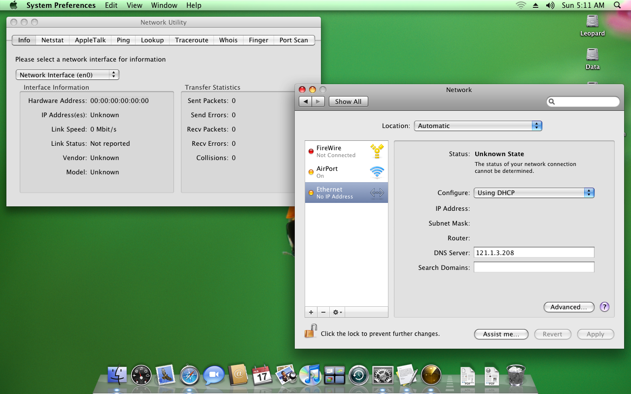

Philintosh Posted February 16, 2008 Share Posted February 16, 2008 I am so happy to see that my bcm5787 is finally recognized by my iatkos 10.5.2 (using the hexedit on 37336) but then it doesnt have an internet connection even i set to dhcp or manually and it has no mac address (so maybe it is the reason why cant have internet connection) please if anyone knows how to set this please share some ideas. would be so thankful...thank you Link to comment Share on other sites More sharing options...

mavvert Posted March 29, 2008 Share Posted March 29, 2008 i'd try to load the kext manually after your system has booted. The kext loads fine for me, and gives me an en0 with 00:00:00.. mac. Setting the mac address with ifconfig gives Network down. Bringing the interface up with ifconfig en0 up gives: AppleBCM5751Ethernet: 0 0 resetAdapter - FTQ initialization failed AppleBCM5751Ethernet: 0 0 wakeUp - reset adapter failed AppleBCM5751Ethernet: 0 0 enable - failed BCM5787M - 14e4:169b Link to comment Share on other sites More sharing options...

collit99 Posted April 10, 2008 Share Posted April 10, 2008 My BCM5787(1693) is working partially, I used these following kexts. PCCard.10.5.2.Beta2.pkg.zip AppleBCM5751Ethernet.kext.zip This is on Kalyway 10.5.1 update to 10.5.2 Installed PCCard.10.5.2.beta2 package by Eqaute first, reboot and Installed AppleBCM5751Ethernet by nobb1x using kext helper. MAC is still zeros here are the results.... When connected to a Router, it can obtain IP automatically i can browse for couple of minutes, I was so excited seeing it working until BAM! my hack freezes! need to hold the power button of my ACER Aspire 4310 for 5 to 10 sec to power it off. When connected to a Windows DC(2003) it can't get any IP(need to choose DCHP with Manual IP) tried to browse thru our Proxy Server, I can surf but after a 1 minute or two it won't work(browser will not display webpages). but i'm happy cause it's working(40%?), it's a good start. if only I can figured-out why it's freezing/Hanging.... Thanks to Equate and nobb1x. Link to comment Share on other sites More sharing options...

sgarbesi Posted April 23, 2008 Share Posted April 23, 2008 Okay well after looking more into the issue, it's undoubtedly the Mac Address. As soon as I attempt to set the Mac Address via Terminal (sudo -s; (password); ifconfig en0 ether (my mac address)) the system immediately locks up and freezes. So my guess is that after a few seconds of having internet connectivity, the network attempts to set a mac address, which then in turn causes the crash to occur. I looked at my logs (system, ect..) and really didn't notice any errors at the time of the crash, but before I did notice a bunch of speed step errors, which could be somehow related. Anyway if I ever figure this out I'll let you guys know, I'm still trying to figure out a way to set this mac address so that when the system reboot it will automatically have the mac set, and hopefully will allow the internet to work. Link to comment Share on other sites More sharing options...
