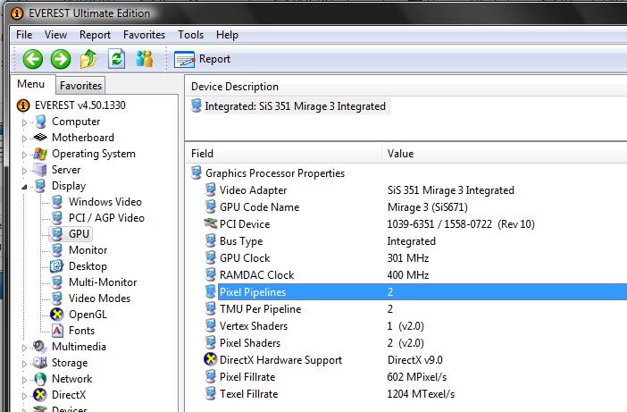

nguzun Posted November 1, 2008 Share Posted November 1, 2008 hello, can anyone help me with my sis mirage 3 video? this is the information ?? thanks en advance !!! Link to comment Share on other sites More sharing options...
Beerkex'd Posted November 1, 2008 Share Posted November 1, 2008 You're asking in the wrong place. Go here: http://forum.insanelymac.com/index.php?showforum=151 Link to comment Share on other sites More sharing options...
