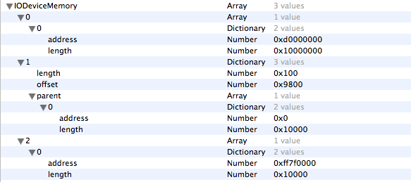

My values (hexadecimal):
AGP bus RS300
ATI Radeon 9000IGP with shared memory 128Mb=0x08000000.
RAM=1Gb=0x40000000
So VRAM address=0x38000000
But in ioreg I see IODeviceMemory for video=0xd0000000. (Shifting?)
I set aperture size to half of VRAM=64Mb=0x04000000.
My best (working) aperture address is occur 0x38000000+0x04000000=0x3c000000.

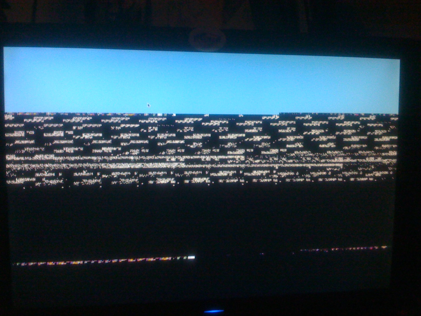

128 mb Hangs at the blue screen with d0000000 as the agp base
May 27 06:10:55 -imac-2 kernel[0]: AGP: Found an AGP 3.0 compliant device.

|   "AGP_Master" = <>
there is no agp_master
|   "AAPL,vram-memory" = <000000e000000010>
Not sure what this values is equal to in ram is it 256 mb ? .... the card has 512mb
| +-o ATIR600GLContext  <class ATIR600GLContext, !registered, !matched, active, busy 0, retain 5>
ATIR600GLContext also empty. I need someone with a imac that has the HD 2400 card in it to do an ioreg for me to compare.
Below is the picture of the 128mb aperture hang.
Now with tis ati card I am able to remove any agp base from the info plist and set it to 0
I will get different values for agp base depending on what agp aprturre size I select. It seems when I set the Aperture to
32 mb only software acceleration for gfx.
so does it hang b/c it has proper agp gart and accel ? I have no idea :(
AGP_Base might not be equal to VRAM. So d0000000 is a bad value.

|   "AGP_Master" = <>
All is good. I check same values with my compN1 (in signature).
Really strange about 256 or 512Mb. It is probably writen in gfx-string because System and Apple's drivers don't write a value "AAPL,vram-memory".
AGP_Master is empty because it is needed only as present or not. System profiler show us "AGP" if it is present.
Picture looks like that I have with wrong AGP_Base.

7) New ATIRadeon9700* from 10.4.11 , Callisto003 and AGPGart266 (AGP_Base?)->
0xd8000000, 0xe8000000 -> display stops with kexts infos and no blue/GUI and probable crash
0xf8000000 -> same:no GUI and very long disk activity then probable crash
8) ATIRadeon9700* from 10.4.11 , Callisto003 and AGPGart266 + Modifyed ATIRadeon9700GA.plugin (usefull to keep CallistoFB with AGPGart) -> GUI back - No CI/QE

About Video Memory Size shown in System Profiler. There are values in Radeon Registers (148, F8 and 108) and in IORegistry (IODeviceMemory, VRAM,memsize, VRAM,totalsize, AAPL,vram-memory and etc). AFAIK System Profiler uses VRAM,totalsize. Not sure.
IONDRV uses
	prop = OSDynamicCast( OSData, nub->getProperty("AAPL,vram-memory"));
if (prop && (prop->getLength() >= (2 * sizeof(IOByteCount))))
	IOByteCount * lengths;
	lengths = (IOByteCount *) prop->getBytesNoCopy();
	length = lengths[1];
	vramBase = lengths[0];
else
	vramBase = physicalFramebuffer;
	prop = OSDynamicCast( OSData, nub->getProperty("VRAM,memsize"));
But ATIRadeon9700.kext uses registers 148 for framebuffer and F8 for openGL.
Abrakadabra.
