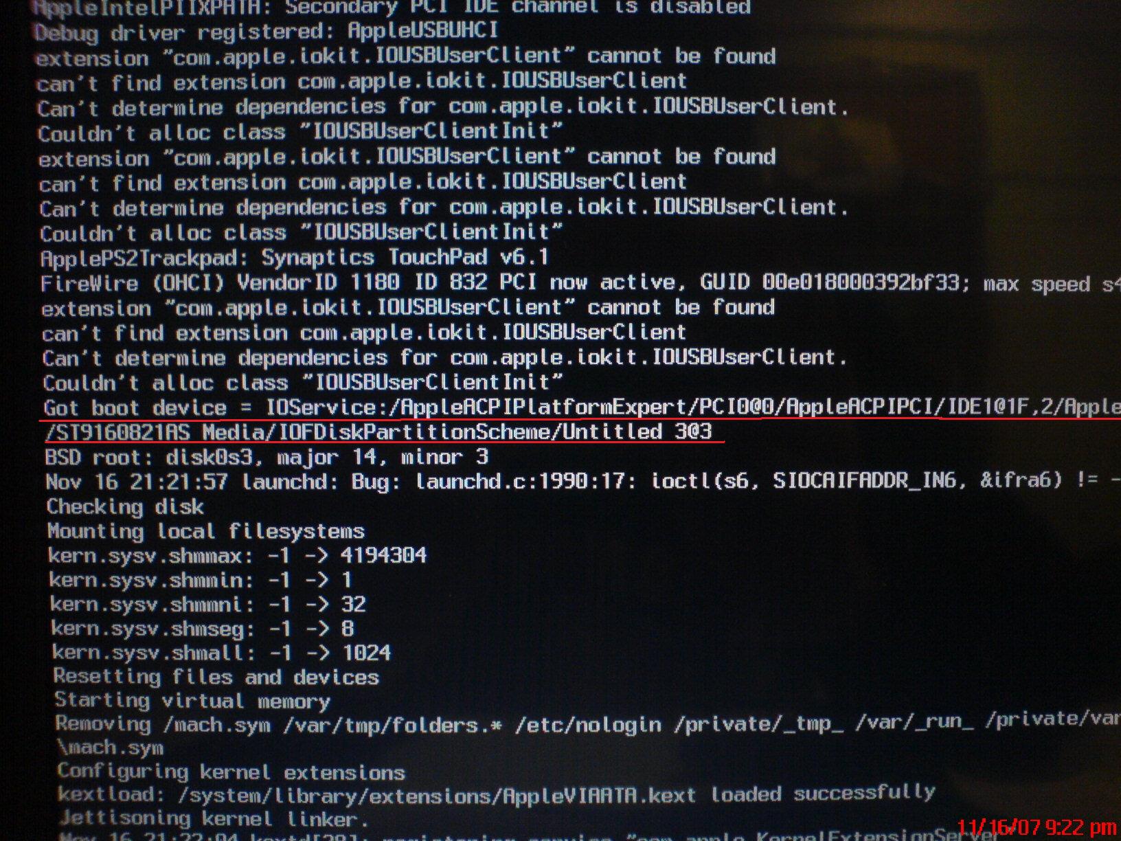

ciufs Posted November 18, 2007 Share Posted November 18, 2007 i write this line.... first command doesn't work.. the second one work correctly... then i reboot so when the pc has reboot from HD, it tell me after some lines... "still waiting for root device" how can i fix it ? PS: ho rebootato dopo da DVD e con il solito rd=disk0s1 sono entrato sul sistema, ho riparato i permessi da disco utility e rebottato ma mi da ancora la stessa cosa. Link to comment Share on other sites More sharing options...
antaholics Posted November 18, 2007 Author Share Posted November 18, 2007 i write this line.... first command doesn't work.. the second one work correctly... then i reboot so when the pc has reboot from HD, it tell me after some lines... "still waiting for root device" how can i fix it ? PS: ho rebootato dopo da DVD e con il solito rd=disk0s1 sono entrato sul sistema, ho riparato i permessi da disco utility e rebottato ma mi da ancora la stessa cosa. I'm stuck on the same place too with my F3SV ... "still waiting for root device" I'm trying the kexts from the DVD, but I am not quite sure which ones to remove (removing the ATI kexts wasn't enough)... I tried adding only the ones I thought might help, and it didn't work. I'm going to try doing that again later on... the problem is the Extensions.mkext on the DVD contains so many kexts that my computer doesn't need but it's making the EXtensions folder on my computer too big. @AlexIT, when I upgrade to 10.4.11 would all the kexts be replaced (problem solved?) Ant Link to comment Share on other sites More sharing options...

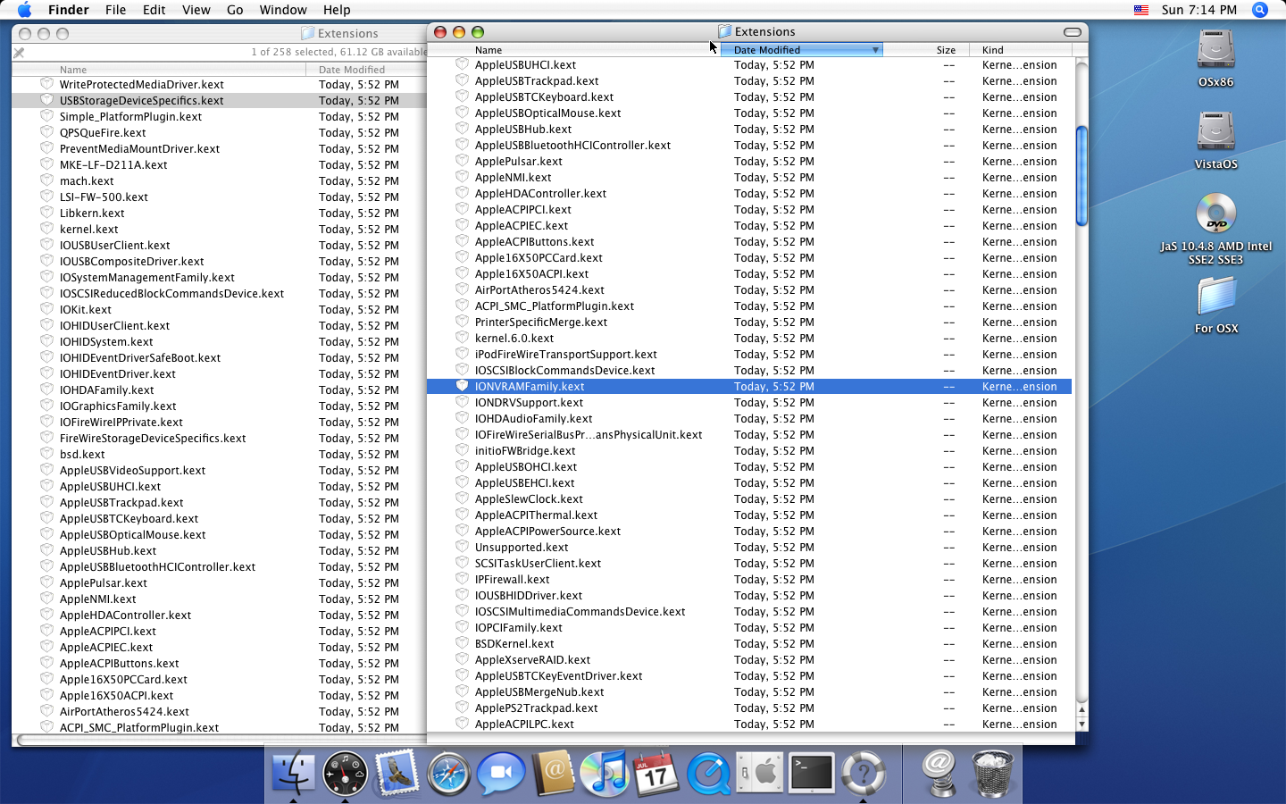

antaholics Posted November 19, 2007 Author Share Posted November 19, 2007 I HAVE GOOD NEWS FOR EVERYONE STUCK AT "Still Waiting for root device"!!!!!! In terminal, I became root (sudo -s) and I copied Extensions.mkext from /System/Library/Extensions.mkext in the DVD to my Extensions folder and then extracted the mkext file into the folder cp -fR /Volumes/"JaS 10.4.8 AMD Intel SSE2 SSE3"/System/Library/Extensions.mkext cd /System/Library/Extensions mkextunpack -d . ./Extensions.mkext I ended up with about 350 .kext files in the folder, whereas I had about 250 before. I tried "makemkext" but it gave me "archive would be too large; abort" or something like that... so I had to remove some unnecessary extensions. The next step was REALLY terrible. I went through the extensions folder and randomly removed extensions (this is probably really bad, I backed up my extensions folder just in case) that looked like they wouldn't affect my system, and kept trying makemkext. until finally, it would let me make my mkext file. Terribly, I had to delete almost 100 extensions, and I ended up with 258 extensions before I could make my new mkext file. rm -fR /System/Library/Extensions/[name of extension.kext] hint: for removing many extensions beginning with the same letters, you can use something like this: rm -fR /System/Library/Extensions/ATI* so all of the extensions starting with ATI would be deleted. After cutting it down to 258 kext files, I ran makemkext and then rebooted, and it worked! Attached is all the extensions that was placed into the extensions folder (I sorted the files by date created so that I can identify the ones I put in with mkextunpack) As you can see, the process took just under an hour and a half to complete... which was, as I said, terrible, because I couldn't identify which extensions were needed and which ones weren't, and which one(s) allows the HD to boot by itself. @AlexIT, If you can, please have a look through these files to see if you can identify the ones that possibly lead to the hard drive working.. so that in the future it makes things easier for everyone experiencing this problem. I don't know enough about what each extension does to do that I hope I didn't remove anything that I still need lol... but in case that happened I still have all the original install extensions backed up. Thanks AlexIT! Ant P.S. this is a picture I took earlier of the booting process, with the line where the HD is identified underlined in red. I can't tell which extension(s) were needed, maybe someone else can? Update: I think I probably deleted a kext needed for my USB stick.. because when I started OSX with my USB stick in the USB drive it hangs at "using 10485 buffer..." (I was scared to death) and when I took it out it would boot.. Link to comment Share on other sites More sharing options...
AlexIT Posted November 19, 2007 Share Posted November 19, 2007 In terminal, I became root (sudo -s) and I copied Extensions.mkext from /System/Library/Extensions.mkext in the DVD to my Extensions folder and then extracted the mkext file into the foldercp -fR /Volumes/"JaS 10.4.8 AMD Intel SSE2 SSE3"/System/Library/Extensions.mkext cd /System/Library/Extensions mkextunpack -d . ./Extensions.mkext I's not a good final method , because you are duplicationg some extensions.Id you extract it in /MKEXT and compare with the one in /System/Extensions you can notice that some of them (in the latest folder) are nestest (in pluginf folders inside some kexte)! I did this method the first time, and noticed that the only it was enough to put ACPI and APIC kext.Some kexts could give problems with some (non original) kernels, that's AppleCPUIntel* *Thermo* *HWsensor*You would try the moveaway-method (don't delete them, move 10 a time to another folder) after replacedonly ACPI and APIC as I told you before. When the system starts move them back (4 at time in the same order).When it hang again, move away (1 at a time) tha latest moved-back.So you can identify alle the "bad" kexts.ATI extensions can be removed with no problems if you have a NVIDIA vga.P.S. this is a picture I took earlier of the booting process, with the line where the HD is identified underlined in red. I can't tell which extension(s) were needed, maybe someone else can?Update:I think I probably deleted a kext needed for my USB stick.. because when I started OSX with my USB stick in the USB drive it hangs at "using 10485 buffer..." (I was scared to death) and when I took it out it would boot.. You are not use the sata driver , but the generic IDE one. The support for USB2 is very buggy in 10.4.8 (timig problems), there are some updates, but if you upgrade to 10.4.11 they should be included.Just tried to install Leopard by using the flat image. From my Tiger installation I replaced the ACPI and APIC kext's, but the boot also hangs at the 'still waiting for root device' phase, just like Tiger..Post a picture of your boot screen (full). Link to comment Share on other sites More sharing options...
antaholics Posted November 19, 2007 Author Share Posted November 19, 2007 I's not a good final method , because you are duplicationg some extensions.Id you extract it in /MKEXT and compare with the one in /System/Extensions you can notice that some of them (in the latest folder) are nestest (in pluginf folders inside some kexte)! I did this method the first time, and noticed that the only it was enough to put ACPI and APIC kext.Some kexts could give problems with some (non original) kernels, that's AppleCPUIntel* *Thermo* *HWsensor*You would try the moveaway-method (don't delete them, move 10 a time to another folder) after replacedonly ACPI and APIC as I told you before. When the system starts move them back (4 at time in the same order).When it hang again, move away (1 at a time) tha latest moved-back.So you can identify alle the "bad" kexts.ATI extensions can be removed with no problems if you have a NVIDIA vga. Sorry, can you please explain this in more detail? I'm not really sure what you mean in the removal method. I thought it's a missing kext causing the HD to not work?? Also, what do you mean by some of the kexts are nestest in plugin folders? Doesn't the system simply replace the extensions if they're duplicate? You are not use the sata driver , but the generic IDE one. Is there a reason that OSX is using the IDE driver for my SATA hard drive? Is there any difference? Which file is responsible for the IDE driver? Thanks, Ant Link to comment Share on other sites More sharing options...
AlexIT Posted November 19, 2007 Share Posted November 19, 2007 I'm not really sure what you mean in the removal method. I thought it's a missing kext causing the HD to not work?? Also, what do you mean by some of the kexts are nestest in plugin folders? Doesn't the system simply replace the extensions if they're duplicate? Some kexts are nested, that's are plugins of other kexts, but when extracted from then mkext they are seen as single kext. Here is the list of my nested kexts Apple02Audio.kext/Contents/PlugIns/Apple02DBDMAAudio.kext Apple02Audio.kext/Contents/PlugIns/AppleBurgundyAudio.kext Apple02Audio.kext/Contents/PlugIns/AppleDACAAudio.kext Apple02Audio.kext/Contents/PlugIns/AppleScreamerAudio.kext Apple02Audio.kext/Contents/PlugIns/AppleTexas2Audio.kext Apple02Audio.kext/Contents/PlugIns/AppleTexasAudio.kext Apple02Audio.kext/Contents/PlugIns/AudioI2SControl.kext Apple16X50Serial.kext/Contents/PlugIns/Apple16X50ACPI.kext Apple16X50Serial.kext/Contents/PlugIns/Apple16X50PCCard.kext AppleACPIPlatform.kext/Contents/PlugIns/AppleACPIButtons.kext AppleACPIPlatform.kext/Contents/PlugIns/AppleACPIEC.kext AppleACPIPlatform.kext/Contents/PlugIns/AppleACPIPCI.kext AppleACPIPlatform.kext/Contents/PlugIns/AppleACPIPowerSource.kext AppleACPIPlatform.kext/Contents/PlugIns/AppleACPIThermal.kext AppleAirPort.kext/Contents/PlugIns/AppleAirPortFW.kext AppleAirPort.kext/Contents/PlugIns/AppleAirPortFWAP.kext AppleAzaliaAudio.kext/Contents/PlugIns/AppleAzaliaController.kext AppleAzaliaAudio.kext/Contents/PlugIns/IOHDAudioFamily.kext AppleEFIRuntime.kext/Contents/PlugIns/AppleEFINVRAM.kext AppleHWClock.kext/Contents/PlugIns/AppleCPUVoltage.kext AppleHWClock.kext/Contents/PlugIns/AppleEMacClock.kext AppleHWClock.kext/Contents/PlugIns/ApplePulsar.kext AppleHWClock.kext/Contents/PlugIns/AppleSlewClock.kext AppleI2SModemFamily.kext/Contents/PlugIns/AppleModemOnHoldService.kext AppleOnboardAudio.kext/Contents/PlugIns/AppleDBDMAAudio.kext AppleOnboardAudio.kext/Contents/PlugIns/AppleIOI2CAudioCodec.kext AppleOnboardAudio.kext/Contents/PlugIns/AppleOnyxAudio.kext AppleOnboardAudio.kext/Contents/PlugIns/AppleTAS3004Audio.kext AppleOnboardAudio.kext/Contents/PlugIns/AppleToonieAudio.kext AppleOnboardAudio.kext/Contents/PlugIns/AppleTopazAudio.kext ApplePS2Controller.kext/Contents/PlugIns/ApplePS2Keyboard.kext ApplePS2Controller.kext/Contents/PlugIns/ApplePS2Mouse.kext ApplePS2Controller.kext/Contents/PlugIns/ApplePS2Trackpad.kext AppleStorageDrivers.kext/Contents/PlugIns/AppleATAPIStorage.kext AppleStorageDrivers.kext/Contents/PlugIns/AppleHollywood.kext AppleStorageDrivers.kext/Contents/PlugIns/AppleMemorexCDROMDriver.kext AppleStorageDrivers.kext/Contents/PlugIns/AppleXserveRAID.kext AppleStorageDrivers.kext/Contents/PlugIns/CanonEOS1D.kext AppleStorageDrivers.kext/Contents/PlugIns/FireWireStorageDeviceSpecifics.kext AppleStorageDrivers.kext/Contents/PlugIns/FWPreferredProtocolSpeed.kext AppleStorageDrivers.kext/Contents/PlugIns/initioFWBridge.kext AppleStorageDrivers.kext/Contents/PlugIns/IOFireWireSerialBusProtocolSansPhysicalUnit.kext AppleStorageDrivers.kext/Contents/PlugIns/LSI-FW-500.kext AppleStorageDrivers.kext/Contents/PlugIns/MKE-LF-D211A.kext AppleStorageDrivers.kext/Contents/PlugIns/MKE-SR-8171.kext AppleStorageDrivers.kext/Contents/PlugIns/OxfordSemiconductor.kext AppleStorageDrivers.kext/Contents/PlugIns/PioneerSuperDrive.kext AppleStorageDrivers.kext/Contents/PlugIns/PreventMediaMountDriver.kext AppleStorageDrivers.kext/Contents/PlugIns/QPSQueFire.kext AppleStorageDrivers.kext/Contents/PlugIns/SanyoIDShot.kext AppleStorageDrivers.kext/Contents/PlugIns/SonyXDCAMDriver.kext AppleStorageDrivers.kext/Contents/PlugIns/StorageLynx.kext AppleStorageDrivers.kext/Contents/PlugIns/USBStorageDeviceSpecifics.kext AppleStorageDrivers.kext/Contents/PlugIns/WriteProtectedMediaDriver.kext AppleUSBTopCase.kext/Contents/PlugIns/AppleUSBTCKeyboard.kext AppleUSBTopCase.kext/Contents/PlugIns/AppleUSBTCKeyEventDriver.kext AppleUSBTopCase.kext/Contents/PlugIns/AppleUSBTrackpad.kext IO80211Family.kext/Contents/PlugIns/AirPortAtheros.kext IO80211Family.kext/Contents/PlugIns/AirPortAtheros5424.kext IO80211Family.kext/Contents/PlugIns/AirPortEnabler.kext IO80211Family.kext/Contents/PlugIns/AppleAirPortBrcm4311.kext IOAHCIFamily.kext/Contents/PlugIns/IOAHCIBlockStorage.kext IOAHCIFamily.kext/Contents/PlugIns/IOAHCISerialATAPI.kext IOATAFamily.kext/Contents/PlugIns/AppleGenericPCATA.kext IOATAFamily.kext/Contents/PlugIns/AppleIntelPIIXATA.kext IOATAFamily.kext/Contents/PlugIns/AppleNForceATA.kext IOATAFamily.kext/Contents/PlugIns/AppleOnboardPCATA.kext IOATAFamily.kext/Contents/PlugIns/AppleVIAATA.kext IOATAFamily.kext/Contents/PlugIns/IOATABlockStorage.kext IOATAFamily.kext/Contents/PlugIns/IOATAPIProtocolTransport.kext IOBluetoothFamily.kext/Contents/PlugIns/AppleUSBBluetoothHCIController.kext IOBluetoothFamily.kext/Contents/PlugIns/BroadcomUSBBluetoothFirmwareDownload.kext IOBluetoothFamily.kext/Contents/PlugIns/BroadcomUSBBluetoothHCIController.kext IOBluetoothFamily.kext/Contents/PlugIns/CSRHIDTransitionDriver.kext IOBluetoothFamily.kext/Contents/PlugIns/CSRUSBBluetoothHCIController.kext IOBluetoothFamily.kext/Contents/PlugIns/IOBluetoothBNEPDriver.kext IOBluetoothFamily.kext/Contents/PlugIns/IOBluetoothSCOAudioDriver.kext IOBluetoothFamily.kext/Contents/PlugIns/IOBluetoothSerialManager.kext IOFireWireFamily.kext/Contents/PlugIns/AppleFWOHCI.kext IOFireWireFamily.kext/Contents/PlugIns/AppleLynx.kext IOFireWireIP.kext/Contents/PlugIns/IOFireWireIPPrivate.kext IOHIDFamily.kext/Contents/PlugIns/IOHIDEventDriver.kext IOHIDFamily.kext/Contents/PlugIns/IOHIDEventDriverSafeBoot.kext IOHIDFamily.kext/Contents/PlugIns/IOHIDSystem.kext IOHIDFamily.kext/Contents/PlugIns/IOHIDUserClient.kext IONetworkingFamily.kext/Contents/PlugIns/Apple3Com3C90x.kext IONetworkingFamily.kext/Contents/PlugIns/Apple_DEC21x4Ethernet.kext IONetworkingFamily.kext/Contents/PlugIns/AppleBCM440XEthernet.kext IONetworkingFamily.kext/Contents/PlugIns/AppleBCM5701Ethernet.kext IONetworkingFamily.kext/Contents/PlugIns/AppleBMacEthernet.kext IONetworkingFamily.kext/Contents/PlugIns/AppleDP83816Ethernet.kext IONetworkingFamily.kext/Contents/PlugIns/AppleGMACEthernet.kext IONetworkingFamily.kext/Contents/PlugIns/AppleIntel8254XEthernet.kext IONetworkingFamily.kext/Contents/PlugIns/AppleIntel8255x.kext IONetworkingFamily.kext/Contents/PlugIns/AppleRTL8139Ethernet.kext IONetworkingFamily.kext/Contents/PlugIns/AppleRTL8169Ethernet.kext IONetworkingFamily.kext/Contents/PlugIns/AppleYukon.kext IONetworkingFamily.kext/Contents/PlugIns/AppleYukon2.kext IOPlatformPluginFamily.kext/Contents/PlugIns/ACPI_SMC_PlatformPlugin.kext IOPlatformPluginFamily.kext/Contents/PlugIns/PBG4_PlatformPlugin.kext IOPlatformPluginFamily.kext/Contents/PlugIns/PBG4_ThermalProfile.kext IOPlatformPluginFamily.kext/Contents/PlugIns/PowerMac11_2_PlatformPlugin.kext IOPlatformPluginFamily.kext/Contents/PlugIns/PowerMac11_2_ThermalProfile.kext IOPlatformPluginFamily.kext/Contents/PlugIns/PowerMac12_1_PlatformPlugin.kext IOPlatformPluginFamily.kext/Contents/PlugIns/PowerMac12_1_ThermalProfile.kext IOPlatformPluginFamily.kext/Contents/PlugIns/PowerMac7_2_PlatformPlugin.kext IOPlatformPluginFamily.kext/Contents/PlugIns/PowerMac8_1_ThermalProfile.kext IOPlatformPluginFamily.kext/Contents/PlugIns/PowerMac9_1_ThermalProfile.kext IOPlatformPluginFamily.kext/Contents/PlugIns/RackMac3_1_PlatformPlugin.kext IOPlatformPluginFamily.kext/Contents/PlugIns/Simple_PlatformPlugin.kext IOPlatformPluginFamily.kext/Contents/PlugIns/SMU_Neo2_PlatformPlugin.kext IOSCSIArchitectureModelFamily.kext/Contents/PlugIns/IOSCSIBlockCommandsDevice.kext IOSCSIArchitectureModelFamily.kext/Contents/PlugIns/IOSCSIMultimediaCommandsDevice.kext IOSCSIArchitectureModelFamily.kext/Contents/PlugIns/IOSCSIReducedBlockCommandsDevice.kext IOSCSIArchitectureModelFamily.kext/Contents/PlugIns/SCSITaskUserClient.kext IOSCSIParallelFamily.kext/Contents/PlugIns/IOSCSIFamily.kext IOSerialFamily.kext/Contents/PlugIns/AppleRS574Serial.kext IOSerialFamily.kext/Contents/PlugIns/AppleSCCIrDA.kext IOSerialFamily.kext/Contents/PlugIns/AppleSCCSerial.kext IOSerialFamily.kext/Contents/PlugIns/AppleUSBIrDA.kext IOSerialFamily.kext/Contents/PlugIns/AppleVerizonSupport.kext IOSerialFamily.kext/Contents/PlugIns/AppleVerizonSupportKicker.kext IOSerialFamily.kext/Contents/PlugIns/AppleWWANSupport.kext IOSerialFamily.kext/Contents/PlugIns/AppleWWANSupport1.kext IOSerialFamily.kext/Contents/PlugIns/AppleWWANSupport2.kext IOSerialFamily.kext/Contents/PlugIns/DCPModemSupport.kext IOSerialFamily.kext/Contents/PlugIns/InternalModemSupport.kext IOSerialFamily.kext/Contents/PlugIns/InternalUSBModem.kext IOSerialFamily.kext/Contents/PlugIns/MotorolaSM56K.kext IOSerialFamily.kext/Contents/PlugIns/MotorolaSM56KUSB.kext IOUSBFamily.kext/Contents/PlugIns/AppleUSBCDC.kext IOUSBFamily.kext/Contents/PlugIns/AppleUSBCDCACMControl.kext IOUSBFamily.kext/Contents/PlugIns/AppleUSBCDCACMData.kext IOUSBFamily.kext/Contents/PlugIns/AppleUSBCDCDMM.kext IOUSBFamily.kext/Contents/PlugIns/AppleUSBCDCECMControl.kext IOUSBFamily.kext/Contents/PlugIns/AppleUSBCDCECMData.kext IOUSBFamily.kext/Contents/PlugIns/AppleUSBCDCEEM.kext IOUSBFamily.kext/Contents/PlugIns/AppleUSBCDCWCM.kext IOUSBFamily.kext/Contents/PlugIns/AppleUSBEHCI.kext IOUSBFamily.kext/Contents/PlugIns/AppleUSBHub.kext IOUSBFamily.kext/Contents/PlugIns/AppleUSBMergeNub.kext IOUSBFamily.kext/Contents/PlugIns/AppleUSBOHCI.kext IOUSBFamily.kext/Contents/PlugIns/AppleUSBOpticalMouse.kext IOUSBFamily.kext/Contents/PlugIns/AppleUSBUHCI.kext IOUSBFamily.kext/Contents/PlugIns/AppleUSBVideoSupport.kext IOUSBFamily.kext/Contents/PlugIns/IOUSBCompositeDriver.kext IOUSBFamily.kext/Contents/PlugIns/IOUSBHIDDriver.kext IOUSBFamily.kext/Contents/PlugIns/IOUSBHIDDriverSafeBoot.kext IOUSBFamily.kext/Contents/PlugIns/IOUSBUserClient.kext SM56KUSBAudioFamily.kext/Contents/PlugIns/AppleSM56KUSBAudio.kext SM56KUSBAudioFamily.kext/Contents/PlugIns/AppleSM56KUSBModemFamily.kext System.kext/PlugIns/AppleNMI.kext System.kext/PlugIns/ApplePlatformFamily.kext System.kext/PlugIns/BSDKernel.kext System.kext/PlugIns/BSDKernel6.0.kext System.kext/PlugIns/IOKit.kext System.kext/PlugIns/IOKit6.0.kext System.kext/PlugIns/IONVRAMFamily.kext System.kext/PlugIns/IOSystemManagement.kext System.kext/PlugIns/Libkern.kext System.kext/PlugIns/Libkern6.0.kext System.kext/PlugIns/Mach.kext System.kext/PlugIns/Mach6.0.kext System.kext/PlugIns/System6.0.kext System.kext/PlugIns/Unsupported.kext iPodDriver.kext/Contents/PlugIns/iPodFireWireTransportSupport.kext iPodDriver.kext/Contents/PlugIns/iPodSBCDriver.kext So when you put the extracted ones, they are duplicated, with different versions, and you cannot know which are really loaded! I try to give a pseudo-code for what i mean removal-method Extract dvd Extensions (to /KEXT) Remove ATI* AppleIntel* (they are for intel vgas) *Therm* *sensor* Replace ACPI and APIC stuff with with extracted ones Copy this new Extensions folder to /BACKUP Do a makemkext and reboot. REPEAT Remove first 10 kexts makemkext && reboot if BOOT IS STILL KO restore just removed kexts UNTIL BOOT IS OK FOR EACH KEXT IN REMOVED ONE Restored a removed kext makemkext && reboot if BOOT IS KO then move the restored kext from BACKUP to a BADLIST folder Is there a reason that OSX is using the IDE driver for my SATA hard drive? Is there any difference? Which file is responsible for the IDE driver? Maybe you could have some options in your bios about the sata/ide mode. To use the sata driver your bios mast be set as SATA or AHCI or ENHANCED ... not in compatibilty mode, I mean. The kexts responsable for ide/ata/sata support are IOAHCIFamily.kext/Contents/PlugIns/IOAHCIBlockStorage.kext IOAHCIFamily.kext/Contents/PlugIns/IOAHCISerialATAPI.kext IOATAFamily.kext/Contents/PlugIns/AppleGenericPCATA.kext IOATAFamily.kext/Contents/PlugIns/AppleIntelPIIXATA.kext IOATAFamily.kext/Contents/PlugIns/AppleNForceATA.kext IOATAFamily.kext/Contents/PlugIns/AppleOnboardPCATA.kext IOATAFamily.kext/Contents/PlugIns/AppleVIAATA.kext IOATAFamily.kext/Contents/PlugIns/IOATABlockStorage.kext IOATAFamily.kext/Contents/PlugIns/IOATAPIProtocolTransport.kext To try to avoid the "Still waiting" problem you could remove them (that's , only 2 kexts) and get those kexts from extracted one (that's , 9 kexts) before trying the removal-method Link to comment Share on other sites More sharing options...

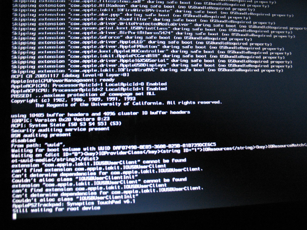

Alguno Posted November 19, 2007 Share Posted November 19, 2007 Unfortunately I don't have a digital camera at hand, so I'll copy paste the last few lines here: MAC Framework successfully initialized using 5242 buffer headers and 4096 cluster IO buffer headers IOAPIC: Version 0x20 Vectors 0:23 ACPI: System State [S0 S3 S4 S5] (S3) mbinit: done Security auditing service present BSM auditing presentFrom path: "uuid", Waiting for boot volume with UUID A0F06784-EA7E-3D36-B4EE-AA4CF31D3A23 Waiting on <dict ID="0"><key>IOProviderClass</key><string ID="1">IOResources</string><key>IOResourceMatch</key><string ID="2"">boot-uuid-media</string></dict> Still waiting for root device... There aren't any messages from extensions shown on the screen I've just tried replacing the IOAHCIFamily and IOATAFamiliy extensions with those from the JaS 10.4.8 DVD, but the sata drive still isn't detected. Changing the SATA-mode in the BIOS (enhanced/compatible) doesn't change anything. When booting in Tiger and using diskutil to show the available UUID's, the one from Leopard (A0F06...) is shown on the partition where I've installed the flat image. Booting Leopard with rd=disk0s1 also results in the 'still waiting for root device' message Link to comment Share on other sites More sharing options...
AlexIT Posted November 19, 2007 Share Posted November 19, 2007 There aren't any messages from extensions shown on the screenI've just tried replacing the IOAHCIFamily and IOATAFamiliy extensions with those from the JaS 10.4.8 DVD, but the sata drive still isn't detected. It seems you are not booting with flags -x and MKextCache. It seems you have not used my makemkext utils. Link to comment Share on other sites More sharing options...
