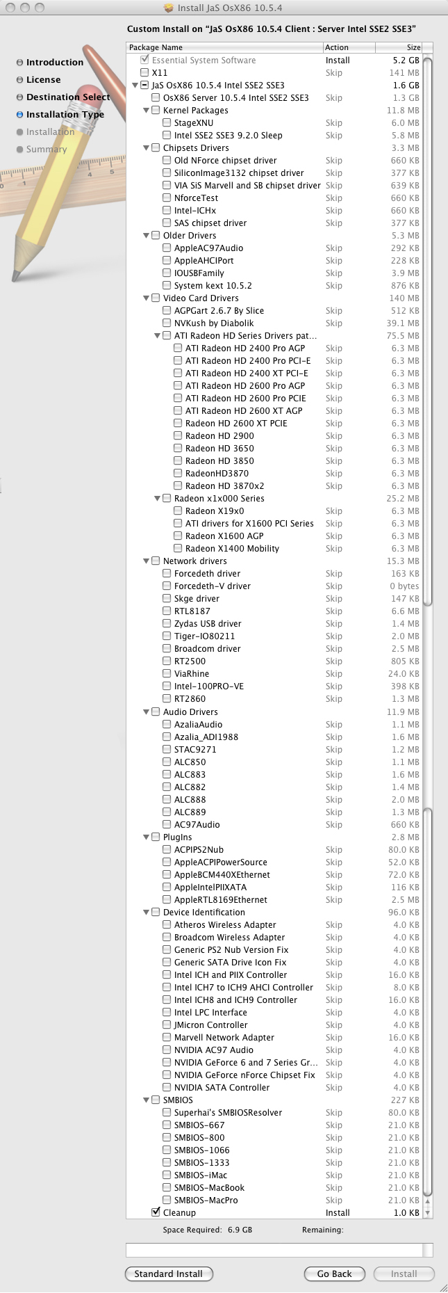

Im using last BIOS,
I Tried the new Bootloader 132, we can install RETAIL Leopard DVD
read the tread in the news,
afer the combo mega update via internet...YES WE CAN! :rolleyes:
IF WE USE AHCI SATA we can fix the IOHCIFamily.kext simply by add some lines,
under:
extension=IOAHCIFamily
plugin=IOAHCIBlockStorage
matchstring=IOAHCIDevice
ADD THIS:
<key>Physical Interconnect</key>
<string>SATA</string>
<key>Physical Interconnect Location</key>
<string>Internal</string>
<key>Protocol Characteristics</key>
<dict>
</dict>
I must say "thnx to kalyway and iNDi" for this,
Boot works also in USB pen drive but just after the first install... so dont use it at first time.
WE miss to install the audio, but we can always put those kext who arent working out o f the box, inside the extra kext folder for keep the extensions folder like a real mac.
All is working fine, sleep, TM, and more...

time to update this tread with all you need and make clear some things
ISO FOR USE TO INSTALL THE RETAIL LEOPARD DVD 10.5 + UPDATE YOUR LEO to 10.5.4 from internet using the apple software update tool without any problem:
http://www.mediafire.com/?gmwgcwrvjgg
PAY ATTENTION MAYBE YOU MUST PUT IN YOUR BIOS UNDER CPU CONFIGURATION THE MAX CPU VALUE LIMIT to [DISABLED] and then ENABLE it after the successfull Leopard install (under verify)
ISOS TO USE AS BOOTLOADER 132 AFTER THE 10.5.4 UPDATE:
07/12/2008:
Added HDAenabler (thnx to Kabyl), IOAHCIfamily, IOnetworkingfamily, Chun-nan PS2/USB kexts for mause and keyboard, JMicronATA and more...
http://rapidshare.co...BURNME.iso.html
22/07/2008
Another version with the SMBIOSResolver.kext (SDRAM memory bug but wrks fine in all) THNX to SUPERHAI (www.superhai.com), it works with original applesmbios FROM 10.5.2 and up
http://www.mediafire.com/?6j9wcsxszlz
With those isos you can install the retail leopard, run it and keep your extensions folder like the original macs computers, thnx to GALAXY for his work "the ramdisk is dammn fast", thnx to the others for this fantastic bootloader ( def, kabyl, zef, bumby and all the chameleon gang!)
After the first update for e.g. from 10.5 to 10.5.4 (YES NOW U CAN!!) simply reboot and use the other iso.
After the 10.5.x update you will lost the QE on video card... reinstall it, be carefull to delete the old drivers before reintall, reinstall repair permission.
AUdio package installer for asus p5w dh deluxe : http://rapidshare.co...O.mpkg.zip.html
BIOS SETUP ver.2704
IN MAIN MENU:
-IDE in AHCI mode, ALPE and ASP Disabled
MENU ADVANCED, CPU CONFIGURATION
-MODIFY RATIO SUPPORT [DISABLED]
-MICROCODE UPDATION [ENABLED]
-MAX CPU VALUE LIMIT [ENABLED]
-EXECUTE DISABLED FUNCTION [ENABLED]
-ENHANCED C1 CONTROL [AUTO]
-VIRTUALIZATION TECHNOLY [ENABLED]
-INTEL SPEEDSTEP TECHNOLOGY [DISABLED]
MENU ADVANCED, CHIPSET MENU
-MEMORY REMAP FUTURE [ENABLED]
MENU POWER-SUSPEND MODE [S3 ONLY]
-RESPOST VIDEO ON S3 RESUME [YES]
-ACPI 2.0 SUPPORT [YES]
-ACPI APIC SUPPORT [YES]
MENU POWER, APM CONFIGURATION
Set the ps2 keyboard to awake from sleep with your pref button like space bar, CTRL esc etc... make your choice i used SPACE BAR
-Power on by ps2 mouse [ENABLED]
22/07/2008 BOOT FROM HARD DISK!!
ONLY AFTER THE RETAIL INSTALL USING THE FIRST CD BOOTLOADER....
FROM KALYWAY:
Download link : Chameleon_DFE_for_Hard_Disk.zip --->http://tinyurl.com/6je4eh
1 - Copy the contents of your "Extra" folder to "Extra Contents" directory link !!!
2- then run Chameleon_DFE_for_Hard_Disk.pkg and install it to your hard disk !!!
your are done ! now no need to use dfe 132 cd to boot your hd !!
enjoy!!
by kalyway !
COPY FROM THE CDBOOT ONLY THE MKEXT FILE ON THE INITRD:IMG (mount it)
IT WORKS FINE
About the kexts, SMBIOSresolver has a bug, for a moment not show the right memory setup, Superhai will make the nfo.plist editable for put it the correct value.
