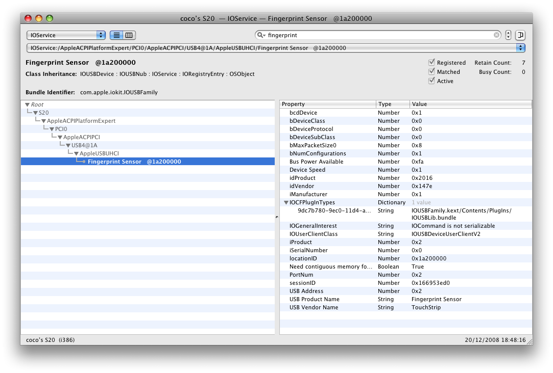

coconup Posted December 20, 2008 Share Posted December 20, 2008 it keeps on saying cannot find fingerprint sensor here... on the console I get this message 20/12/2008 17:22:31 /Applications/Protector Suite/Protector Suite.app/Contents/MacOS/Protector Suite[194] E:a01e1fa0: 0.024: ...rj/UpekDriver/llusb.c: 307: UsbOpenDeviceByName(DeviceName, DevData->ExclusiveMode, DevData->UsbDeviceName, sizeof(DevData->UsbDeviceName), DeviceNotification, DevData, &DevData->UsbNotification, &DevData->UsbDevice) failed! Returned: -2448 I think the program just looks for the device on the wrong usb, can you post your usb specs where the fingerprint is plugged in under system profiler? the error comes from this file library/applicationsupport/upek/drivers/llusb Link to comment Share on other sites More sharing options...

coconup Posted December 20, 2008 Share Posted December 20, 2008 mm it's quite exactly like mine... the usb bus is the same but I don't have location ID, any ideas?! USB Bus: Host Controller Location: Built In USB Host Controller Driver: AppleUSBUHCI PCI Device ID: 0x2834 PCI Revision ID: 0x0003 PCI Vendor ID: 0x8086 Bus Number: 0x1a Fingerprint Sensor: Version: 0.01 Bus Power (mA): 500 Speed: Up to 12 Mb/sec Manufacturer: TouchStrip Product ID: 0x2016 Vendor ID: 0x147e btw under registry explorer I have fingerprint sensor @ 1a200000 Link to comment Share on other sites More sharing options...

coconup Posted January 10, 2009 Share Posted January 10, 2009 maybe my problem is related to USB, in fact there's no location ID in system profiler for the fingerprint sensor... even with slice's latest usb 2.0 drivers nothing changes Link to comment Share on other sites More sharing options...
uszu Posted January 30, 2009 Share Posted January 30, 2009 I have same problem. My device is supported but unrecognized by Protection Suite. It is recognized by the system. It is 10.5.6. USB Bus: Host Controller Location: Built In USB Host Controller Driver: AppleUSBUHCI PCI Device ID: 0x2834 PCI Revision ID: 0x0003 PCI Vendor ID: 0x8086 Bus Number: 0x1a Fingerprint Sensor: Product ID: 0x2016 Vendor ID: 0x147e Version: 0.01 Speed: Up to 12 Mb/sec Manufacturer: TouchStrip Location ID: 0x1a200000 Current Available (mA): 500 Current Required (mA): 100 This is the log file in debug mode: Jan 30 12:11:44 r61 ./Protector Suite[727]: D:00b55720: 0.011: .../prj/UpekDriver/usb.c:1198: <- UsbInit() Jan 30 12:11:44 r61 ./Protector Suite[727]: D:00b55720: 0.011: ...rj/UpekDriver/llusb.c: 985: <- LlDriverInit() returns: 0 Jan 30 12:11:44 r61 ./Protector Suite[727]: D:00b55720: 0.012: ...rj/UpekDriver/llusb.c: 237: -> LlUsbOpenConnection(0x631ec00, 0x6345688, 0x634563c) Jan 30 12:11:44 r61 ./Protector Suite[727]: D:00b55720: 0.012: ...rj/UpekDriver/llusb.c: 111: -> InitDevData(0xbfffc048) Jan 30 12:11:44 r61 ./Protector Suite[727]: D:00b55720: 0.013: ...rj/UpekDriver/llusb.c: 124: <- InitDevData() returns: 0 Jan 30 12:11:44 r61 ./Protector Suite[727]: D:00b55720: 0.013: .../prj/UpekDriver/usb.c: 464: -> UsbOpenDeviceByName(nonexisting, 1, 0x681ae4c, 1024, 0x656477e, 0x681ae00, 0x681ae10, 0x681ae08) Jan 30 12:11:44 r61 ./Protector Suite[727]: D:00b55720: 0.014: .../prj/UpekDriver/usb.c: 239: -> GetDevice(0x526b, 0xbfffbf9c) Jan 30 12:11:44 r61 ./Protector Suite[727]: D:00b55720: 0.015: .../prj/UpekDriver/usb.c: 257: <- GetDevice() returns: 0 Jan 30 12:11:44 r61 ./Protector Suite[727]: D:00b55720: 0.015: .../prj/UpekDriver/usb.c: 953: -> UsbGetDeviceIds(0x6343610, 0xbfffbfae, 0xbfffbfac, 0xbfffbfaa) Jan 30 12:11:44 r61 ./Protector Suite[727]: D:00b55720: 0.016: .../prj/UpekDriver/usb.c: 970: <- UsbGetDeviceIds() returns: 0 Jan 30 12:11:44 r61 ./Protector Suite[727]: D:00b55720: 0.017: .../prj/UpekDriver/usb.c: 239: -> GetDevice(0x536f, 0xbfffbf9c) Jan 30 12:11:44 r61 ./Protector Suite[727]: D:00b55720: 0.018: .../prj/UpekDriver/usb.c: 257: <- GetDevice() returns: 0 Jan 30 12:11:44 r61 ./Protector Suite[727]: D:00b55720: 0.018: .../prj/UpekDriver/usb.c: 953: -> UsbGetDeviceIds(0x6343610, 0xbfffbfae, 0xbfffbfac, 0xbfffbfaa) Jan 30 12:11:44 r61 ./Protector Suite[727]: D:00b55720: 0.018: .../prj/UpekDriver/usb.c: 970: <- UsbGetDeviceIds() returns: 0 Jan 30 12:11:44 r61 ./Protector Suite[727]: D:00b55720: 0.020: .../prj/UpekDriver/usb.c: 239: -> GetDevice(0x5273, 0xbfffbf9c) Jan 30 12:11:44 r61 ./Protector Suite[727]: D:00b55720: 0.021: .../prj/UpekDriver/usb.c: 257: <- GetDevice() returns: 0 Jan 30 12:11:44 r61 ./Protector Suite[727]: D:00b55720: 0.021: .../prj/UpekDriver/usb.c: 953: -> UsbGetDeviceIds(0x6343610, 0xbfffbfae, 0xbfffbfac, 0xbfffbfaa) Jan 30 12:11:44 r61 ./Protector Suite[727]: D:00b55720: 0.021: .../prj/UpekDriver/usb.c: 970: <- UsbGetDeviceIds() returns: 0 Jan 30 12:11:44 r61 ./Protector Suite[727]: D:00b55720: 0.023: .../prj/UpekDriver/usb.c: 239: -> GetDevice(0x5377, 0xbfffbf9c) Jan 30 12:11:44 r61 ./Protector Suite[727]: D:00b55720: 0.023: .../prj/UpekDriver/usb.c: 257: <- GetDevice() returns: 0 Jan 30 12:11:44 r61 ./Protector Suite[727]: D:00b55720: 0.023: .../prj/UpekDriver/usb.c: 953: -> UsbGetDeviceIds(0x6343610, 0xbfffbfae, 0xbfffbfac, 0xbfffbfaa) Jan 30 12:11:44 r61 ./Protector Suite[727]: D:00b55720: 0.024: .../prj/UpekDriver/usb.c: 970: <- UsbGetDeviceIds() returns: 0 Jan 30 12:11:44 r61 ./Protector Suite[727]: D:00b55720: 0.025: .../prj/UpekDriver/usb.c: 239: -> GetDevice(0x527b, 0xbfffbf9c) Jan 30 12:11:44 r61 ./Protector Suite[727]: D:00b55720: 0.026: .../prj/UpekDriver/usb.c: 257: <- GetDevice() returns: 0 Jan 30 12:11:44 r61 ./Protector Suite[727]: D:00b55720: 0.028: .../prj/UpekDriver/usb.c: 953: -> UsbGetDeviceIds(0x6343610, 0xbfffbfae, 0xbfffbfac, 0xbfffbfaa) Jan 30 12:11:44 r61 ./Protector Suite[727]: D:00b55720: 0.028: .../prj/UpekDriver/usb.c: 970: <- UsbGetDeviceIds() returns: 0 Jan 30 12:11:44 r61 ./Protector Suite[727]: D:00b55720: 0.030: .../prj/UpekDriver/usb.c: 239: -> GetDevice(0x537f, 0xbfffbf9c) Jan 30 12:11:44 r61 ./Protector Suite[727]: D:00b55720: 0.030: .../prj/UpekDriver/usb.c: 257: <- GetDevice() returns: 0 Jan 30 12:11:44 r61 ./Protector Suite[727]: D:00b55720: 0.031: .../prj/UpekDriver/usb.c: 953: -> UsbGetDeviceIds(0x6343610, 0xbfffbfae, 0xbfffbfac, 0xbfffbfaa) Jan 30 12:11:44 r61 ./Protector Suite[727]: D:00b55720: 0.031: .../prj/UpekDriver/usb.c: 970: <- UsbGetDeviceIds() returns: 0 Jan 30 12:11:44 r61 ./Protector Suite[727]: D:00b55720: 0.032: .../prj/UpekDriver/usb.c: 239: -> GetDevice(0x5283, 0xbfffbf9c) Jan 30 12:11:44 r61 ./Protector Suite[727]: D:00b55720: 0.033: .../prj/UpekDriver/usb.c: 257: <- GetDevice() returns: 0 Jan 30 12:11:44 r61 ./Protector Suite[727]: D:00b55720: 0.033: .../prj/UpekDriver/usb.c: 953: -> UsbGetDeviceIds(0x6343610, 0xbfffbfae, 0xbfffbfac, 0xbfffbfaa) Jan 30 12:11:44 r61 ./Protector Suite[727]: D:00b55720: 0.033: .../prj/UpekDriver/usb.c: 970: <- UsbGetDeviceIds() returns: 0 Jan 30 12:11:44 r61 ./Protector Suite[727]: D:00b55720: 0.035: .../prj/UpekDriver/usb.c: 239: -> GetDevice(0x5387, 0xbfffbf9c) Jan 30 12:11:44 r61 ./Protector Suite[727]: D:00b55720: 0.036: .../prj/UpekDriver/usb.c: 257: <- GetDevice() returns: 0 Jan 30 12:11:44 r61 ./Protector Suite[727]: D:00b55720: 0.036: .../prj/UpekDriver/usb.c: 953: -> UsbGetDeviceIds(0x6343610, 0xbfffbfae, 0xbfffbfac, 0xbfffbfaa) Jan 30 12:11:44 r61 ./Protector Suite[727]: D:00b55720: 0.037: .../prj/UpekDriver/usb.c: 970: <- UsbGetDeviceIds() returns: 0 Jan 30 12:11:44 r61 ./Protector Suite[727]: D:00b55720: 0.038: .../prj/UpekDriver/usb.c: 239: -> GetDevice(0x528b, 0xbfffbf9c) Jan 30 12:11:44 r61 ./Protector Suite[727]: D:00b55720: 0.039: .../prj/UpekDriver/usb.c: 257: <- GetDevice() returns: 0 Jan 30 12:11:44 r61 ./Protector Suite[727]: D:00b55720: 0.039: .../prj/UpekDriver/usb.c: 953: -> UsbGetDeviceIds(0x6343610, 0xbfffbfae, 0xbfffbfac, 0xbfffbfaa) Jan 30 12:11:44 r61 ./Protector Suite[727]: D:00b55720: 0.039: .../prj/UpekDriver/usb.c: 970: <- UsbGetDeviceIds() returns: 0 Jan 30 12:11:44 r61 ./Protector Suite[727]: D:00b55720: 0.041: .../prj/UpekDriver/usb.c: 239: -> GetDevice(0x538f, 0xbfffbf9c) Jan 30 12:11:44 r61 ./Protector Suite[727]: D:00b55720: 0.041: .../prj/UpekDriver/usb.c: 257: <- GetDevice() returns: 0 Jan 30 12:11:44 r61 ./Protector Suite[727]: D:00b55720: 0.042: .../prj/UpekDriver/usb.c: 953: -> UsbGetDeviceIds(0x6343610, 0xbfffbfae, 0xbfffbfac, 0xbfffbfaa) Jan 30 12:11:44 r61 ./Protector Suite[727]: D:00b55720: 0.042: .../prj/UpekDriver/usb.c: 970: <- UsbGetDeviceIds() returns: 0 Jan 30 12:11:44 r61 ./Protector Suite[727]: D:00b55720: 0.043: .../prj/UpekDriver/usb.c: 532: <- UsbOpenDeviceByName() returns: -2448 Jan 30 12:11:44 r61 ./Protector Suite[727]: E:00b55720: 0.043: ...rj/UpekDriver/llusb.c: 307: UsbOpenDeviceByName(DeviceName, DevData->ExclusiveMode, DevData->UsbDeviceName, sizeof(DevData->UsbDeviceName), DeviceNotification, DevData, &DevData->UsbNotification, &DevData->UsbDevice) failed! Returned: -2448 Jan 30 12:11:44 r61 ./Protector Suite[727]: D:00b55720: 0.043: ...rj/UpekDriver/llusb.c: 132: -> DestroyDevData(0x681ae00) Jan 30 12:11:44 r61 ./Protector Suite[727]: D:00b55720: 0.044: ...rj/UpekDriver/llusb.c: 153: <- DestroyDevData() Jan 30 12:11:44 r61 ./Protector Suite[727]: D:00b55720: 0.044: ...rj/UpekDriver/llusb.c: 398: <- LlUsbOpenConnection() returns: -2448 Jan 30 12:11:44 r61 ./Protector Suite[727]: D:00b55720: 0.044: ...rj/UpekDriver/llusb.c: 991: -> LlDriverTerminate() Jan 30 12:11:44 r61 ./Protector Suite[727]: D:00b55720: 0.044: .../prj/UpekDriver/usb.c:1204: -> UsbTerminate() Jan 30 12:11:44 r61 ./Protector Suite[727]: D:b00a1000: 0.045: .../prj/UpekDriver/usb.c:1168: <- NotifyThread() Jan 30 12:11:44 r61 ./Protector Suite[727]: D:00b55720: 0.046: .../prj/UpekDriver/usb.c:1223: <- UsbTerminate() Jan 30 12:11:44 r61 ./Protector Suite[727]: D:00b55720: 0.046: ...rj/UpekDriver/llusb.c: 995: <- LlDriverTerminate() However earlier in the log it seems to find the right device: Protector Suite[484]: D:00b55720: 0.023: .../prj/UpekDriver/usb.c: 239: -> GetDevice(0x4813, 0xbfffba90) Protector Suite[484]: D:00b55720: 0.023: .../prj/UpekDriver/usb.c: 257: <- GetDevice() returns: 0 Protector Suite[484]: D:00b55720: 0.023: .../prj/UpekDriver/usb.c: 953: -> UsbGetDeviceIds(0x6315230, 0xbfffba0e, 0xbfffba0c, 0xbfffba0a) Protector Suite[484]: D:00b55720: 0.023: .../prj/UpekDriver/usb.c: 970: <- UsbGetDeviceIds() returns: 0 Protector Suite[484]: T:00b55720: 0.023: .../prj/UpekDriver/usb.c: 335: Expected device VID 0x147e, PID 0x2016 found Protector Suite[484]: D:00b55720: 0.024: .../prj/UpekDriver/usb.c: 953: -> UsbGetDeviceIds(0x6315230, 0xbfffba9e, 0xbfffba9c, 0xbfffba9a) Protector Suite[484]: D:00b55720: 0.024: .../prj/UpekDriver/usb.c: 970: <- UsbGetDeviceIds() returns: 0 Protector Suite[484]: D:00b55720: 0.024: .../prj/UpekDriver/usb.c: 183: -> GetDeviceType(0x147e, 0x2016, 0x1) Protector Suite[484]: D:00b55720: 0.024: .../prj/UpekDriver/usb.c: 229: <- GetDeviceType() returns: 0x304 <TCS >= TCS4B> Debug mode may be set in /Library/Application\ Support/Upek/Drivers/llusb.bundle/Contents/Info.plist Maybe someone with working sensor could post his debug log for comparision. Attached full log. fingerprint.txt Link to comment Share on other sites More sharing options...
